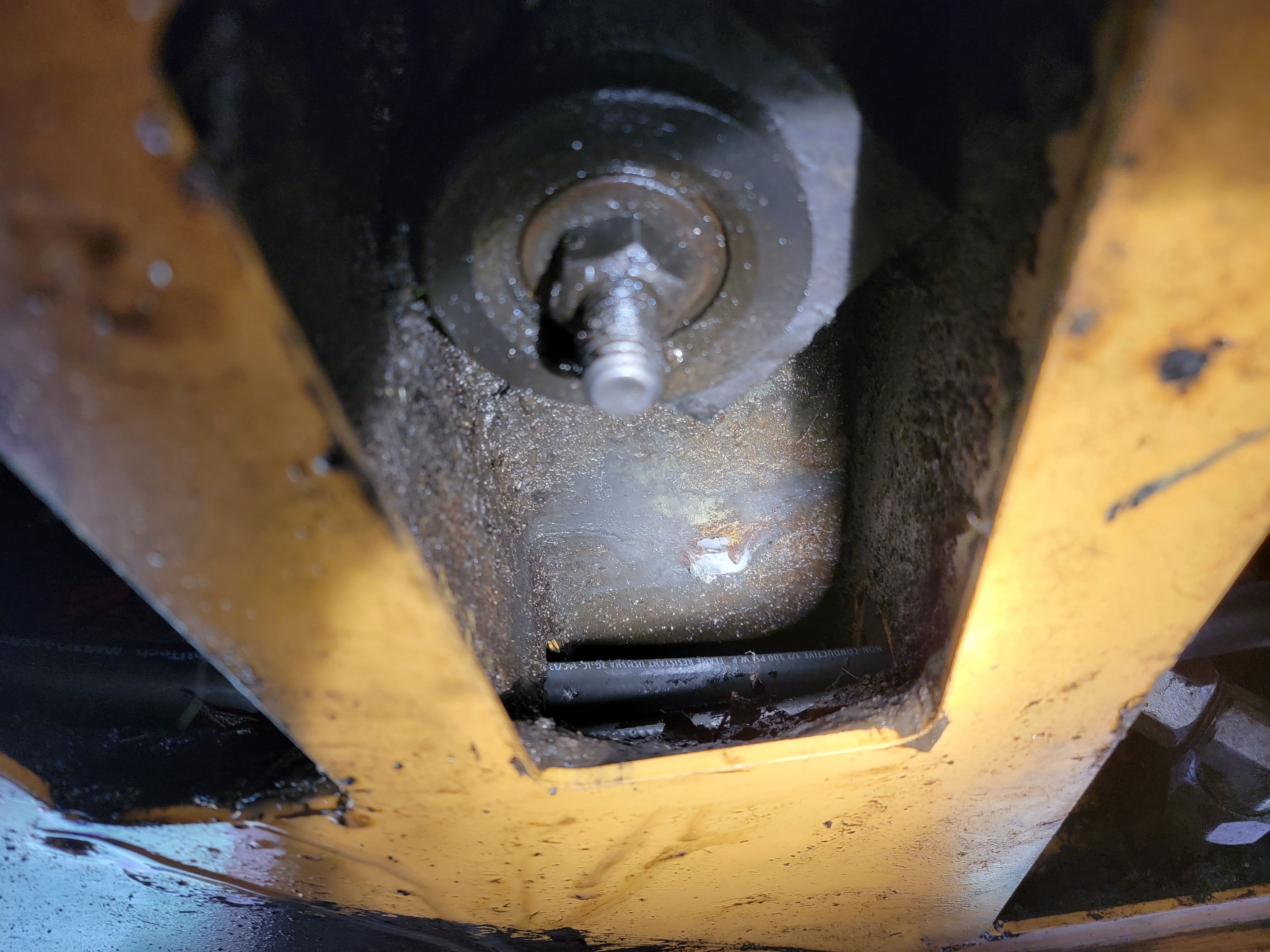

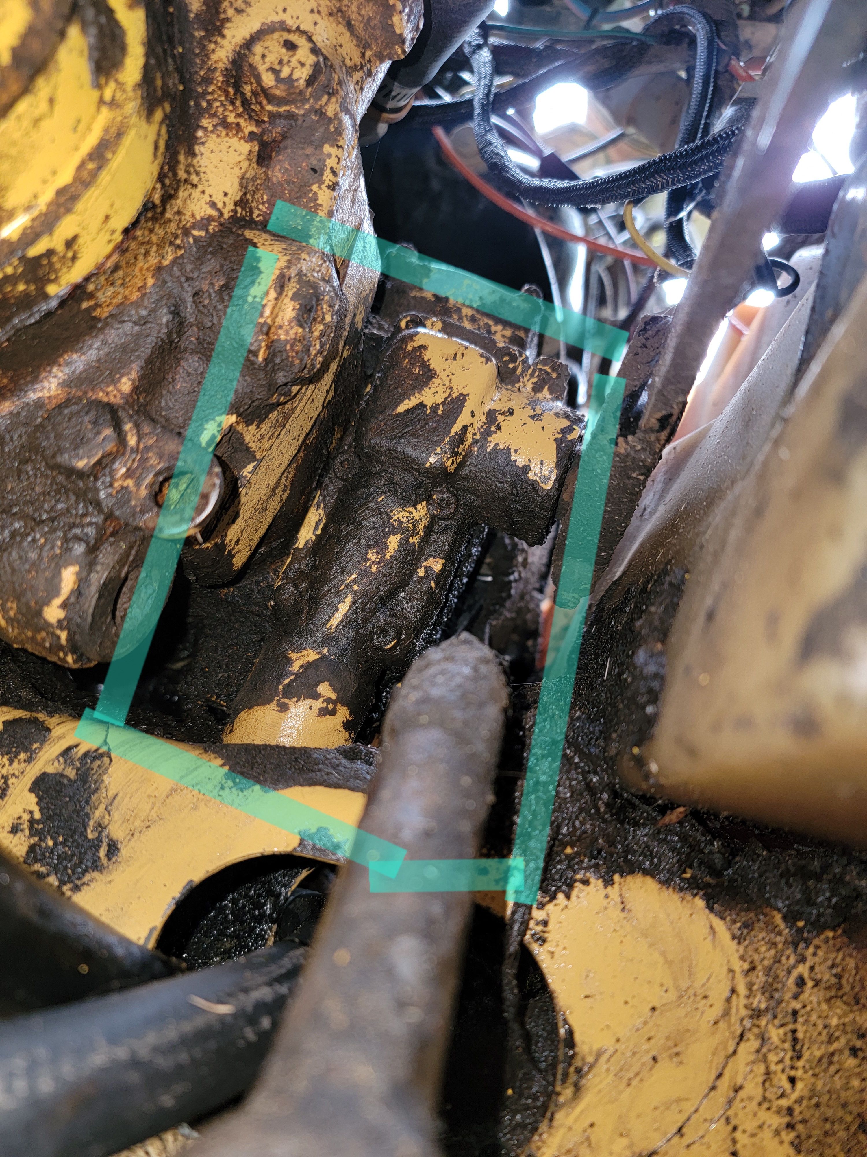

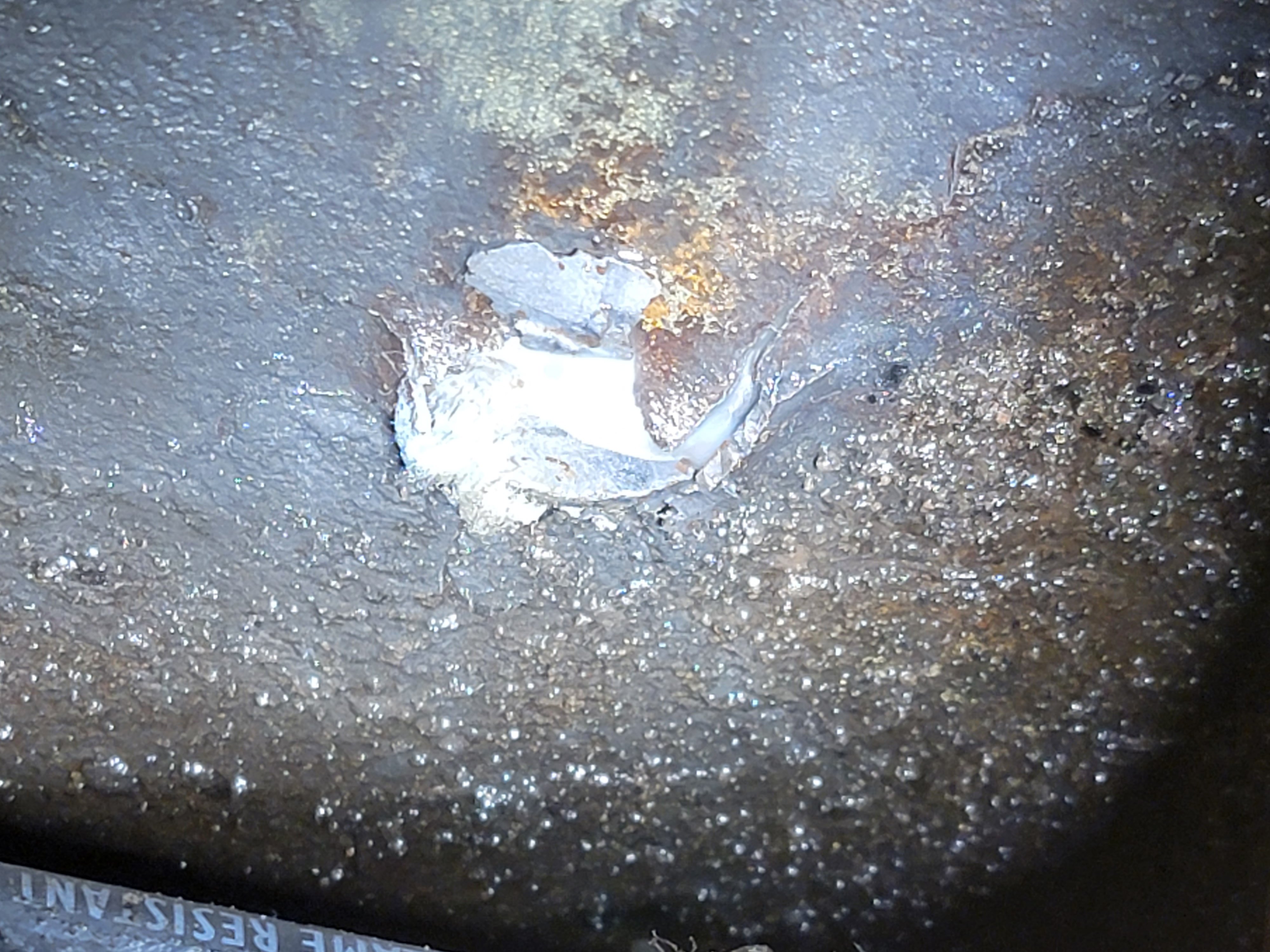

Ok guys! I have an update. I got all the return hoses and the suction hose made and put on today. No leaks there! But! The leak I seen prior which I added a picture at the start of this post. So what seems to be leaking is on the bottom side of what ever the big pump to the right looking under the seat has a thing on the right side of it that the control lever hooks to that seem to pushed thru the bottom of the frame and I believe that's where the leak is coming from. I noticed oil around the transmission dip stick in the center but oil level is good. Controls and movements is very slow. Here's some pictures. Thank you guys for all your help.
