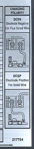

I have welded MIG a lot with machines that were already setup , and only had to change the spool of wire and the bottle , but I bought my first Lincoln Mig Welder that burns shielded and unshielded and I am in the process of setting it up for aluminum , the manuel , the web site and the disc that came along with it all leave me guessing which way to set the polarity for either type of welding as it states the machine is shipped in one configuation but appears to be in the other, I am thinking flux core (unshielded) work clamp is attached to the negative (-) and gu to positive (+) , and vice versa for the shielded process for aluminum , Any MIG'ers out there
Congrats on the Lincoln! You can't go wrong with any of their products, they are the industry leader in my opinion. Anyway, if you are going to weld with flux core then you will want reverse polarity, ground positive and gun negative. For the shielded aluminum you want standard polarity, ground negative and gun positive. Have fun!
Electrode or wire negative for flux core amd positvie for solid.

Thanks for the replies , got the MIG on steel working with and without the gas , welds much cleaner with the gas and solid wire , rather than core wire --------next step is getting the aluminum set up working was told 100% argon is much better for alum than the 25 argon and 75 co2 tank I got now , which would mean getting another tank , it's allways something
