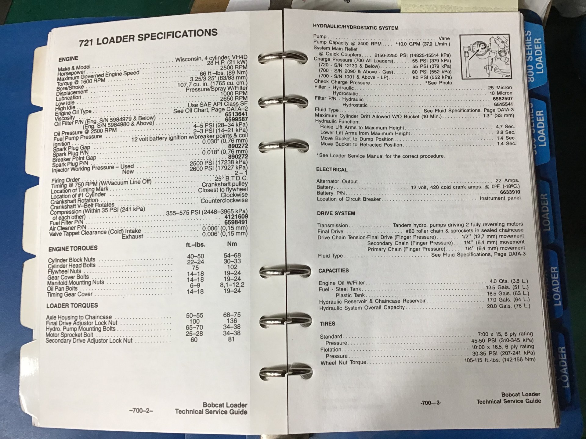

I have attached a photo of the 721 loader specifications. Not sure if this is your specific machine but it does show that the Wisconsin VH4D timing @ 750 RPM (W/Vacuum Line Off) 25 BTDC and the timing mark is on the crankshaft pulley.
Hope this helps.

I appreciate your help. My problem is my crankshaft pulley is facing the front of the skid steer and not accessible.

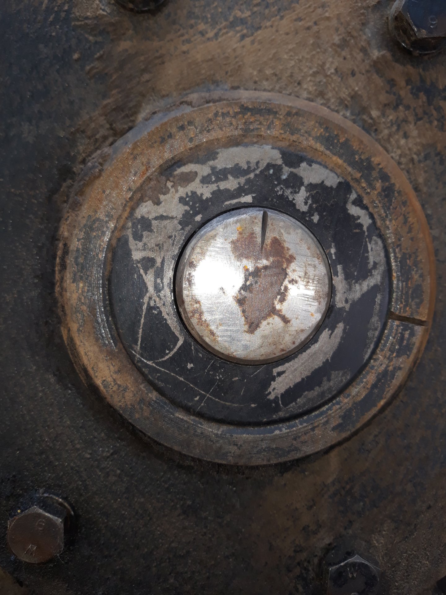

This is a photo of what I think are my timing marks.

It should be timed at above 1700 RPM . I usually just open it wide open and pull it back a little . By getting above 1700 the advance is fully open then just set it to the marks . hope this helps
Thank You. That's what I will Do.
