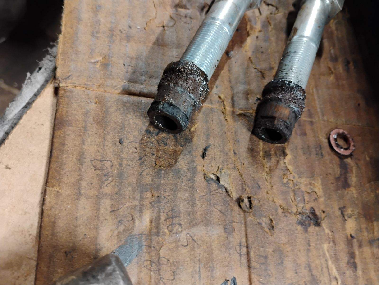

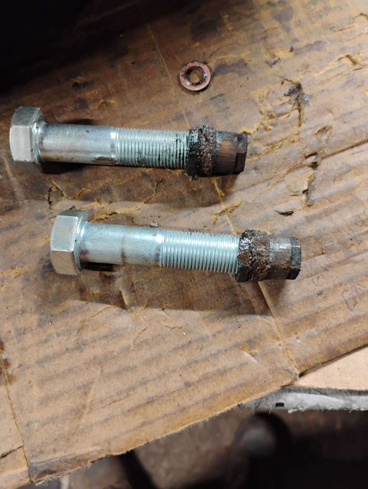

I had to pry these out. I'm not sure if they are rebuild able. The shop I took them said they weren't . NH can't get them, and the shop said no one had them. I did find a guy that said he might have the bodies. Just wanted some thoughts or ideas. I'm new to diesels and injectors. Thanks for any suggestions in advance. Nik

Maybe check with these guys. The NH number is 87801538. It is a Lucas injector #LRAB01601A.

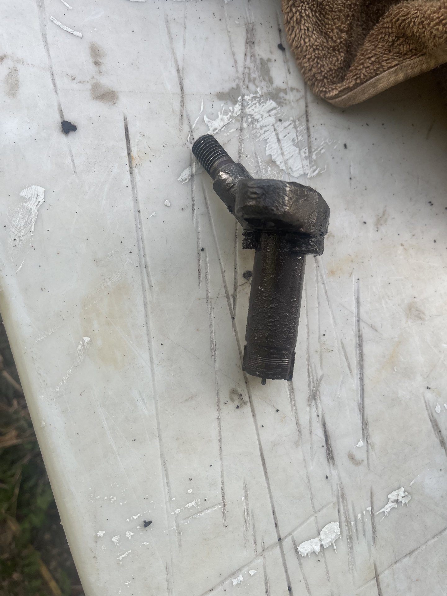

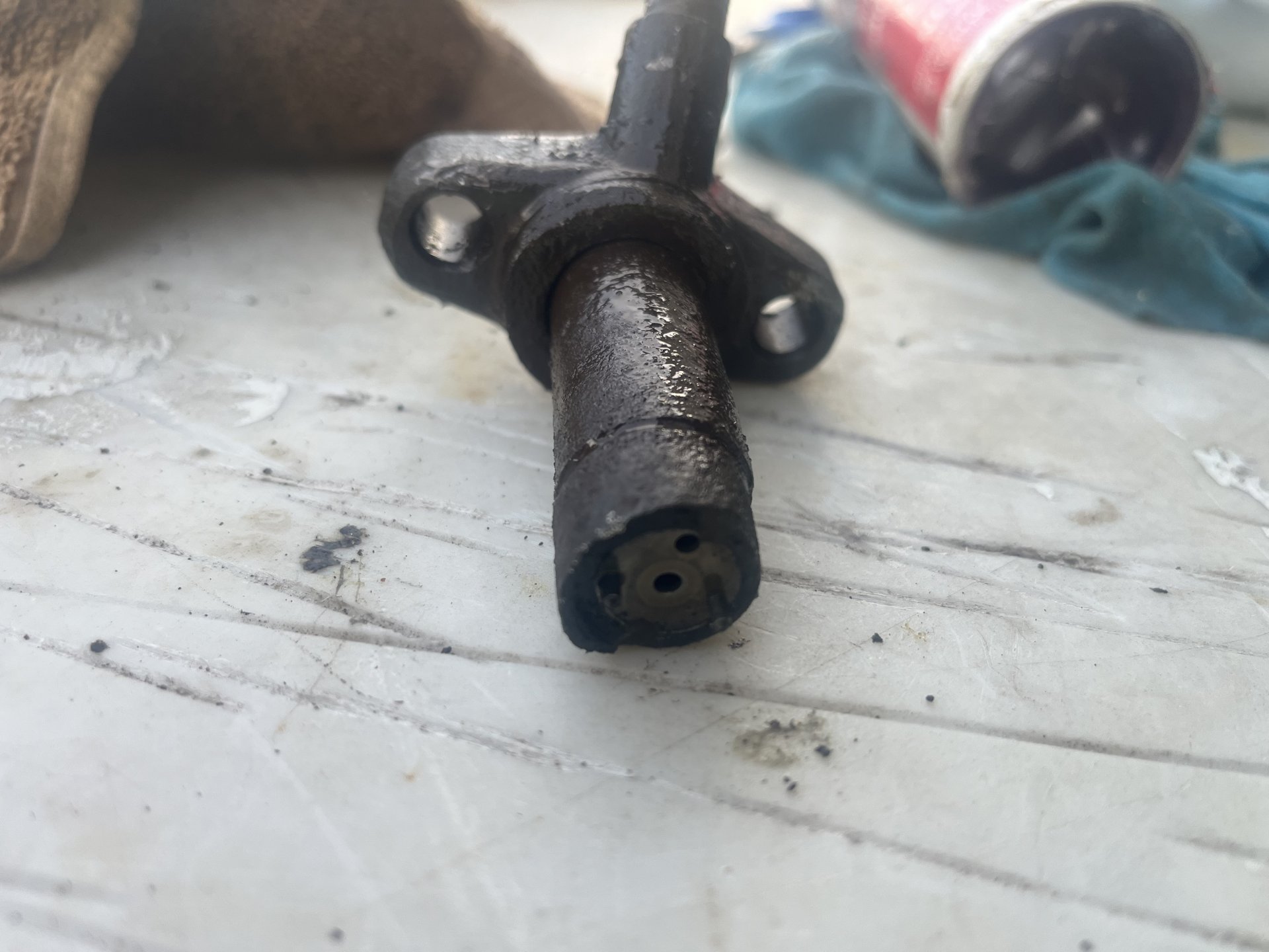

So I got my cylinder head installed or I thought. I put first injector in slips right in . 2nd and third won't go. I unbolt head and discover the old body welded its self to the injector bore. Now I'm out of ideas. I'm gonna try running a 55/64 flat bottom drill, which I'm gonna have to make once I get it from Amazon. Anyone have this issue ? Open for suggestions ?
I believe that I would take it to the machine shop that serviced the head ,maybe they just missed that problem?? certainly they are better set up to do it than your average shade tree. from the hole that was open they can get all the required measurements to bore bar out if necessary.
Yeah, I never told him to check that part out. The injector is on an angle definitely gonna need a mill to bore it. The question is is it a critical dimension? The hole has clearance for the injector body to slide in. The smaller diameter dimension by the tip of the injector looks like it is more critical. I believe at the end of the day the copper washer seals the injector to the combustion chamber. Wish my. Bridgeport was up and running, might be a great reason to get it functioning now. Anyways, gonna try the drill and see how it cleans up. Guess my tool and Die days are paying off . Will update on how I fare.
do you think that maybe now that the head has been tanked( I assume) that you could thread the remains of the injector and use a slide hammer to knock it out?

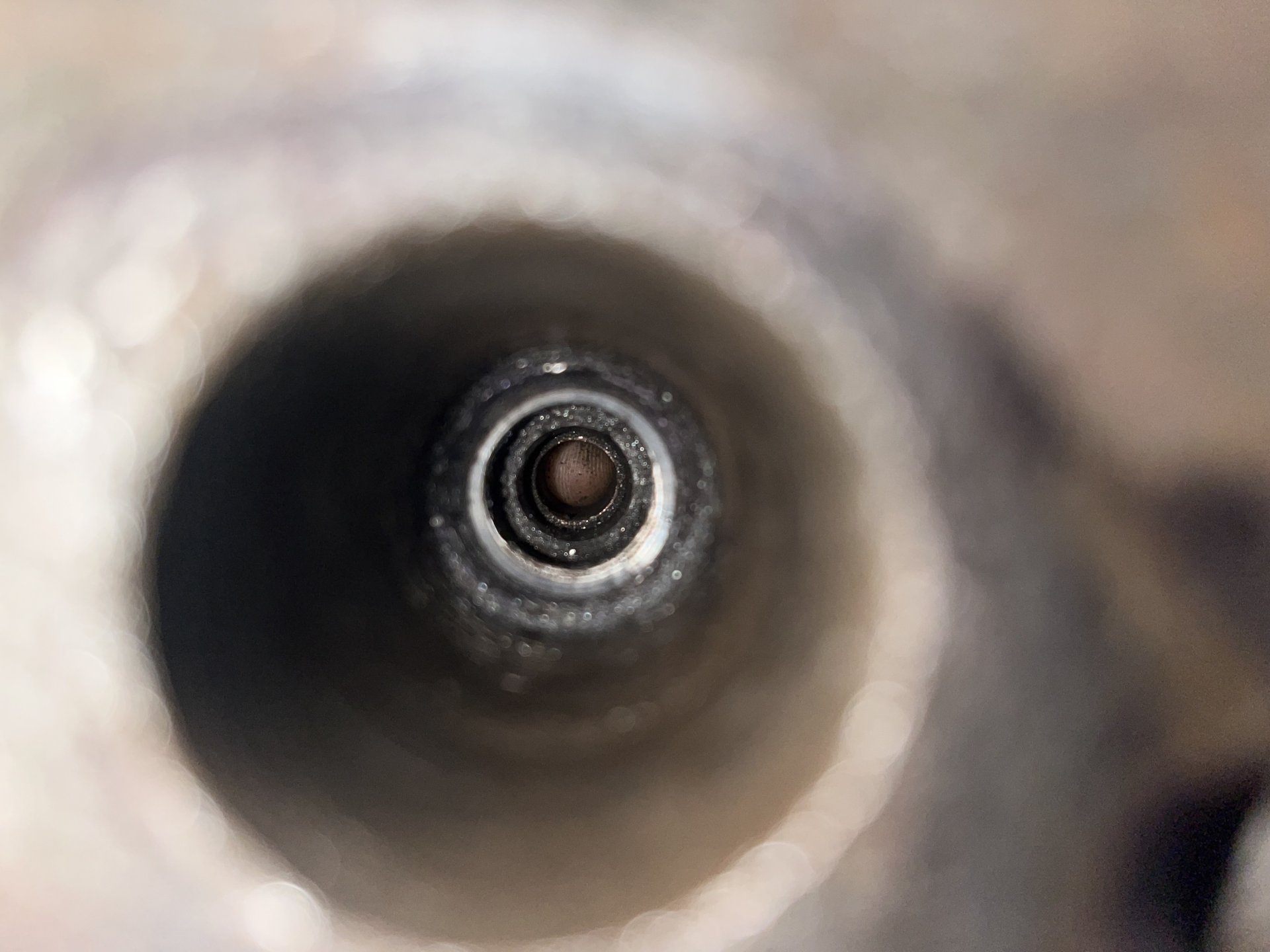

I think the smaller portion which mics out at .664 is either corroded or or galled up or something. I ordered a .666 reamer which I measured the bore diameter at. Gonna try to carefully run a reamer in there and clean it up. The larger bore is the more corroded with pieces, might try to ream that out as well. So much for getting it running this weekend. Atleast the weather isnt gonna drop too soon. Oh well.
Seeing as you have tool and die experience, yes the copper washer is the sealing point and if you just have bits and pices of the body in there have you tried a pick to see if you can flake any of the pices off, it may clean up easier, it could be carbon holding it , emery cloth fitted in the slot of a 1/4 dia cotter pin chucked in a die grinder makes for a quick flap wheel for small bores.
That's a great idea, never thought of that. I managed to cut an angle on a drift punch and chisel out the portion that was left in there. But there is definitely something holding it up. I'd probably have to weld a stub since I need to reach 2.5-3" do in the bore. The head guy said bring it back, but he doesn't know if he has a .666 reamer. Thankfully Amazon has one .

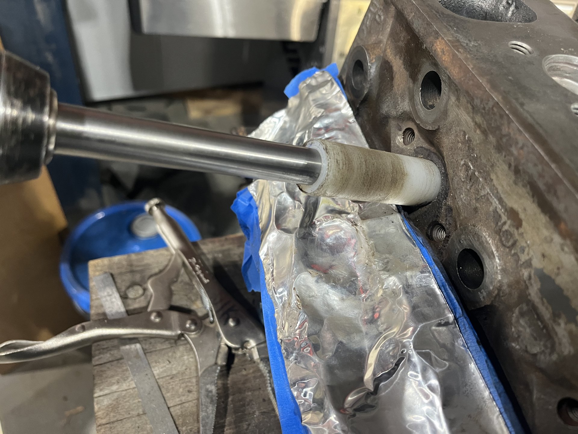

Okay I made a jig to locate the reamer concentric to the injector bore thinking there should t be much matl to take out. This is the picture of the reamer cutting a new bore. Something doesn't seem right. Before I go further I wanted any of your guys opinions. The original injectors were literally gone. I double checked the bore on the one that does fit. With out a different plug gauge set or something I can't accurately tell what is currently there. I would have thought the rusted parts would have broke free from the cast iron. I'm gonna take it to the head guy tomorrow for his ideas. I think I'm on the right track. Open to any suggestions or thoughts.
I would think that the head guy would know, and I would take a good injector with you.
Well we or I should say he determined the 5/8" dia part of the body broke or rusted off and welded itself to the head. He's gonna fix it and was excited to work on it. Keep you updated. Nik
