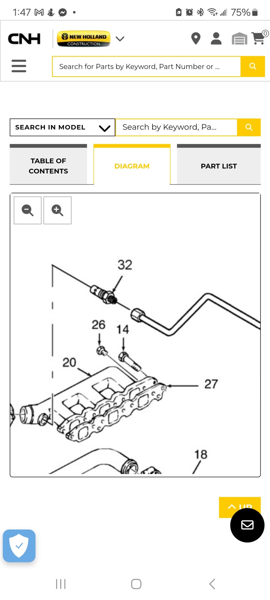

This engine doesn’t have glow plugs. Uses a grid heater on the intake.

Right, but it doesn’t start easy when it’s like 50 degrees out or even 60 or 70. And now I have no fuel out of the injection pump. So there’s that
