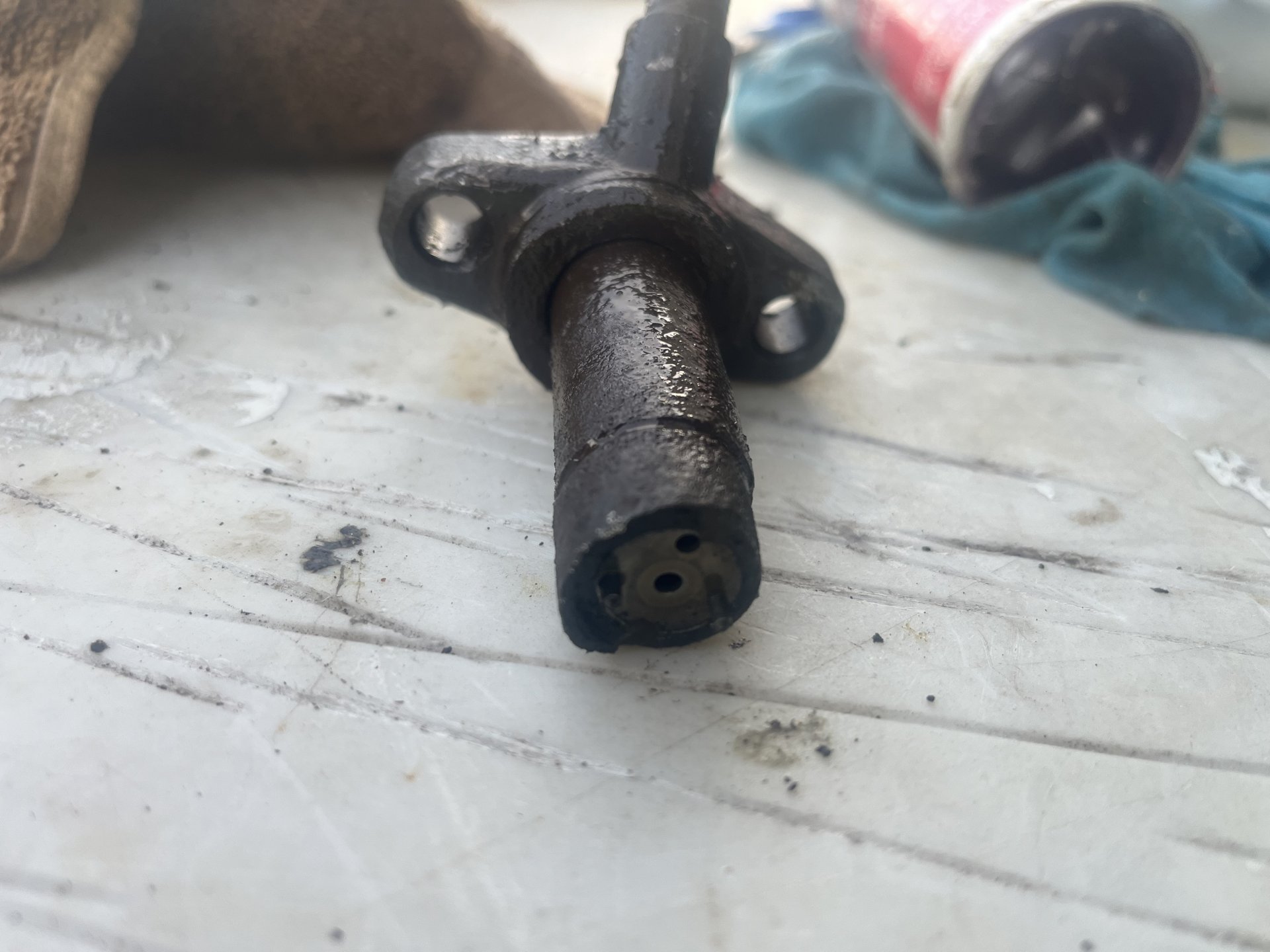

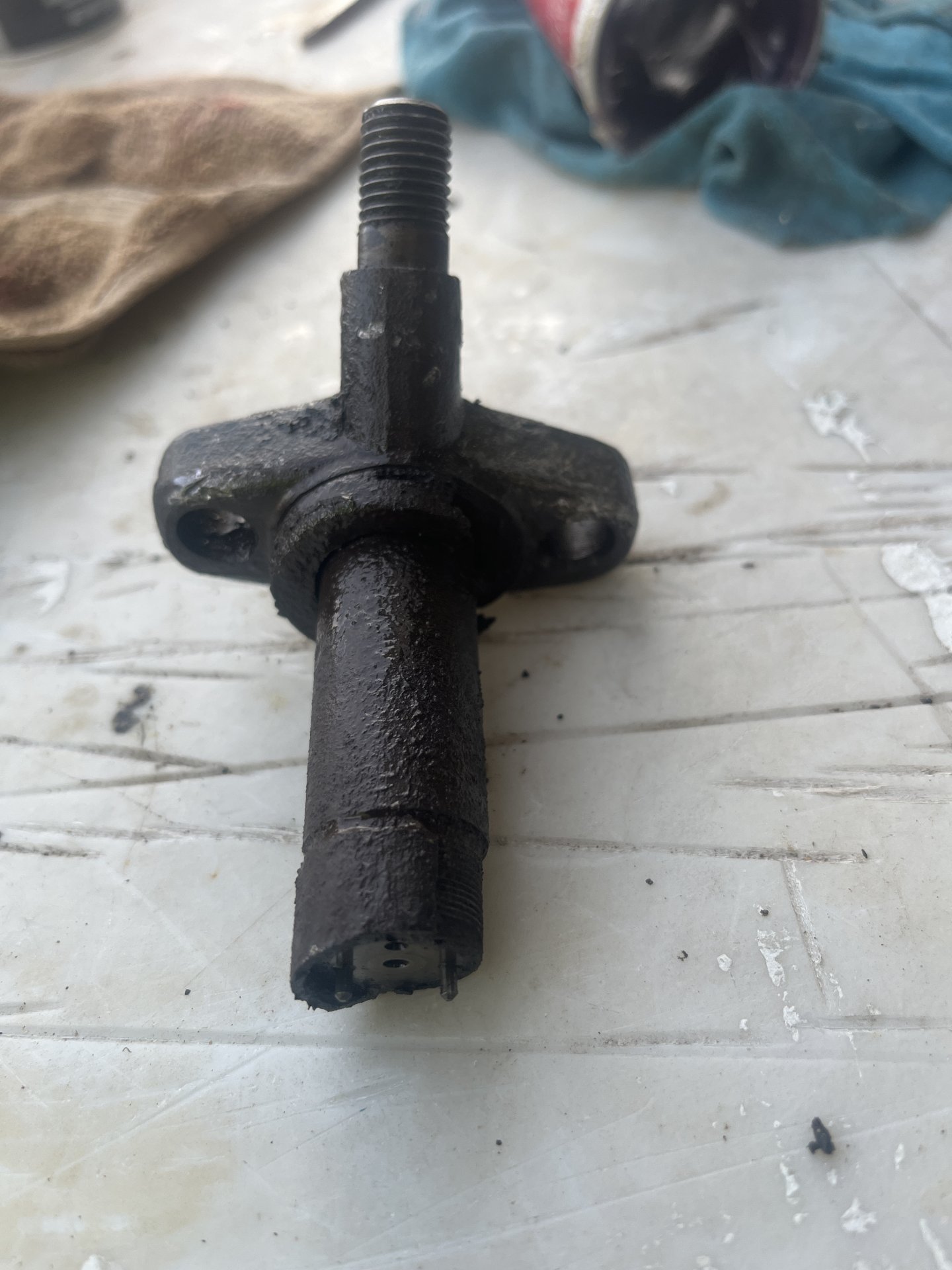

So now I definitely have to pull the head, the damn injector broke I was wiggling it and got it out . Thing is all rusted .
Damn injector

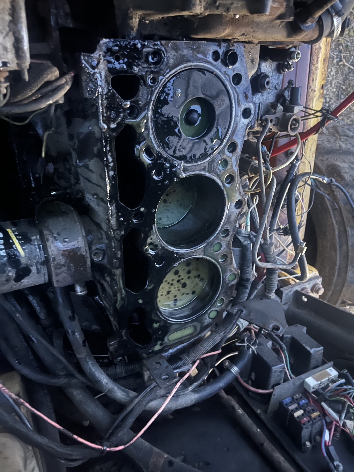

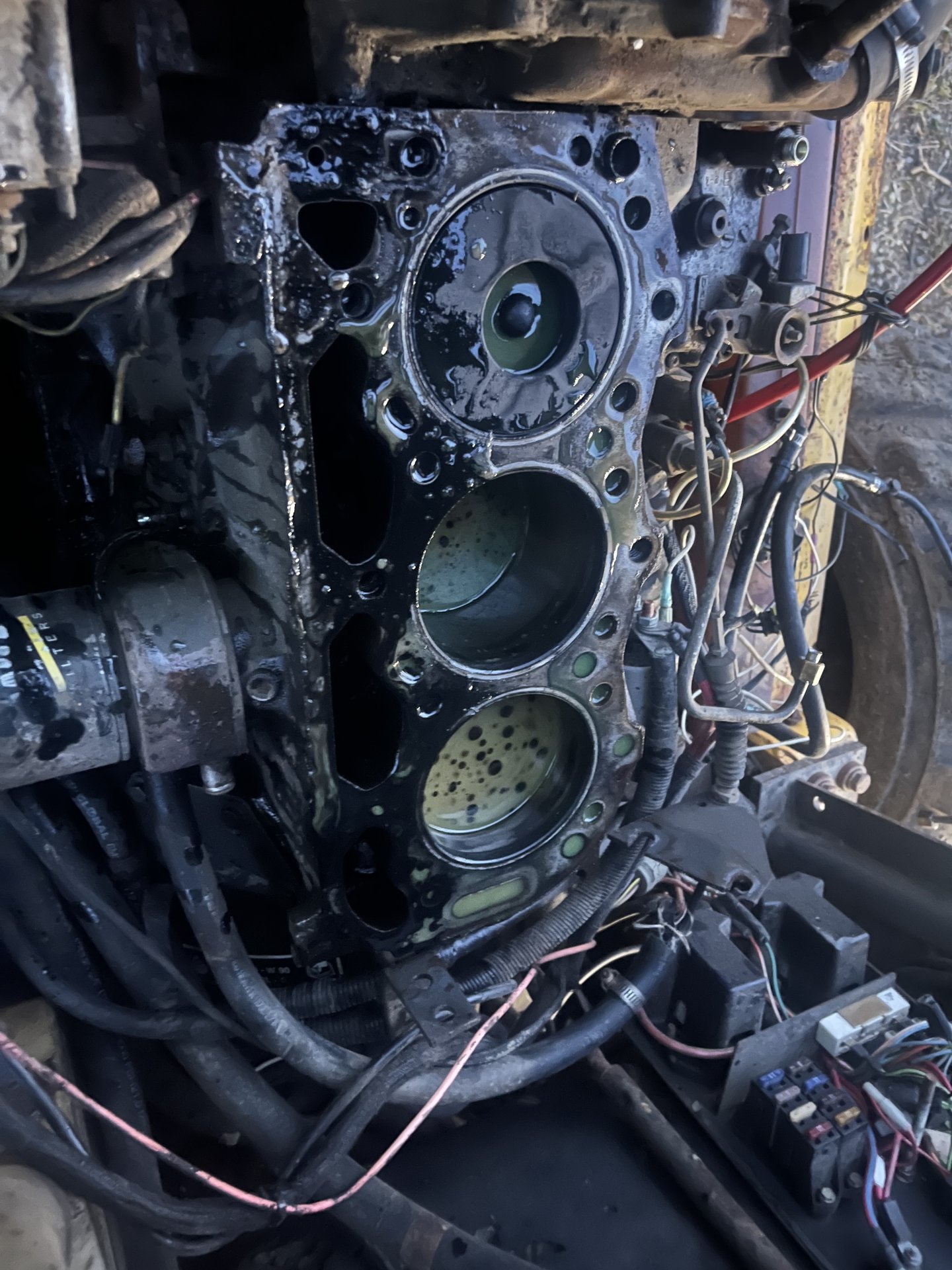

So now that I have the cylinder head off. Only took 3 hrs. Anyways, probably should magnaflux if for cracks . My bigger concern is the fact the injectors were rusted so badly. I’m hoping head gasket, or probably cracked head. Might have to check the cylinders for wear as well. Any input on what you’d do is welcomed. I do say it wasn’t as bad as I thought it’d be. Plus my 11 yr old learned how to take apart an engine. Thanks in advance. Nik
So now that I have the cylinder head off. Only took 3 hrs. Anyways, probably should magnaflux if for cracks . My bigger concern is the fact the injectors were rusted so badly. I'm hoping head gasket, or probably cracked head. Might have to check the cylinders for wear as well. Any input on what you'd do is welcomed. I do say it wasn't as bad as I thought it'd be. Plus my 11 yr old learned how to take apart an engine. Thanks in advance. Nik
on the bright side I do not see much ridge in the cylinder. run a good machinist straight edge on block deck look for flatness. I remember reading something about water collecting around injectors on machines that live outside and rusting up on some models and someone made a water baffle to route water off the engine. of course I do not know if this is your issue.
Yeah I think its previous life was outside. I think replacing injectors is a definite. Are they supposed to come apart? I know there’s a few pieces to them. Not sure if they are salvageable.
Yeah I think its previous life was outside. I think replacing injectors is a definite. Are they supposed to come apart? I know there's a few pieces to them. Not sure if they are salvageable.
a diesel shop that repairs injector pumps should be qualified to check spray pattern and repair if possible. I would have to go with their advise on the condition of those you have. but it might just be better off buying new set, or newly reconditioned set if yours are to far gone than go down a black hole of trying to repair those since you already know one is broken.
Trying to find new ones. Local shops can’t find them. Also I took the head in, the owner showed me where it was leaking. He’s resurfacing and a valve job. This thing will be as good as new ….
