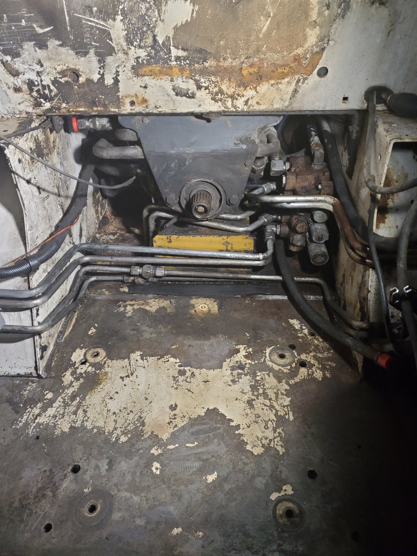

There are lines that run between the motor and pump. The steel lines get a bunch of dirt and gunk packed around them and then rust through.
Yes this is true.
Pulling the motor wasn't as big of job as I thought. You will also have to remove the blower housing which was a pain. Those lines run behind the blower housing.
Been there done that. See pic for the lines visible after the engine and blower housing are removed and after hours of degunking! Your leak could be any of these lines. I replaced the bottom 2 with the T shown as they were corroded with pinholes. A local diesel shop manufactured new steel lines (bending) using my old ones as templates…much cheaper than from dealer. If there is any doubt about hydr valve spool seal integrity, this would be the time to replace them (engine out).
