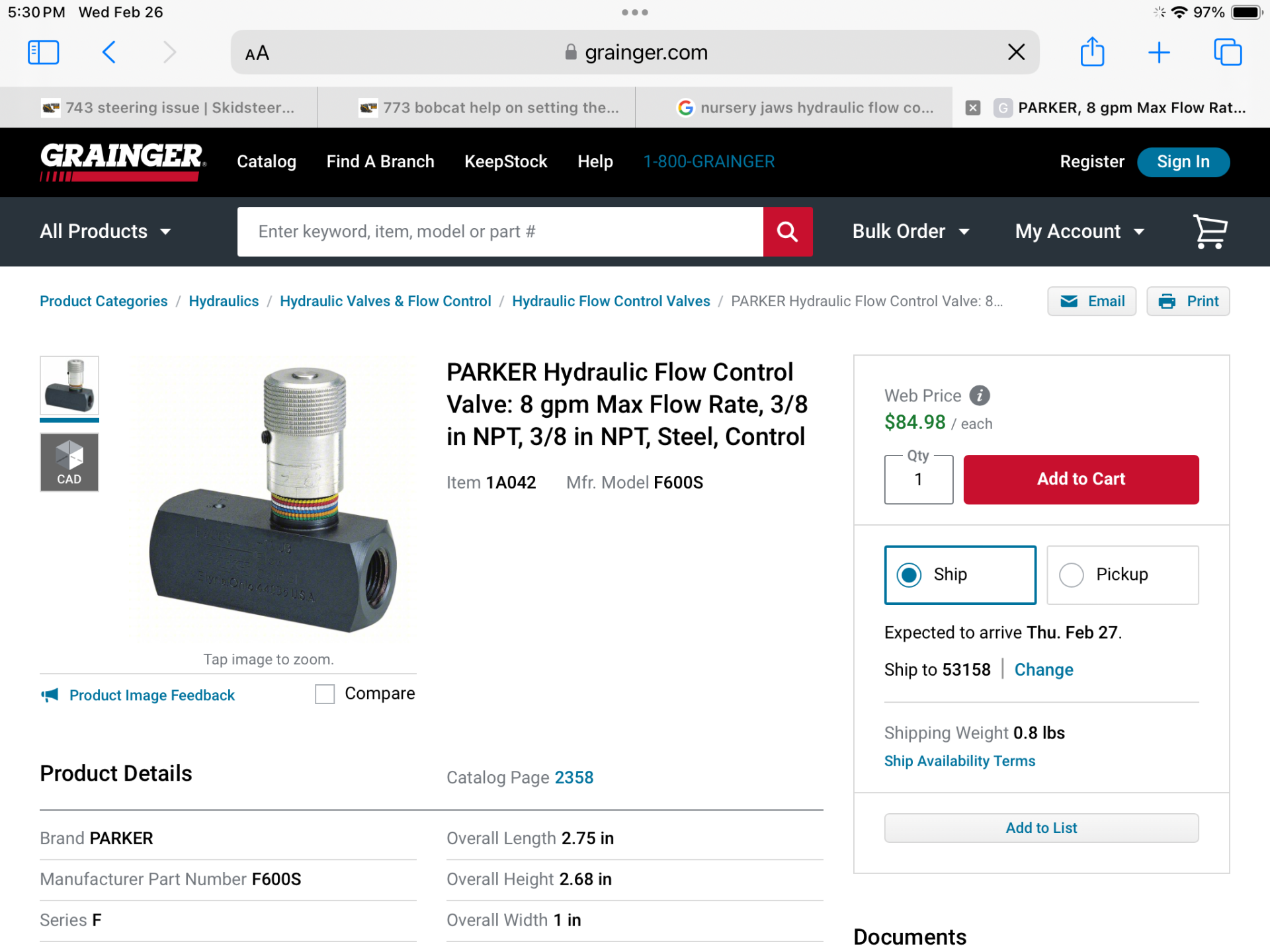

I used one of these for a nursery jaws, to slow the aux hydr flow squeezing when lifting ball/burlap trees. Works epically well. Put it on the attachment right behind a coupler. I don’t think it matters which one. Let us know how you ended up. Its prob half that price on Amazon.
    715.8 KB
way easier to use a coupling with small hole, the adjustable work great but add length to the coupling and cost 100 dollars and you still need couplings as they are female threads both ends
