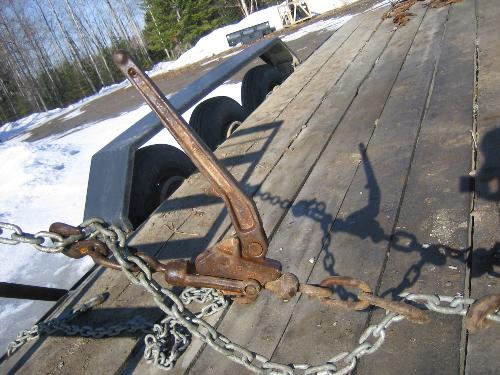

As for the binder, those things could be leathal. My father despite years of expieience and a careful work ethic got hit by the pipe when it slipped. No permanent damage but it left a mark that took weeks to go away.
I should post some pics of the one type of binder that is somewhat safer.
All over center binders, the handle points right at you when closed, and if the chain is real tight, opening them involve the handle flying around in a 180 degree arc as you release the stored energy.
The binder I like has a extra pivot point in the handle, when opening, you simply pivot the handle at this point about 120 degrees, so its pointing straight up, now when you open it it flys away from you and yoou just kick it with your heel to open it. No pipe needed.
Its not always easy to find a store that carries them, but its worth hunting for

It took me a bit but here
Binder closed
Handle in the “ready to undo” position
Binder closed

I agree with the above comments about using those pull open load binders such as the one pictured. I've never used them but I have some truck drivers take that pipe in arm, the shoulder or the side of the head after releasing the binder. For my money, I use the center ratchet type binder. It is just like a ratchet type wrench. You set the pivot to either retract or release it and then just crank it. It's hard to get hurt doing that and a bunch easier. I got mine at Harbor Freight Tools, a 9200lb binder about $22, but I think that you can get them at Northern Tool, Ohio Tool or Tractor supply. Good Luck
Most of the ratchet staps don't have a WLL (working load limit) near as high. Here your chains and binders must be marked, the one pictured has a 5400 lb WLL rating and is good with a 3/8 grade 70 chain.
These are the chains and binders our lowbed is equiped with. If you use ratchet straps you should have ones rated for 1/2 the weight of what your tieing down. The harbor freight binder 9200 lb rating must be “breaking strength”
