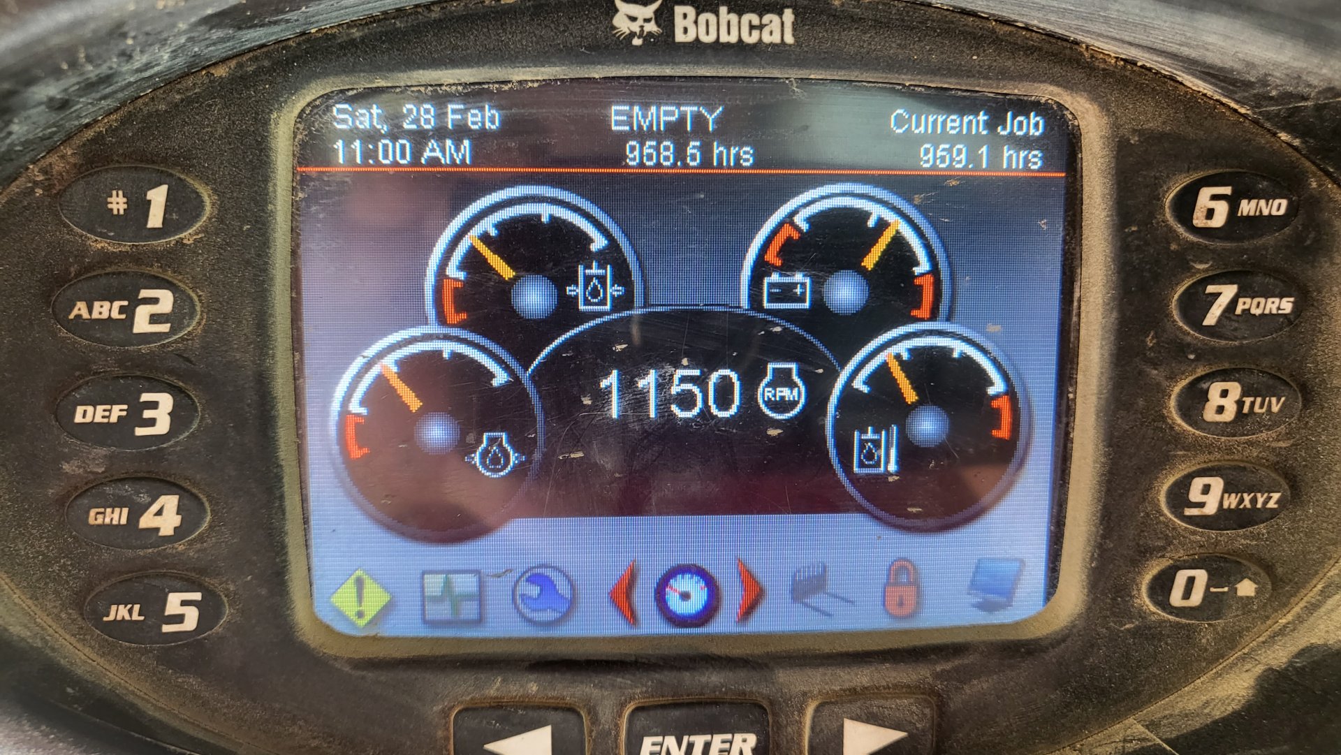

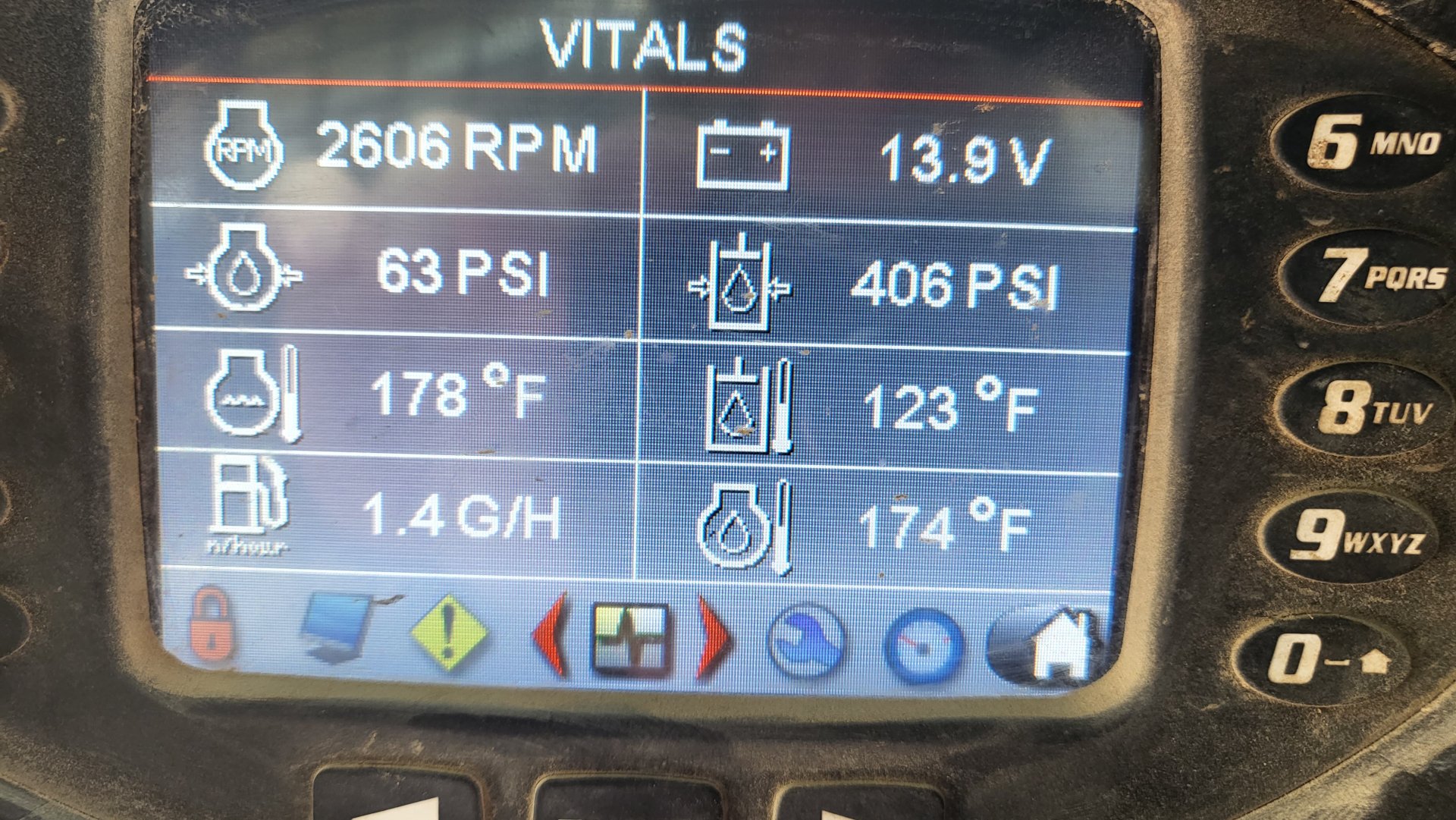

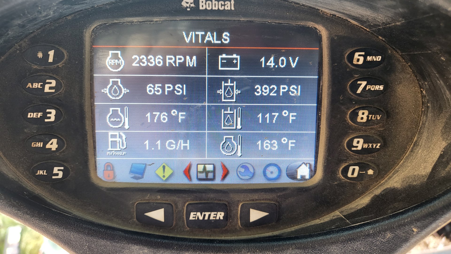

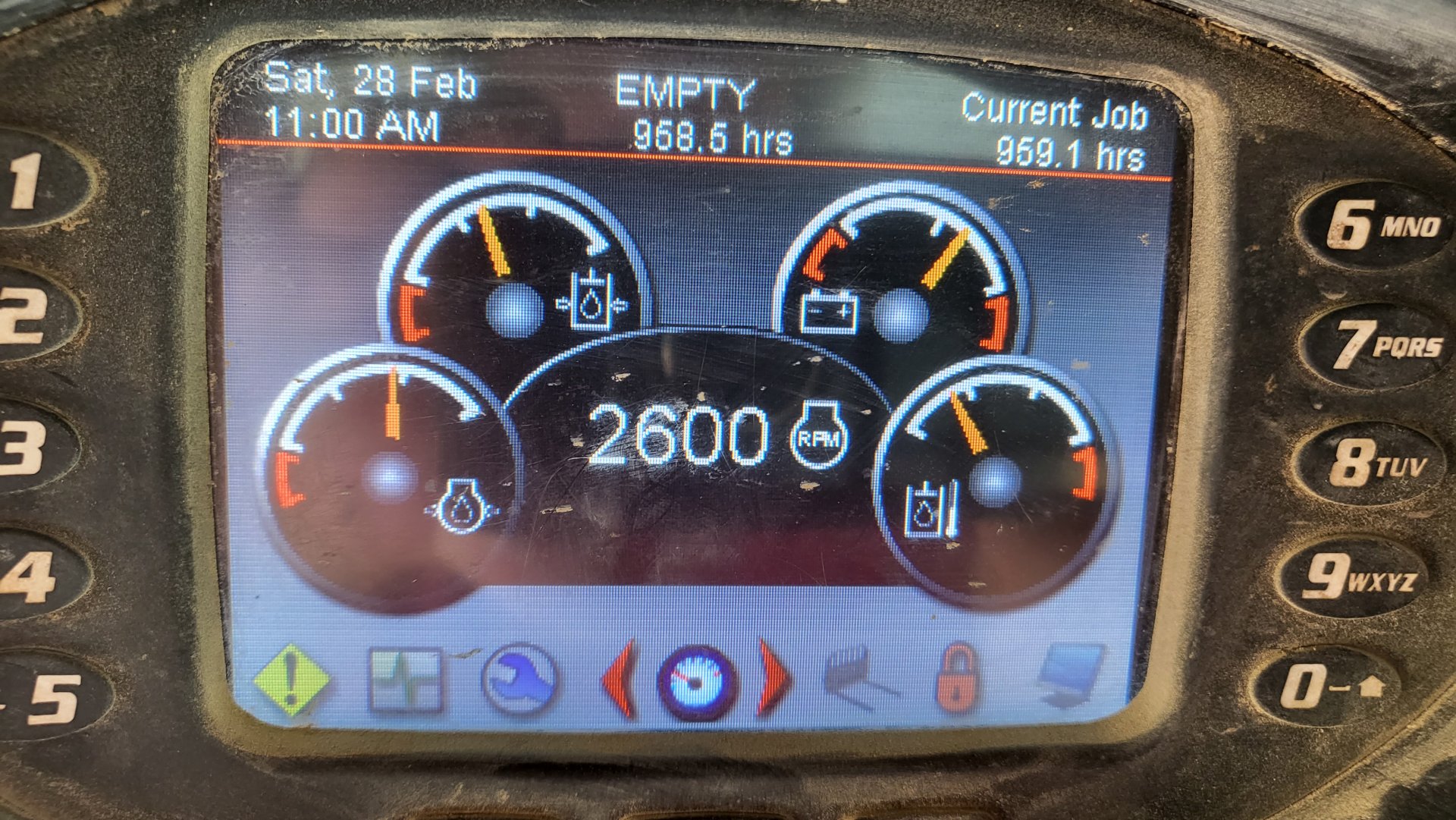

Hey everyone! I'm a newbie here, and I am having a problem with a T595. The bucket will only lift with the engine at full throttle, and even then, will not lift a load. When it goes up, it will hold and not go down until "told" to do so. The drive seems to work ok, but maybe slower than usual. I checked the drive belt and tensioner. On the gauge, the hydraulic pressure is pretty low (not in the red, but close at low engine speed). Wondering what it should normally read, and if anyone has any obvious things that would cause this problem. The one picture shows hydraulic pressure (top left gauge) at low RPM, and the other at high RPM (both with no load). Any help is appreciated. I was able to get to the actual readout as to the hydraulic system psi. Is 392 psi at 2336 rpm low? Any help is appreciated!

OK, either your Main relief valve is damaged or your gear pump is gone. For both you would need a Flow Meter to Test. Every Hydraulic Shop should have one.
I mean there is also a possibility that you blew your pistons in both lift cylinders, but with the flow meter test you could quickly determine that
