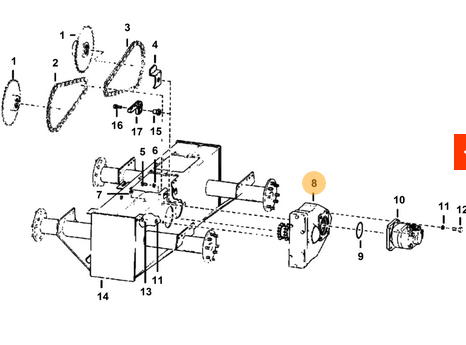

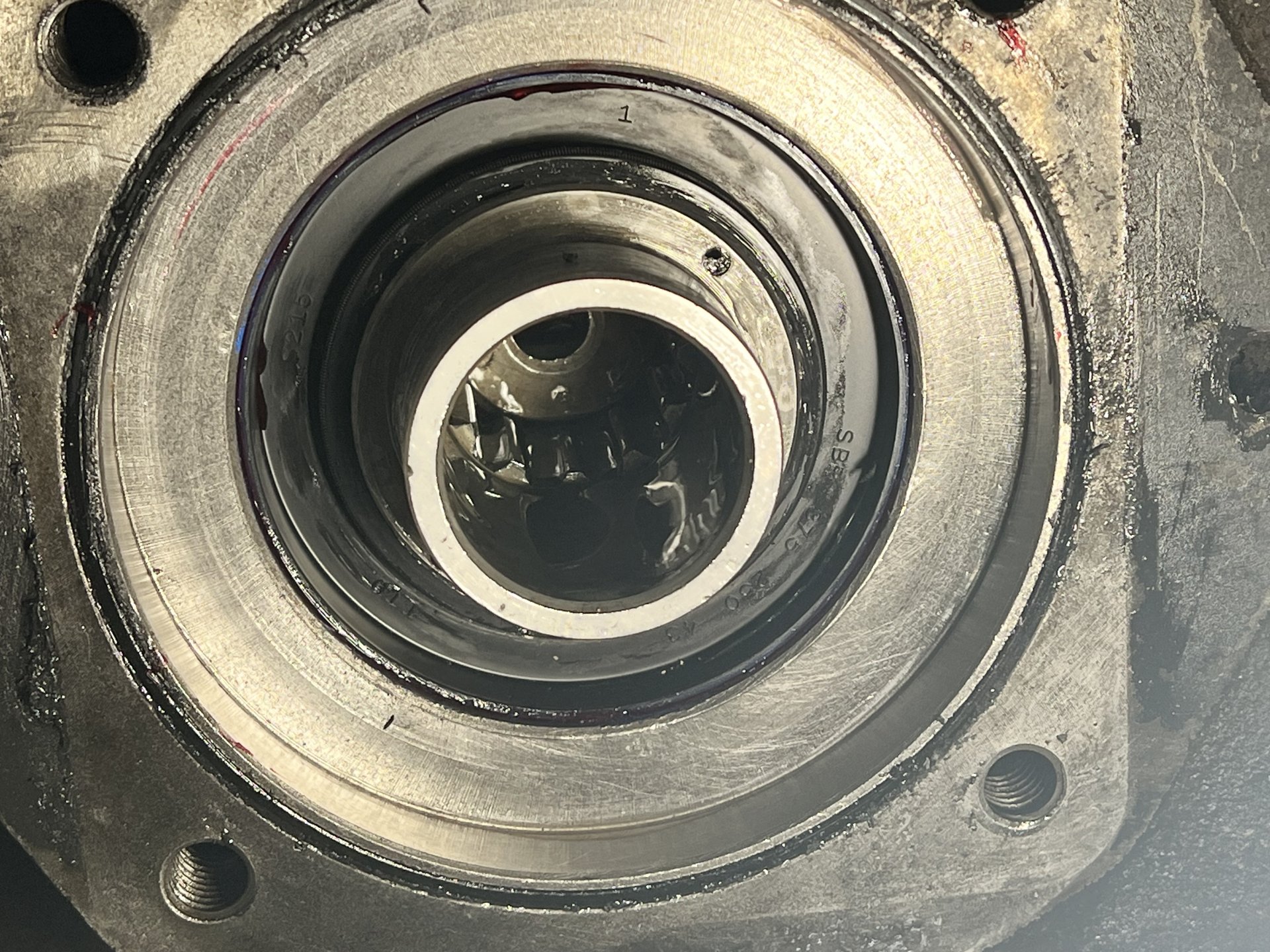

If you take the 1/2" drive plug out of the front of the machine you'll find where you extra hydraulic fluid went. This seal is probably bad. It keeps the motor return fluid from leaking into the gear reduction. The gear reduction is lubricated with motor oil from the chain case normally. There is also an O ring between the motor and case you can see below. Pop the drain case hose off and drain hydraulic fluid, then drive motor hoses, then 4 bolts. It's pretty easy, but do note the orientation of the seal. The motor side is pressurized, so the seal gets installed lip out.
