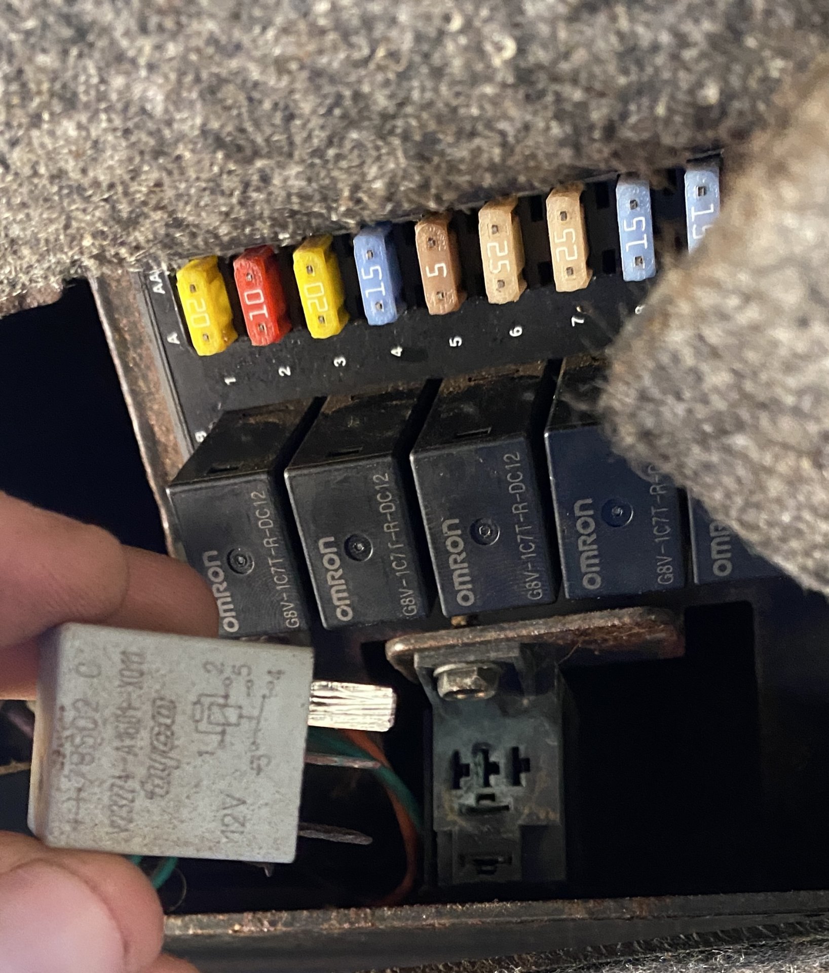

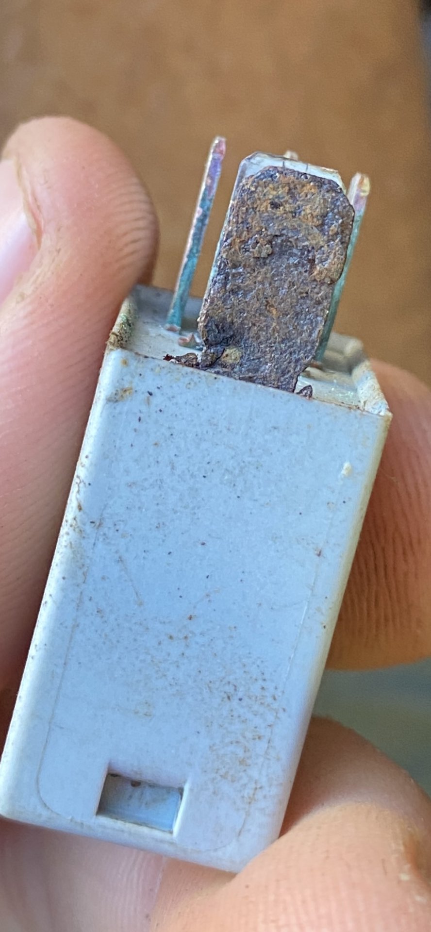

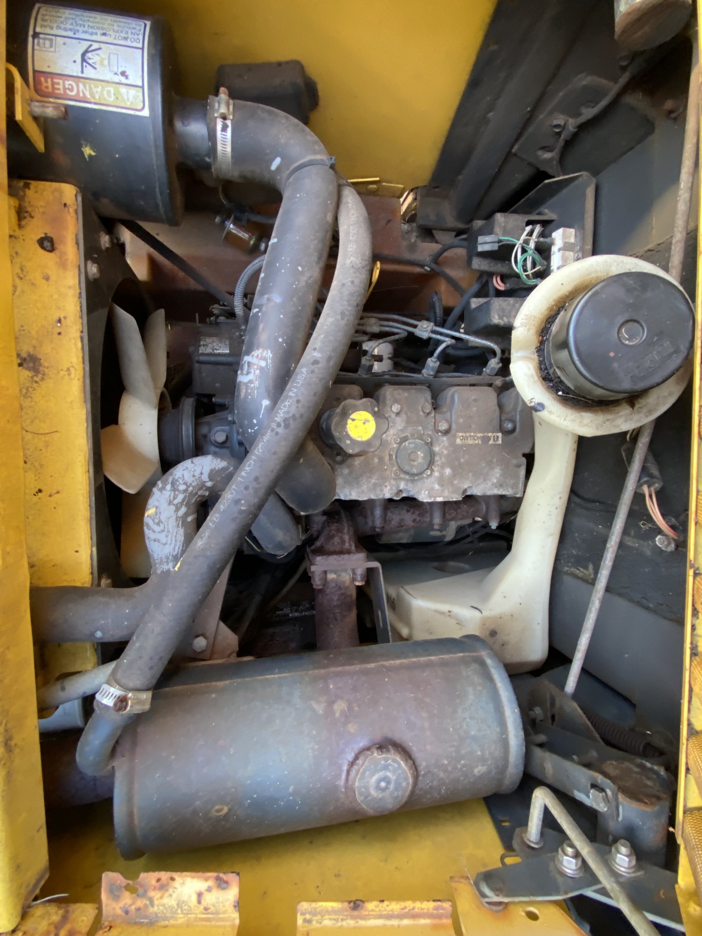

Checked those fuses and blocks, I couldn't actually locate that row of black blocks in the engine compartment (picture below), but I do have a fuse / relay area in the cab, which has 4 ~1"x1" blocks, maybe my machine is slightly different (or I'm just not seeing the fuses in the engine compartment). Anyways, wiggled those, pulled them in and out and no corrosion that I noticed. The gray relay in the picture here though had a severely rusted pin, to the point where it was barely hanging on. I'm not sure what this relay does, but I'm going to get a replacement today regardless. The machine is older, and in a salty environment, so it's a bit of a discovery process.
Yea, that relay is junk. Not sure what that one does. It may deal with the flashers. If you're parts guy can't find it, have him look at figure 55.404.11[01]. It might be item #8. Messicks.com is a good website to look at part catalogs. So, I'm going to admit that you're machine is just a little newer than what is my wheelhouse. I did have an L170, but didn't get into working on it too much. Plus, I think your machine might have the cab upgrade and I never owned one of them. You're relays are in the cab and that is a better place for them. Check you PM box.
