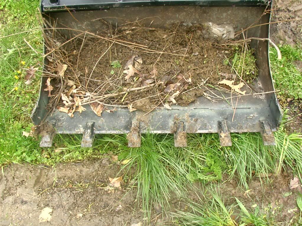

Heres the next project on the list. A grapple conversion. It started life as a OE bobcat 40" bucket that came on the 310. The prior owners tried to fix a cracked bucket by welding on a 1" piece of plate. At some point it had forks welded to it as well. They cut those off. I had to do a little bit of surgery and was able to salvage it. I cut the old cutting edge off and welded on a piece of 3/8"x6" plate, and fabbed some teeth out of the same stock. I cut off the top "lip" and welded in a piece of 2"x1/4" square tubing to mount the grapple to.. The round tubing is 1 1/2" roll bar tubing I had laying around. Bent with a Cheap Harbor frieght bender. The hinges are 3/4" round bar and 3/4" i.d. DOM tubing. Besides the hoses being too short, it works pretty good. Soon as I get some longer hoses, its time to clean out all the junk in the woods.

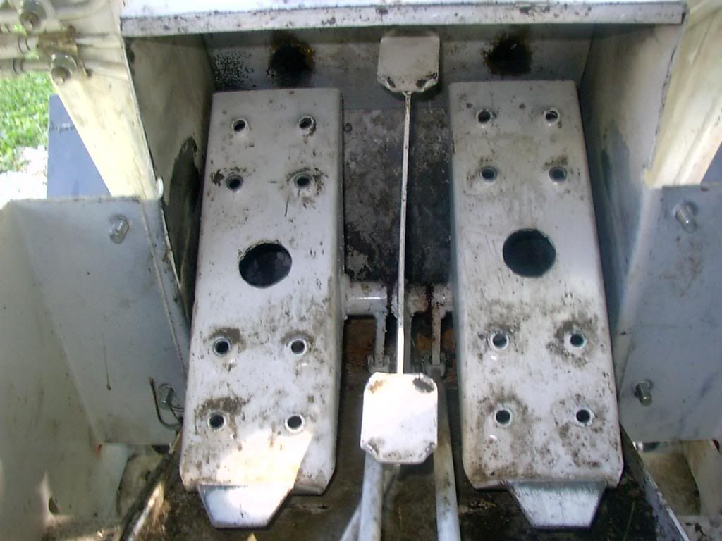

Here are the pedals. A section of the original pedal tube was cut off and replaced with a piece of tube and pedal for the auxillary control.

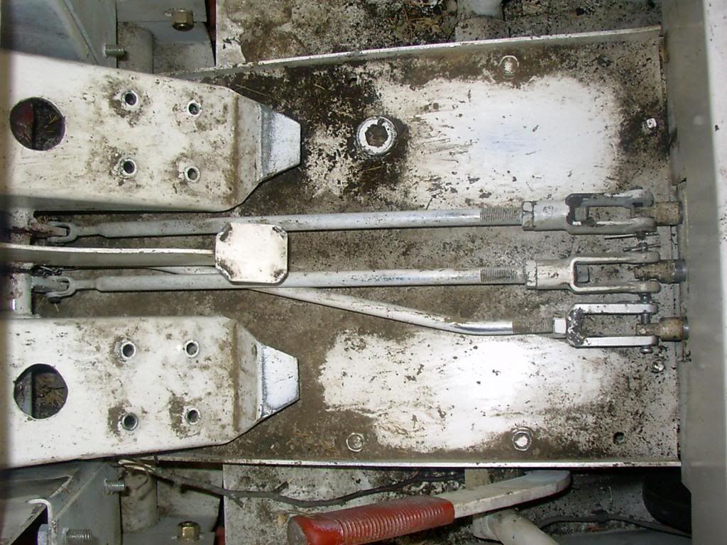

View of the linkage. Clevis' are fabricated. Threaded on one end for adjustment. Rod is 3/8".

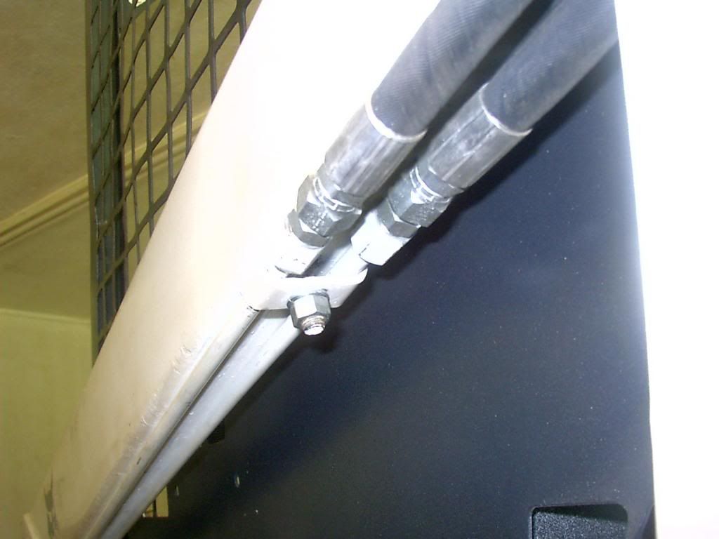

Quick connects on left lift arm. I used 1/2" safeway couplers since I wasnt worried about flow. You can use the flat face connectors, but dont plan on running any modern high flow attatchments. I had to fab and weld the mount to the arm.

Almost forgot about the funnest part of this. The cross tube for the pedals was rusted solid. Prior owner just loosened the cross bolt so the pedals would move. Tried heating with a torch but no go. Wound up having to cut the tubes off the pedals and weld new ones on. There is actually a smaller tube inside the pedal tubes, and a long bolt goes thru that. You will notice the big holes in the center of the pedals. I added grease zerks and a way to get to them.
