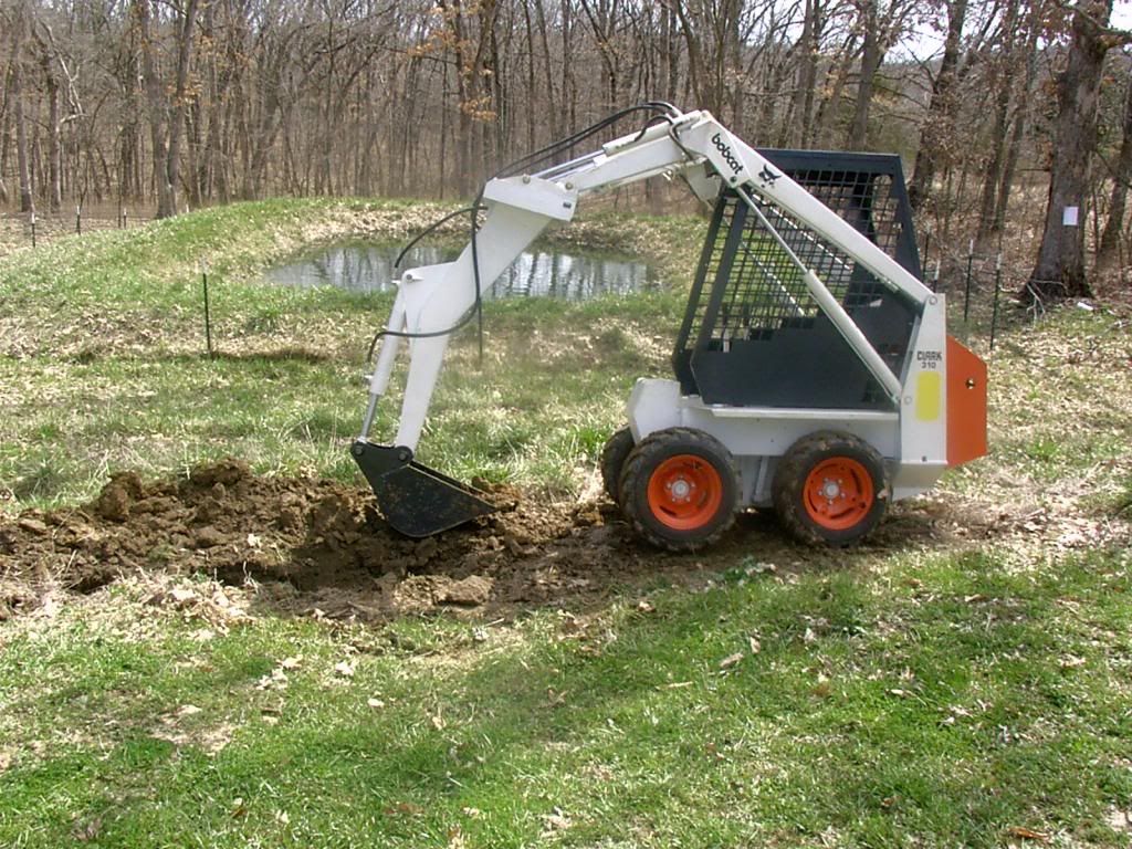

This is my latest creation. Made from 1/8" plate to cut down on weight. Bucket and Quick-tach plate are 1/4". Picks up a full bucket of wet dirt at full extention without coming close to tipping. Weights around 250 lbs.

Nice job!! I have been thinking of building one of these too. Did you draw up any plans for this, or just free style it? Cheers!!

No plans, just free styled it. I had to change the angle of the frame, as when I first tacked it up and test fit it, the bucket would hit the loader when curled back. Glad I checked first. I also made it too wide at the pin. Didnt think about the possibilty of needing a 6" trenching bucket. Oh well. Ill fix that on my next one :)
That looks great! Do you have any rough ballpark estimate as to how much that will cost to build?
I think I have around $200 in the cylinder and hoses/fittings. Probably 150-200 worth of steel. If you already have steel, you can save some money.

Great job!!!! I like it a lot......I'm going to try making a bucket soon and as long as it works out this will be my next project.... Hey where did you get the cylinder? Thx Craig
Buckets are pretty easy. I got the cylinder and hoses/fittings from surpluscenter.com.

Sorry for the long delay. Sorry, no I do not have any video of it. I sold the 310 and have to adapt the hoe to my 463, so as of now I cant get you one.
