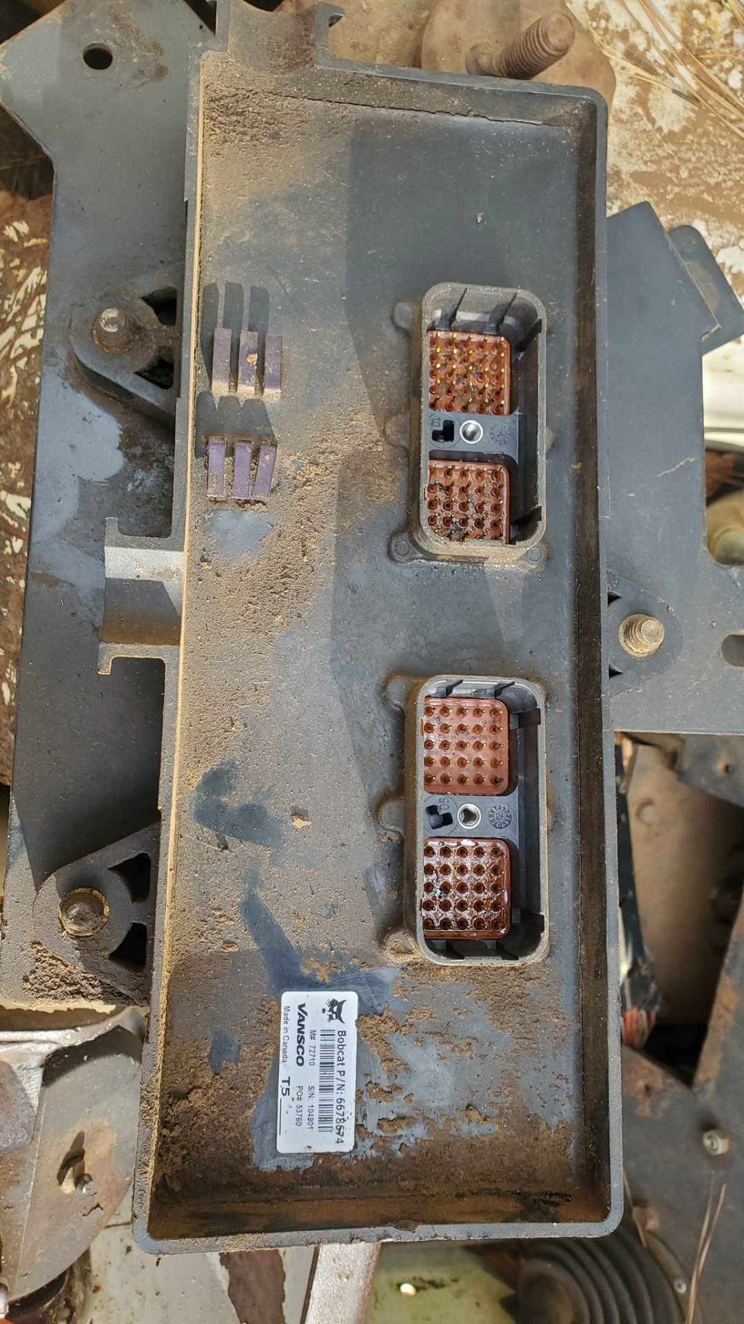

I have a 763 which had the control unit go up in smoke. I found no obvious damage to any of the wiring and whatever happened did so while it has been sitting for the last month or so. I worked the loader for a solid 20 hours just before parking it with no issues at all. ANyhow, I have got to use the loader for a short bit so I need to figure out how to bypass the control board all together and get the interlocks and traction lock satisfied. It seems these control boards are hard to find and I am not willing to buy new from Bobcat and apparently they are on back order anyhow. My machines Serial # is 512264537 which shows as an H model but this is a G model unit with a 2 plug control board. I sure would like to find a good wiring diagram so I can create a proper bypass setup to get the loader operations until I can find a new control board. I actually have an original Bobcat service manual set but it does not include my particular model which sucks. Those diagrams that are in this manual are nice but of no use as they are not even close to the same.
