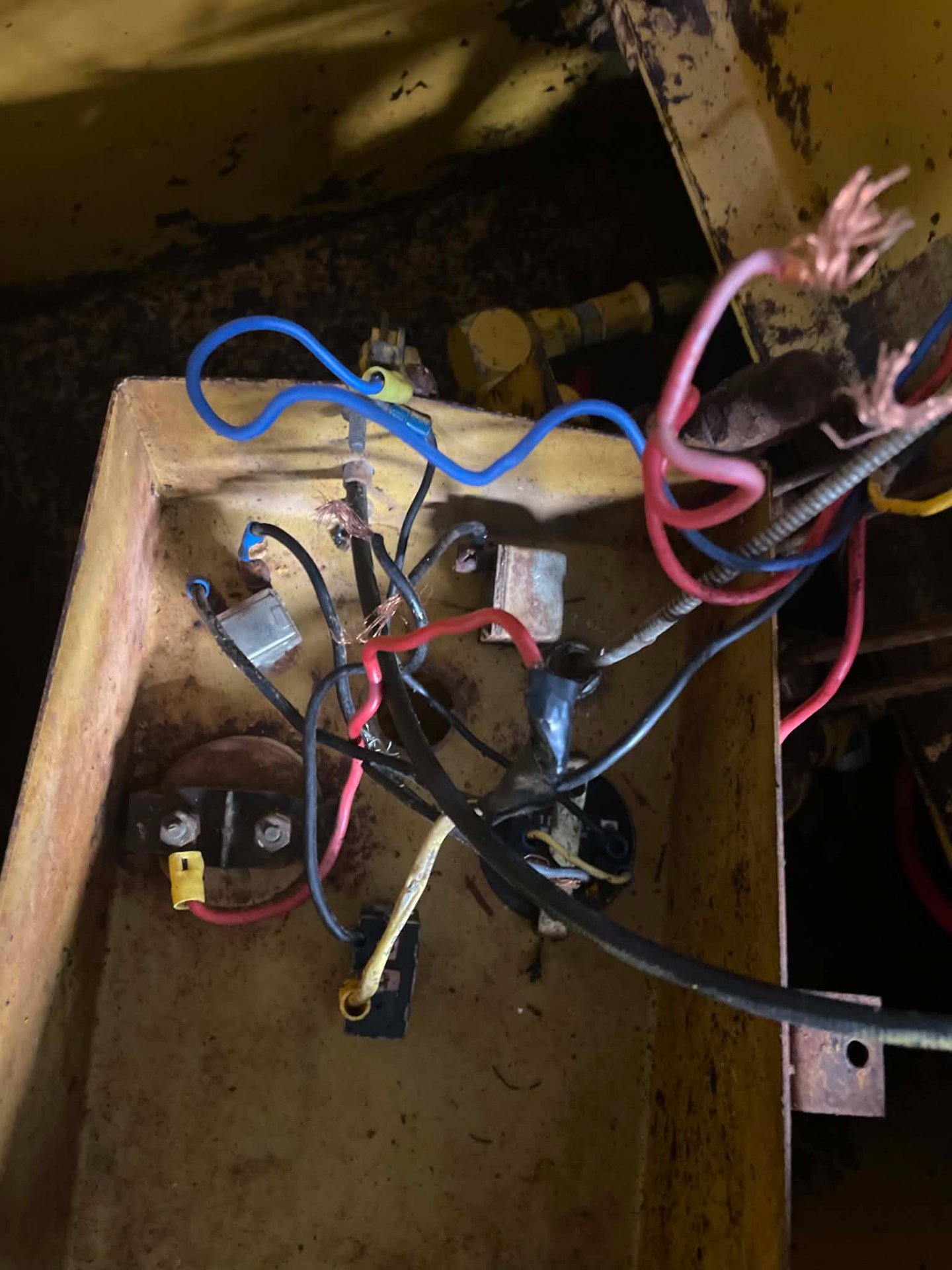

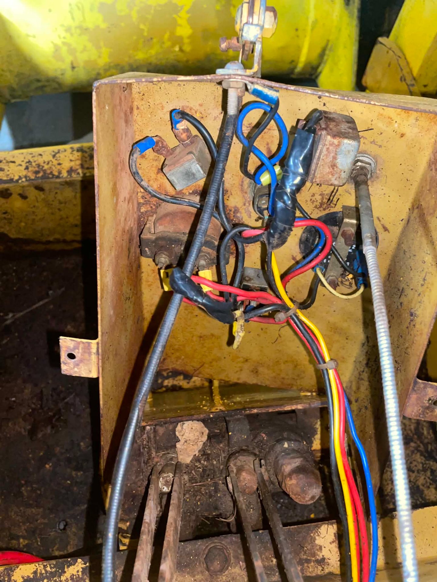

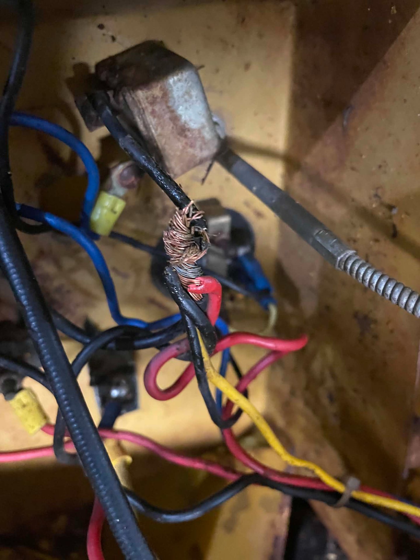

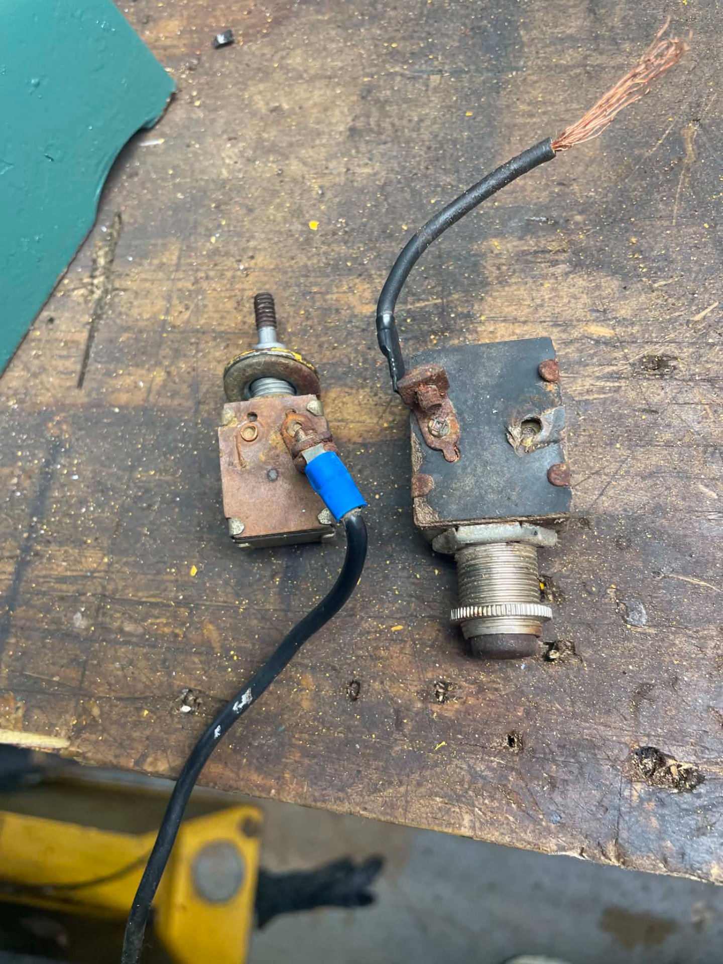

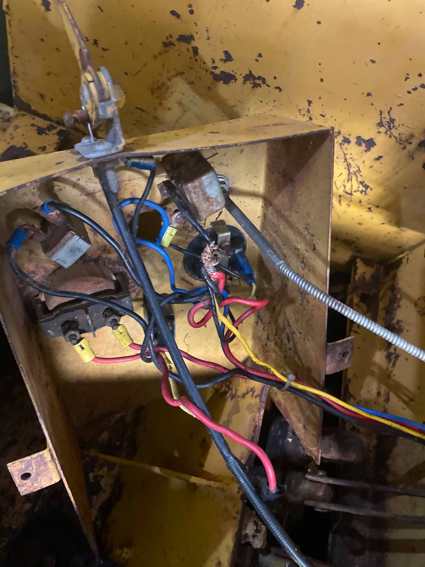

Today I replaced the deck belt on the zturn, then I started digging into replacing the key switch on the loader. The wiring was pretty butchered so I pulled the console off to clean it all up and do the connections properly... terminals on the switches were all rotted and broke off so ordering a few more replacements ( starter button, Light switch ) upgrading to weather proof switches.

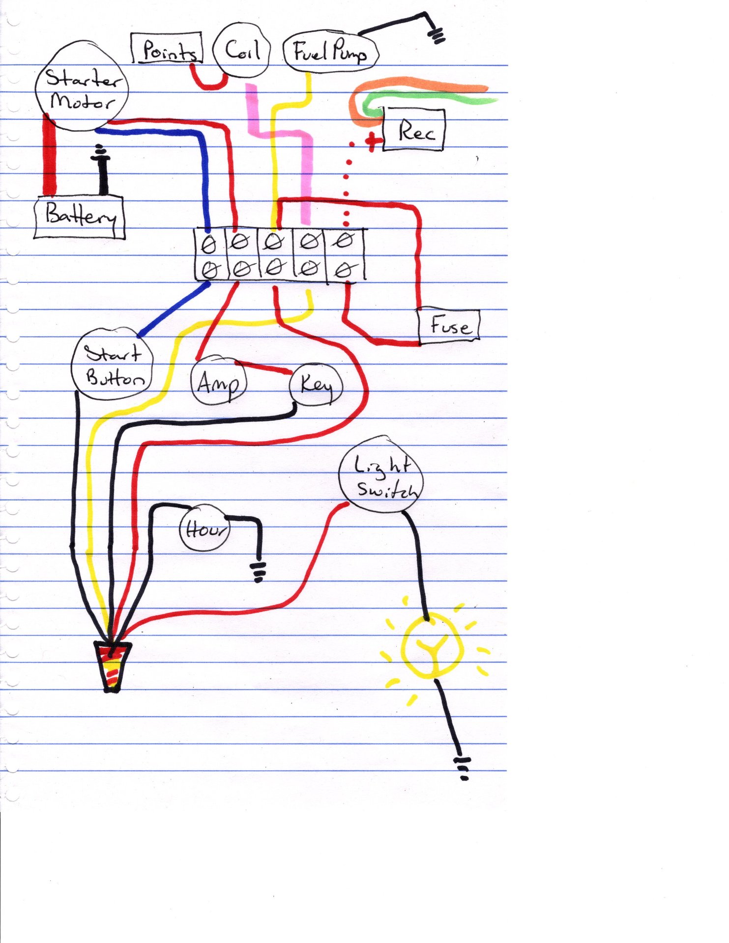

Question since I dont have a schematic or clean picture of the wiring for the console. All the wires are just grouped together and twisted at one point, and I wondered, if instead if it would still work if I wired everything jumping from one connection to another then splice into the main harness (if that makes sense) so like the wire from the amp gauge jumps to the key switch then from the key switch to the starter button then jumps from the starter button to the hour meter then connects to the harness wire instead of 3 or 4 wires all connected at the harness wire? *** not an accurate description but just for the cluster of wires that are twisted together in the pics.**

Tearing the console off to redo those rotted terminals properly instead of just re-taping them is the right call and the weatherproof switches are a nice touch.

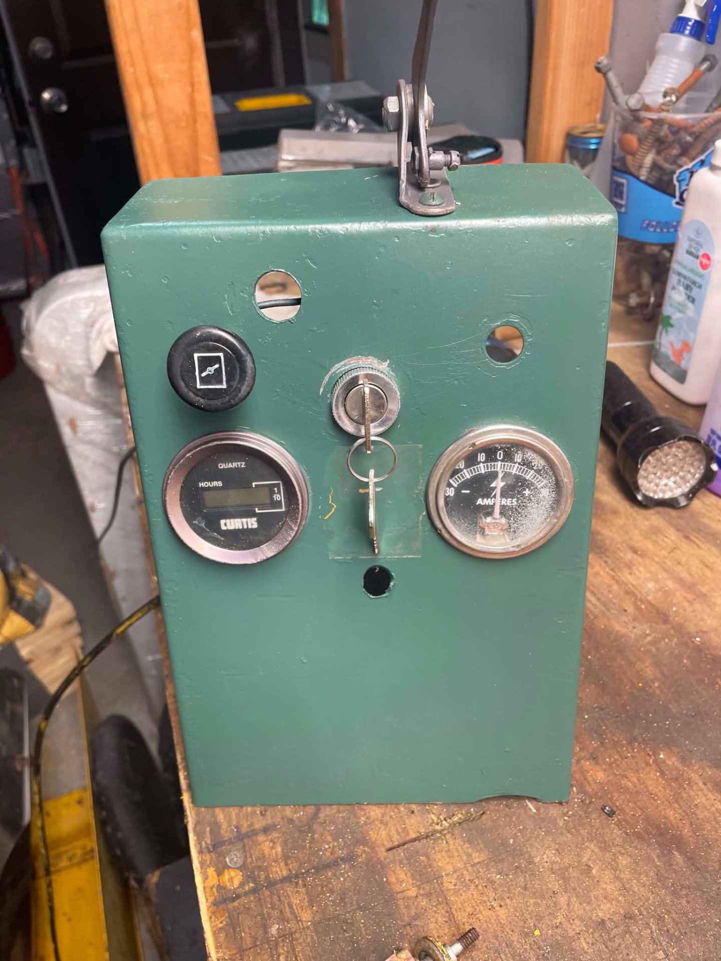

Agreed, besides the key switch was bypassed with a toggle, I bought a new key switch so its secured from unwanted tampering. The ignition switch would stick and the others were corroded pretty bad. As I tried to remove the switches the terminals were breaking off so I just decided to replace them all with new and clean up that rats nest of wires since there are some moving controls behind there that can rub the wires so I will put it in a loom as well for added protection.
