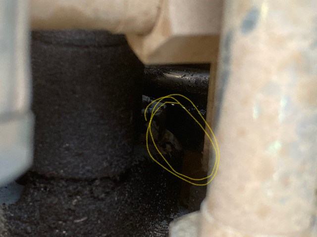

actually saw fluid drip from area in front of machine and noticed after running it for awhile that there was low fluid- pulled the inside access panel on Right side and saw fluid. Pulled the outside access plate and there is quite a bit of fluid- raised cab and started machine and I can see a drip from a bolt from the valve assembly (I think that's what this thing is)

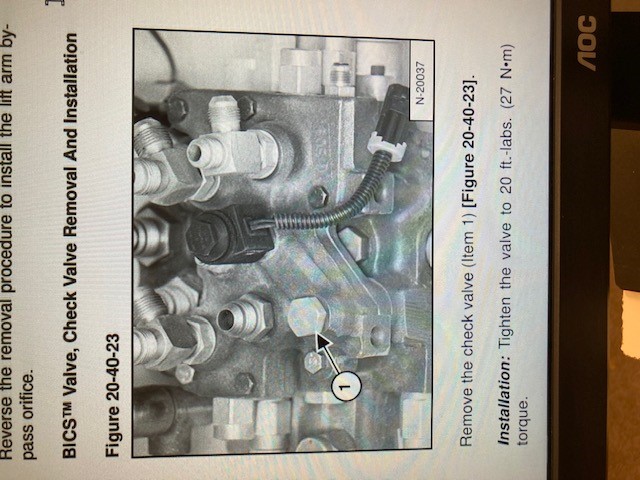

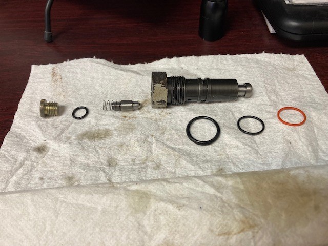

so i think it may be the check valve (bolt) from the control valve that is leaking- it definitely had fluid from the bottom of the bolt but was hard to actually look at it to document- t

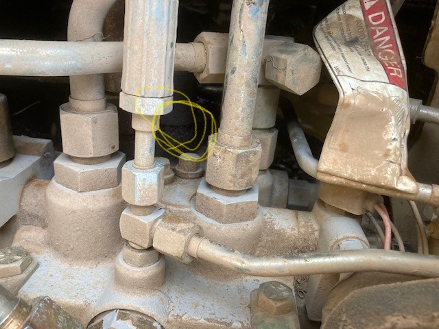

so now i am wondering if the one above (with the wire going to it) is leaking down on to it ?

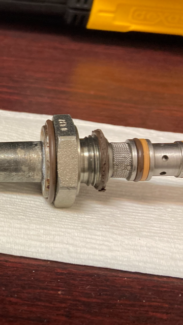

i took the solenoid valve stem off and it has a bad o ring. i cant find just new o rings for this stem only a whole complete new stem? any ideas where to get new o rings?

1,306
usually any shop that rebuilds hydro cylinders and control valves has a good selection maybe even a plumbing parts seller if you get lucky , remember to lube the o-ring with oil before placing it back in block to prevent tearing it.
