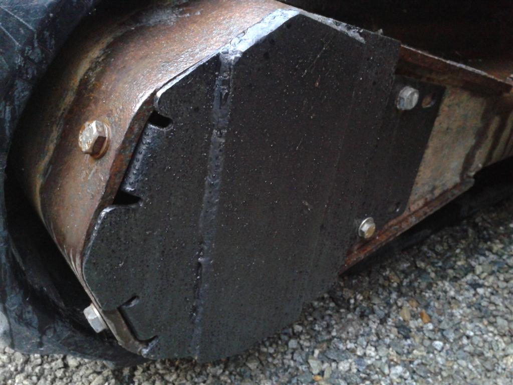

tahoe - even with tack weld, they managed to snap the weld and bend, albeit, they lasted longer. So, I got two pieces of scrap 1/4" plate and welded them to the cover....doesn't cover to bolt holes, but they are beefy now. Will see how they hold up. What I see happening, is the bottom lip of cover snags on a rock, and like a tin can opener, they peel a bit, then another rock or two peels the cover some more. I'll post a pic later...

Wish I had gotten a larger piece of metal, but I think this will do...if I slide onto a rock with edge, the cover will not bend at bottom...would have to bend whole cover, which hasn't happened yet... 2013-03-16 19.02.06 (Large)
Melli, I will probably copy what you did here - perhaps with full plate coverage. Looks good. Thank you for photo. Jim

Well, I've thoroughly road-tested my armour plated motor covers and they are holding up very well. Driven through loose granite (usual cause of bending cover plates) these last few days, and all is good.

Still flat, even after many hours on shot rock...
