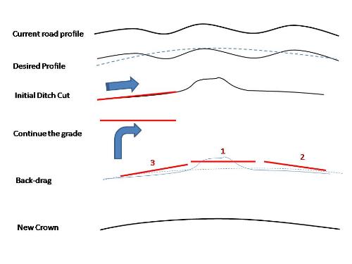

Sterlclan is correct. I'll give the same answer in a little more detail.
Your current road profile probably has a couple of tire ruts worn in at this point.
The desired profile has a low slope to drain the water to the ditches and not down the road. This keeps the road from washing out or wash boarding from standing water.
First you need to make an initial ditch cut. Start where you can get the loader in the ditch and pointed toward the road centerline. Cut away the shoulder and dump the soil in the middle of the road. Move over and do it again. Make two or three cuts so you have at least 12 -15 feet of roadway with the ditch shoulder at the correct grade and the spoil piled in the middle of the road in a windrow.
Drive the loader back on to the road and drive on to your current cut pointing the loader down the road. The loader is now parked on the cross grade at the grade you just cut. Continue this grade down the road cutting the shoulder and turning and dumping it in the center of the road.
Do the other side of the road and also pile the spoil in the center of the road. Now you are ready to spread. Straddle the pile and back-drag displacing the pile toward both ditch shoulders. Once you have it smooth, move over and put your left tires on the windrow and the right tires on the grade you cut on the shoulder. Back drag again to feather the center windrow out toward the shoulder. Repeat on the other side of the road.
Obviously this can be done with a grader more effectively or even a two way drag blade on the back of a tractor. A Tilt-Tach can speed things up a little but is not required. The Tilt-Tach allows you to make the initial ditch cut while leaving the loader on the road. It also allows you a little more control when back dragging.
