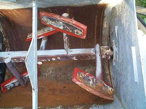

Here is another pic showing wear on paddles. At first I though he said it had mixed one yard, but then after I understood he had used it to mix one yard, First owner had used it ??? yards.
This is the second time it has been up for sale in 3 or 4 years, makes me wonder

I bought a used mixer of this type, looks to be homemade, does anyone have one of these scoop mixers?
Looking for pros and cons, I need to rework mine some and would like to cover all the bases and do it right.
