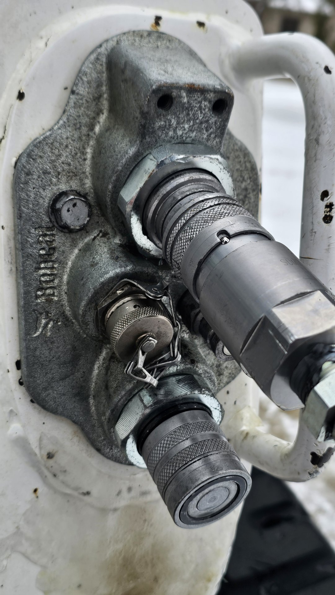

I'm borrowing a skid steer. I connected my attachment to it and didn't realize that the hoses are shorter than they need to be. So once raised the boom and tilted it forward it pulled hard on the connectors. The bottom came off fine, the top one won't come off. Any ideas of what I can do to get it off so I can return it?

There's no pressure on it as i have disconnected the hose from the coupler.
If it got stuck after it was pulled forward, maybe trying tapping it back in the opposite direction to free it up. try rotating it while tapping it back. the balls inside the coupler body may have gotten jammed up. Feel free to soak it down with your favorite penetrating oil.
I would make sure that all the hydrulic pressure is off by cracking the hose to coupler , 2 tap it back in and disconnect, then I would go and buy a new coupler for the machine as the little balls have possibly damaged the coupler creating a bur internally, that way I could return the unit in the same condition as I received it.
I have seen this happen where I worked also skid steers that had hydrualic hammers would wear out the quick connect couplers, they would also break internally and act as a check valve when you would go to operater the auxiliary function, and the littler balls that would retract to make the connection woud hammer in to the collar and bur up to where it would interfer with coupling and uncoupling and I have seen couplings damaged the same way by hoses getting snagged and had to replace couplers.
Nothing would work. Short of taking a reciprocating saw to it, I opted for just taking the fitting off the skid steer and replacing it.
