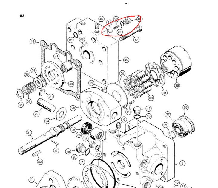

F Freddie New member Joined Jul 23, 2023 Messages 2 Jul 23, 2023 #1 Works great going forward but right side won't back up. Belts are super tight when engaged. How do I fix this?

R River Fluid Power Well-known member Joined Aug 18, 2022 Messages 168 Jul 27, 2023 #2 The circled part is a check valve. Each pump has two (one each for reverse and forward). It is possible that it isn't seating properly, or that the o-ring under the end cap is leaking by. Do you know if the drive motors are original?
OP OP F Freddie New member Joined Jul 23, 2023 Messages 2 Jul 27, 2023 #3 Yes they are I bought it new. It only has 468 hours
