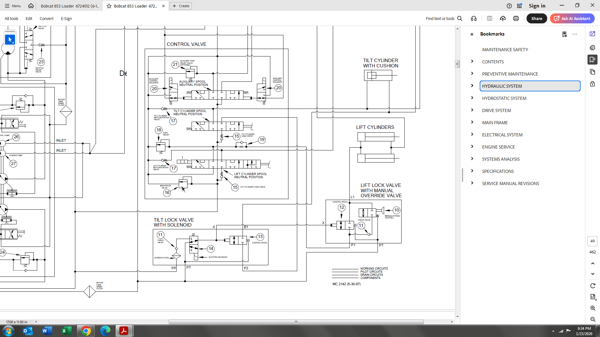

Bucket tilt ok up/down not so much
Im starting to wonder if its in one of these 2 areas, lift/tilt lock or boom man release.

I googled the Bob cat 853 and it does have a float postion, if the linkage is not set correctly you may not have enough travel in the peddel to get the valve to the float postion, I did see that there is a place in the manual to adjust the linkage and you may need to review that to make sure it is adjusted correctly.

I do have a lift pres relief coming, should be here mon/tues.....even with leaking on 1 cyl i would think it should still go up, so the PR would make sense
My 853 has a float position. Works really well. When I replaced the seals I disassembled the float mechanism (although it operated fine prior) and installed new ball bearings under the cap. Old bearings had a flat spot as the grease was gone so they became fixed in place essentially. Either way, that function I don't think would cause your symptoms. Frustrating for sure though.
Changed the lift PR valve, still doing the same thing
What I did notice tonight having it out in snow is it is bleeding somewhere, it leaves little puddles when it sits running, that I’m going to have to track down and find the source of. I believe that could be a major contributing factor. I’m also going to rebuild the lift cylinders in the next few days I will keep you guys posted
Another thing I noticed is after it sits a lil while it’ll work again for a few cycles then get lazy. This leads me to believe and am totally convinced the oil is getting airated, when the bubbles dissipate out of the oil after sitting it’ll be ok again for a few cycles till it gets foamy/bubbly again. Now the challenge is to find out where it’s coming from. I do know the left lift cylinder is leaking internally. Could that fluid rushing past the least at high pressure be enough to cause it to cavitate ?? Maybe maybe not…. Is the external leak allowing air to be introduced into the system ?? Maybe maybe not…. Gonna have to dig and find out. It’s so cold here it’s making doing anything miserable. I need to turn the heat on in my garage almost a day early to be able to do anything.
