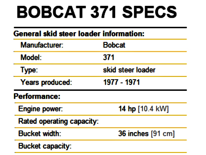

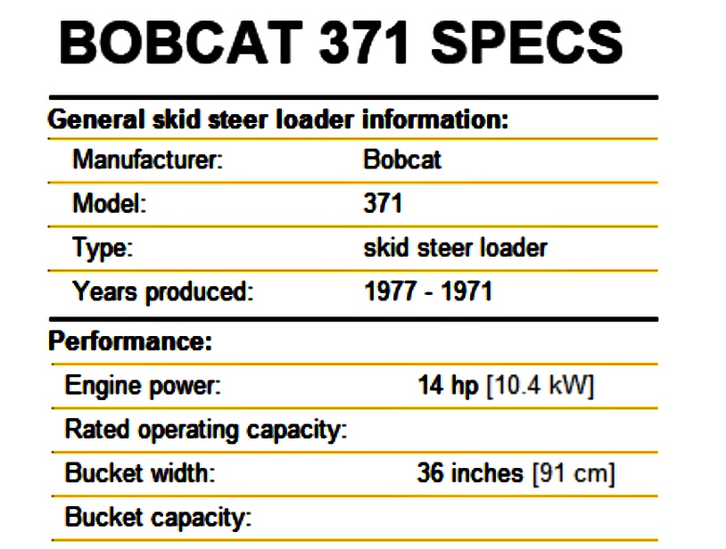

OK the spec's on your machine are as follows,
so, you can use any sized bucket, but you need to subtract weight of bucket from lift capacity, heavier the bucket the less material you can put in the bucket
so if you have a 40 inch bucket that weights 200 lbs you can put 300 or so LBS of material in it, , if the 48 inch bucket weights 300 lbs maybe an(extreme example) you have a 100 lbs of less material it can lift based on OEM spec's!
think of things like this, you can use a 48 inch bucket and fill it fully if your lifting/loading LIGHT material that doesn't surpass lift spec;'s
same with smaller bucket, you can lift what the machine is rated for
and YES well ALL go past OEM spects at times, but repeated lifting is PAST spec's is where issues stsrat to show up and or damage to machine or worse an operator!
the wider the bucket, the more side hill unsuitability will be when lifting as well
  • Manufacturer: Bobcat
  • Model: 371
  • Type: Skid Steer Loader
  • Years manufactured: 1971 – 1977
  • Engine power: 14.0 hp – 10.4 kW
  • Rated operating capacity: 500 lb – 227 kg
  • Bucket width: 36 inches – 91.0 cm
  • Bucket capacity: Depends upon size of bucket attached to loader
and a link to this and more info for you on it

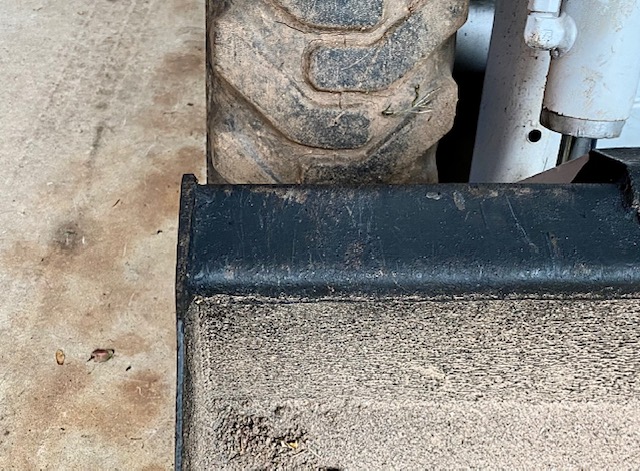

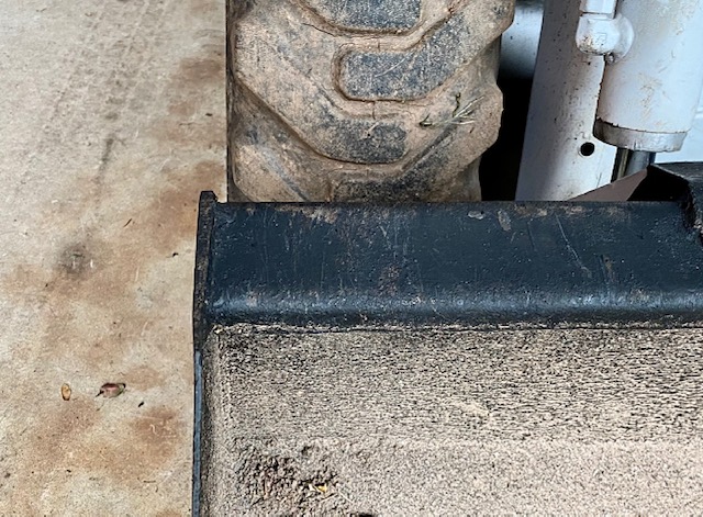

Not to beat a dead horse... but this seems to make no sense to me.
The M371 came equipped with a 36" bucket according to replies here and this page off the internet.
But the machine is just under 41" wide. The bucket on my machine is 41" wide so a tad wider than the machine is.
This would seem to be how it should come... not 36" and be less than the width of the machine.
Say you need to dig a shallow trench to move water away from an area. In fact, one of the jobs I need to use my M371 for is just that. They're called water bars and they're shallow (at least 6" deep) ruts dug into the slope of the land at a 30 degree downward angle to direct the rain water off and to the side where it can drain into the ground. Often they are filled with large size trap rock so you can easily travel over them.
If the bucket is less than the width of the machine as soon as you reach the tires you must stop and dump that bucket no matter how full it may (or maynot) be.
If the bucket is wider than the machine you can just keep moving forward until the bucket is full.
Am I missing something here?

It looks like you have wider tires than the machine originally came with. The machine with the original size tires is only 36” wide. These machines were designed to go through tight spaces like doorways and fence gates.

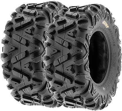

Wonder if there is a "best" tire for this machine?
How much different are they from what is used on ATV's. There are some very grabby-looking tires made for the ATV market at about half the cost so if they will fit... and hold the weight... might be something to look into.
Just as a for instance.
brdgbldr
Jun 1, 2012
1,027
Good pneumatic skid steer tires are made for weight capacity, puncture resistance and the rubber is also harder so that you don’t loose all the tread when turning. For example the tires I am running right now are 14 ply. This makes the part of the tire without the tread thicker. My machine is 9000 lbs without carrying a load.
So the main thing to look for in a tire is to make sure it can handle the weight of the skid steer fully loaded.
A cheap tire is just asking for trouble. If the tire is incorrect you could actually peal the tires off the rims when turning.
