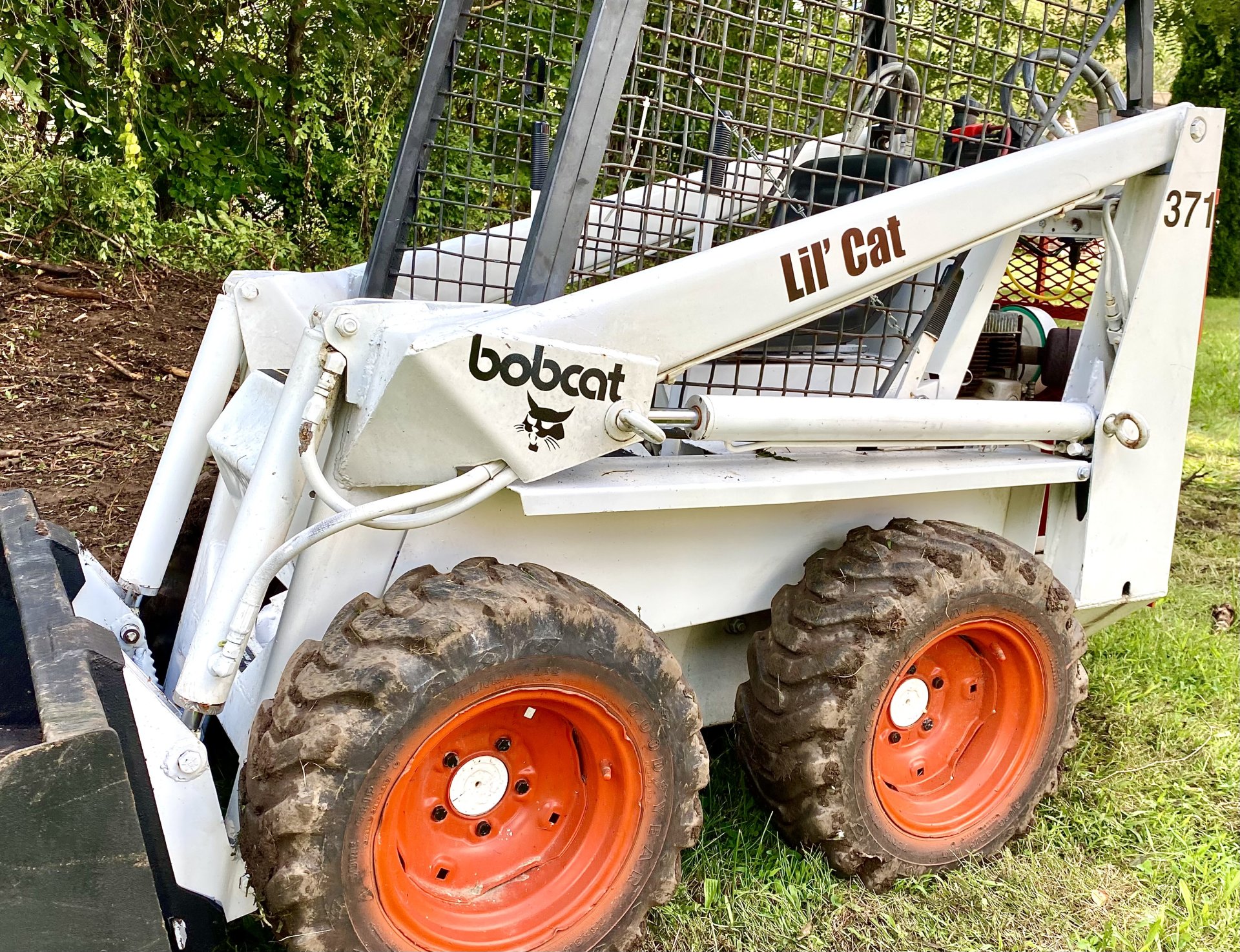

What is meant by “flotation tires”?
Are these them?
Also, regarding inflation. Is it better to run them a bit lower for better traction?
Floatation tires just refers to wider tires.
If you run the tires on low pressure the machine normally has a tendency to buck/bounce more. Also, low tire pressure can damage the sidewalls of the tires If you are not careful.
With floatation tires (8.5x23x12) that machine is right about 42” wide so the bucket could be factory. A picture of the back of the bucket would help.
