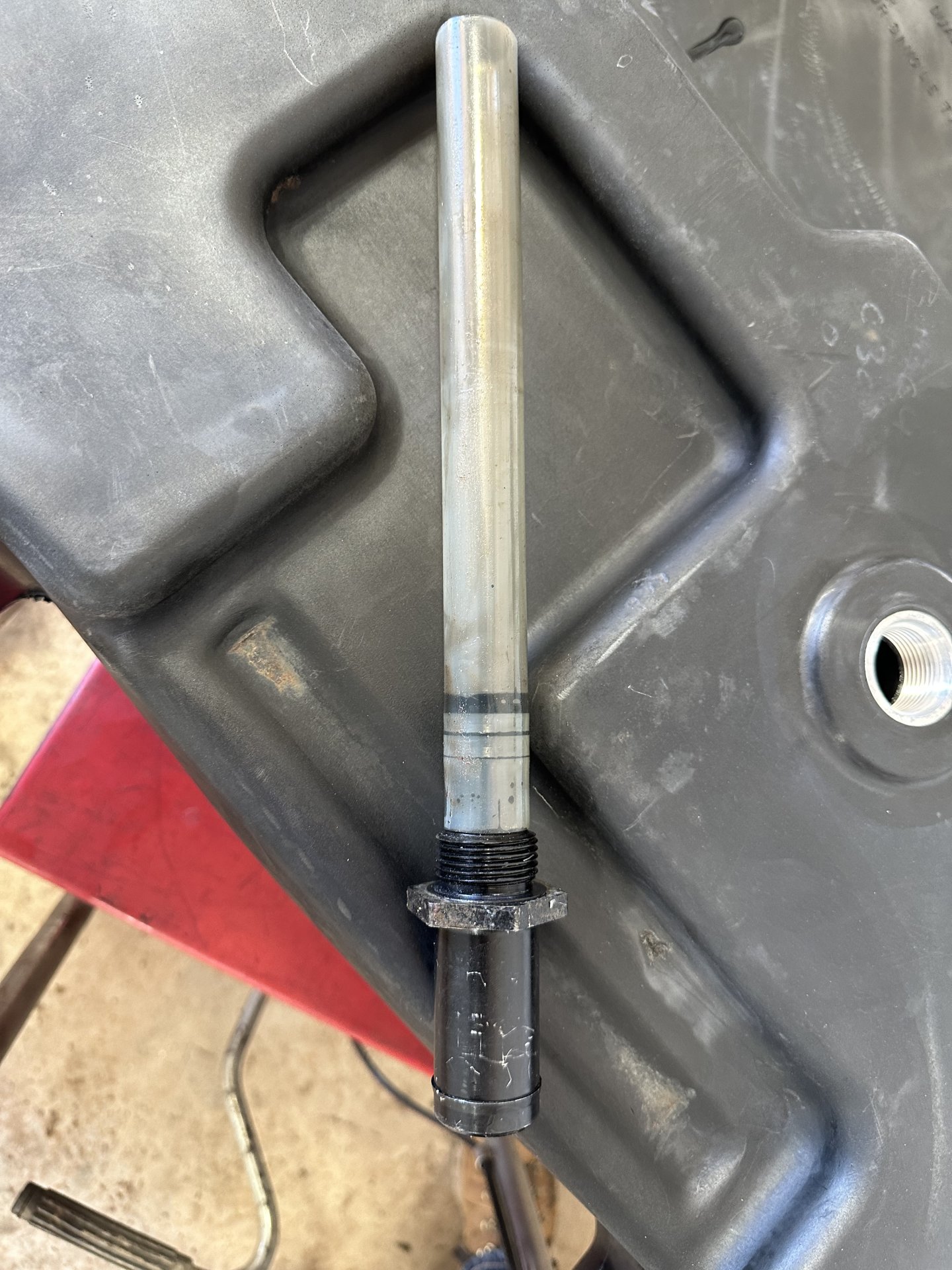

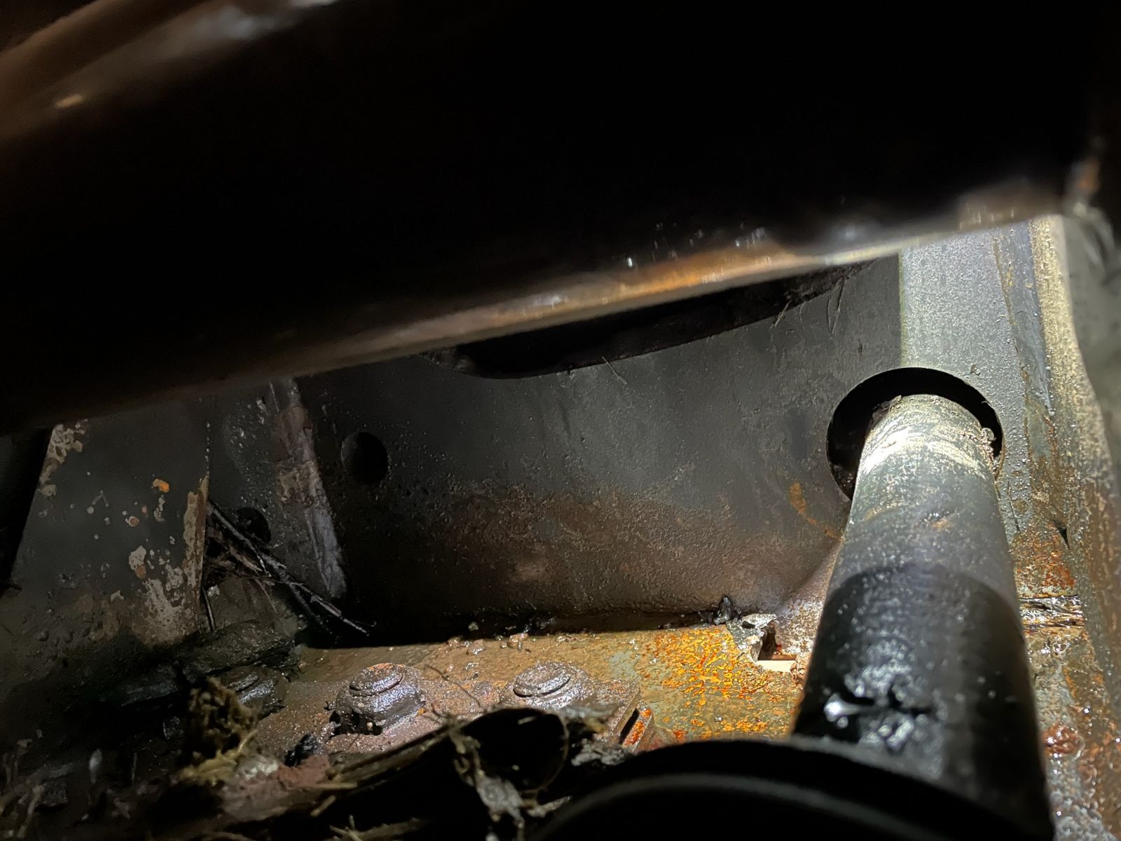

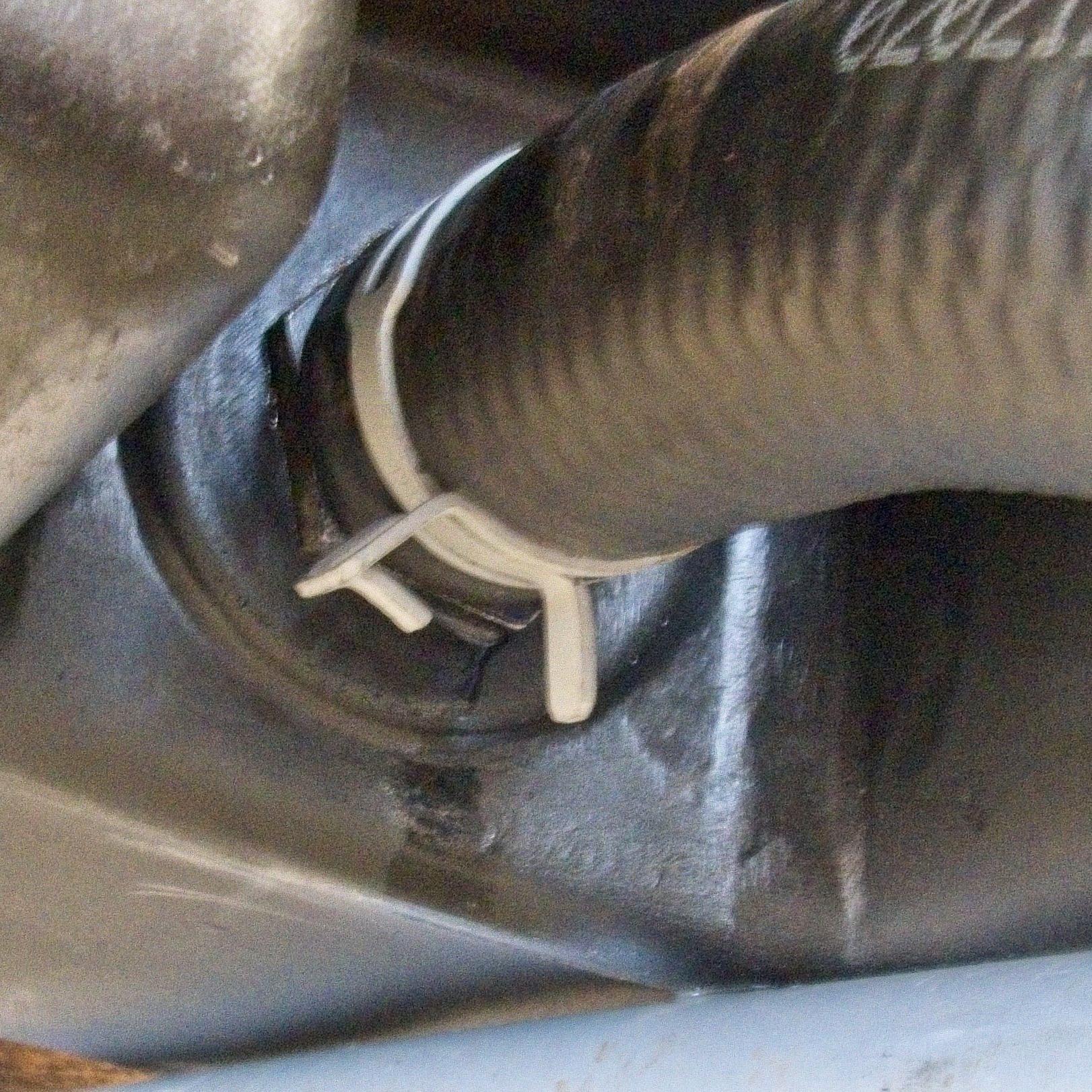

Two pictures might help others to see what is going on with main tank and pipe.
Large rubber fuel line coming from auxiliary tank, going thru bulkhead to main fuel tank located under motor.
Clear tube with metal pipe screws into main tank's metal insert.
Black pipe end would have large rubber fuel tube (pictured above) leading to auxiliary tank.
(Ignore metal insert next to pipe, it goes to different connection)

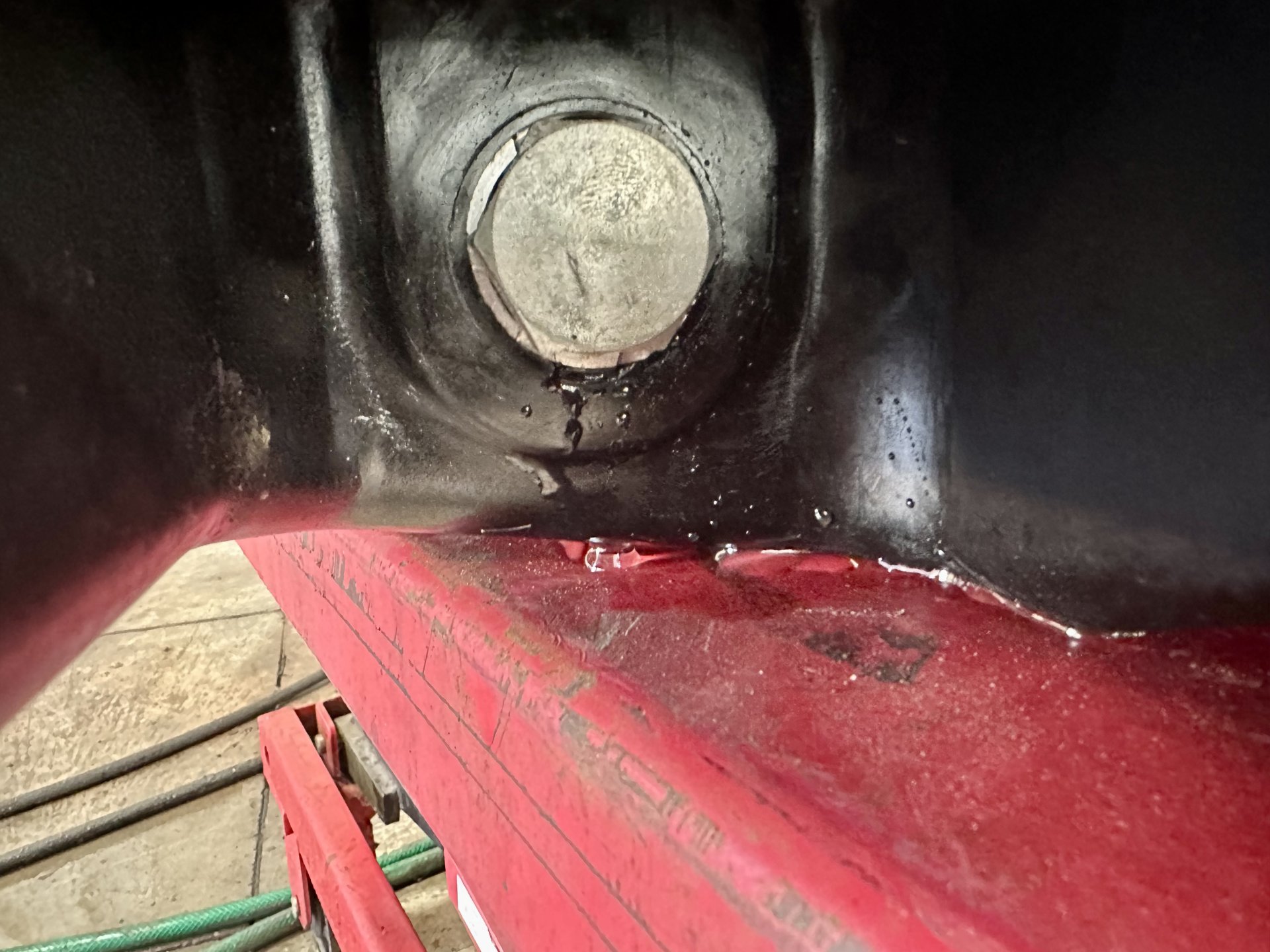

Pictures showing 1st tank leaking water and it's replacement recently leaking water.
Shop put a new O-ring on pipe plug to make sure water wasn't leaking between metal insert and metal plugs threads.
