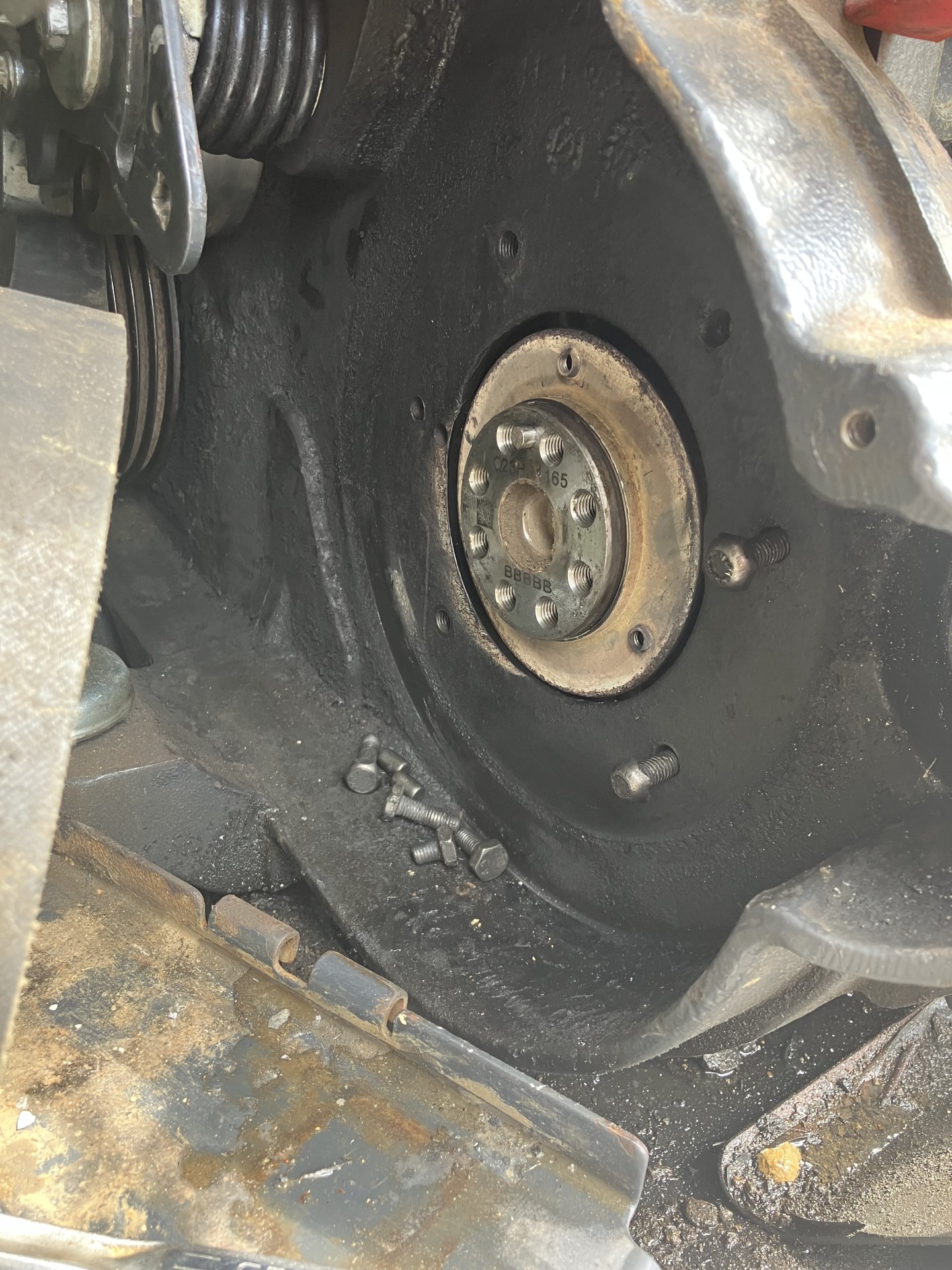

I have a bigger issue. I took the flywheel off and all the bolts that hold the bell housing to the motor have backed out. There were 4 or so in a pile behind the flywheel. I think this has to be the audible friction in the flywheel.
The holes at not lined up from the bell to motor and mounts will need loosened and it pryed back in alignment to run new bolts.
I am afraid of seals going back as a result of this but really do not want to tear off the bell housing. I am also afraid that some of the holes are egged out from the bolts hitting off the flywheel.
My goal is to put the housing back in place and run new bolts that may need the holes raced and lock tite them heavy. Then put it back together. I don't have leaks so this seems to be the short term solution
Do you know the extent of this damage? And possibly the best course of action to get her back running?
Below is a picture of what I saw behind the flywheel, there are two guide pins back there that don't seem to belong to the flywheel?

Your rear Main Seal from the Crankshaft is already leaking, thats what the whole black oil is there. I would also get all new bolts. You might have to pull the engine/pump assembly out of the machine.
Ok, thank you very much! Do you know what that cover is over the seal? The cover does not bolt to anything and rides on the crank shaft, and gets hot! I took that cover off and the seal itself is seeping oil slightly, I have not lost oil in the machine significantly.
I would like to see if I can patch it up for now, run new bolts, and monitor for leaks. I understand that it may not work and then the job gets big, I would atleast like to drive it to a better spot to have the work done.
I do not see all the black oil that you are mentioning, we did spray wd40 behind the flywheel to see if there was a reduction in the friction noises.
So if you took that dust cover from the rear main sela off and the seal is leaking, that is engine oil leaking. You could wait and just finish your job but keep an eye on your engine oil level!
