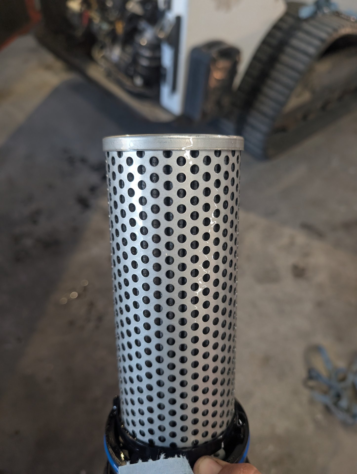

Check your Main Hydraulic Filter for Debris, best take a picture and post it here.
I should have also stated we changed the one on the fan and the cartridge filter before we filled it back up, does that make a difference or should I pull and inspect again?
I do not see debris, the fluid looks clear

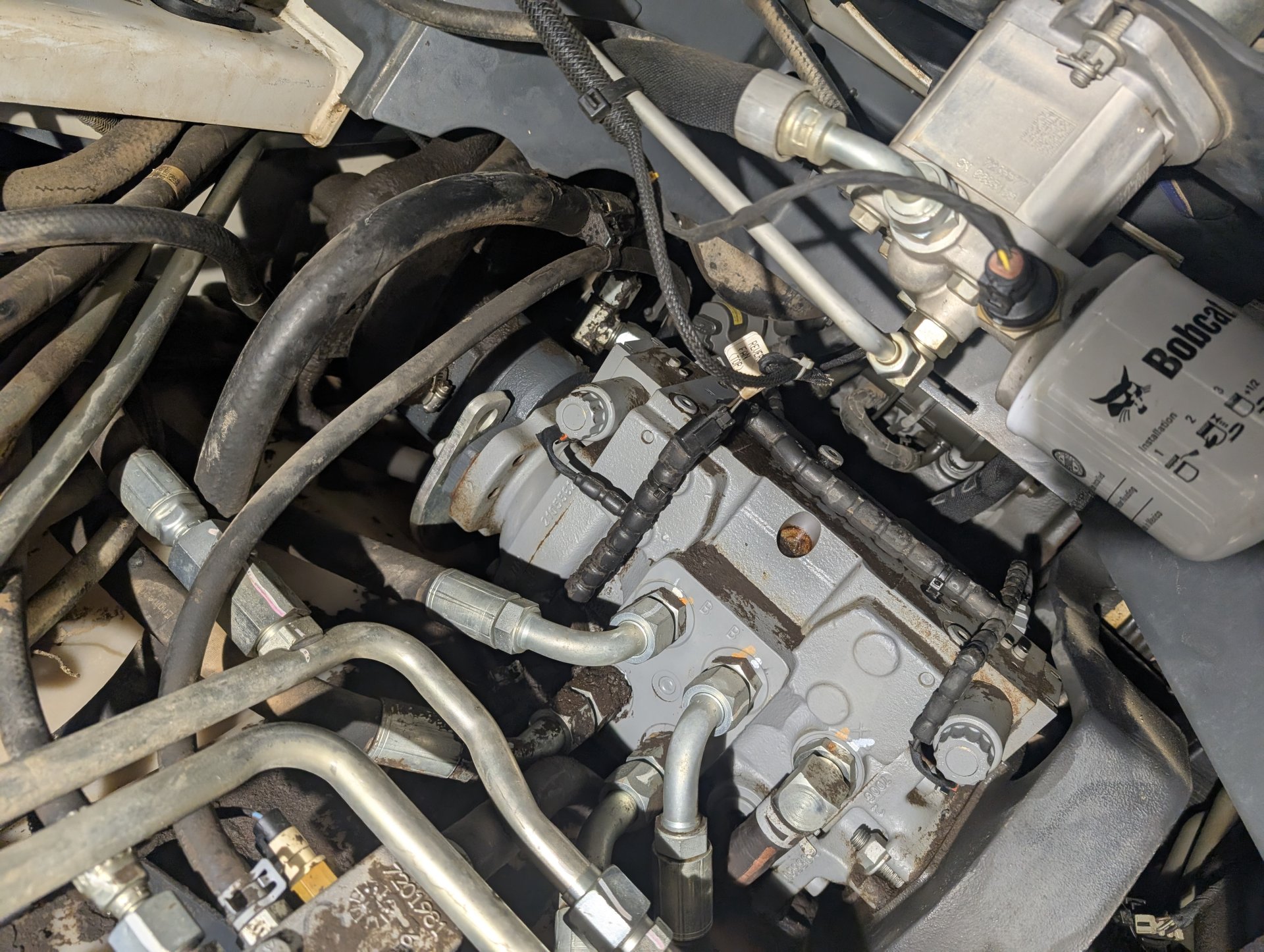

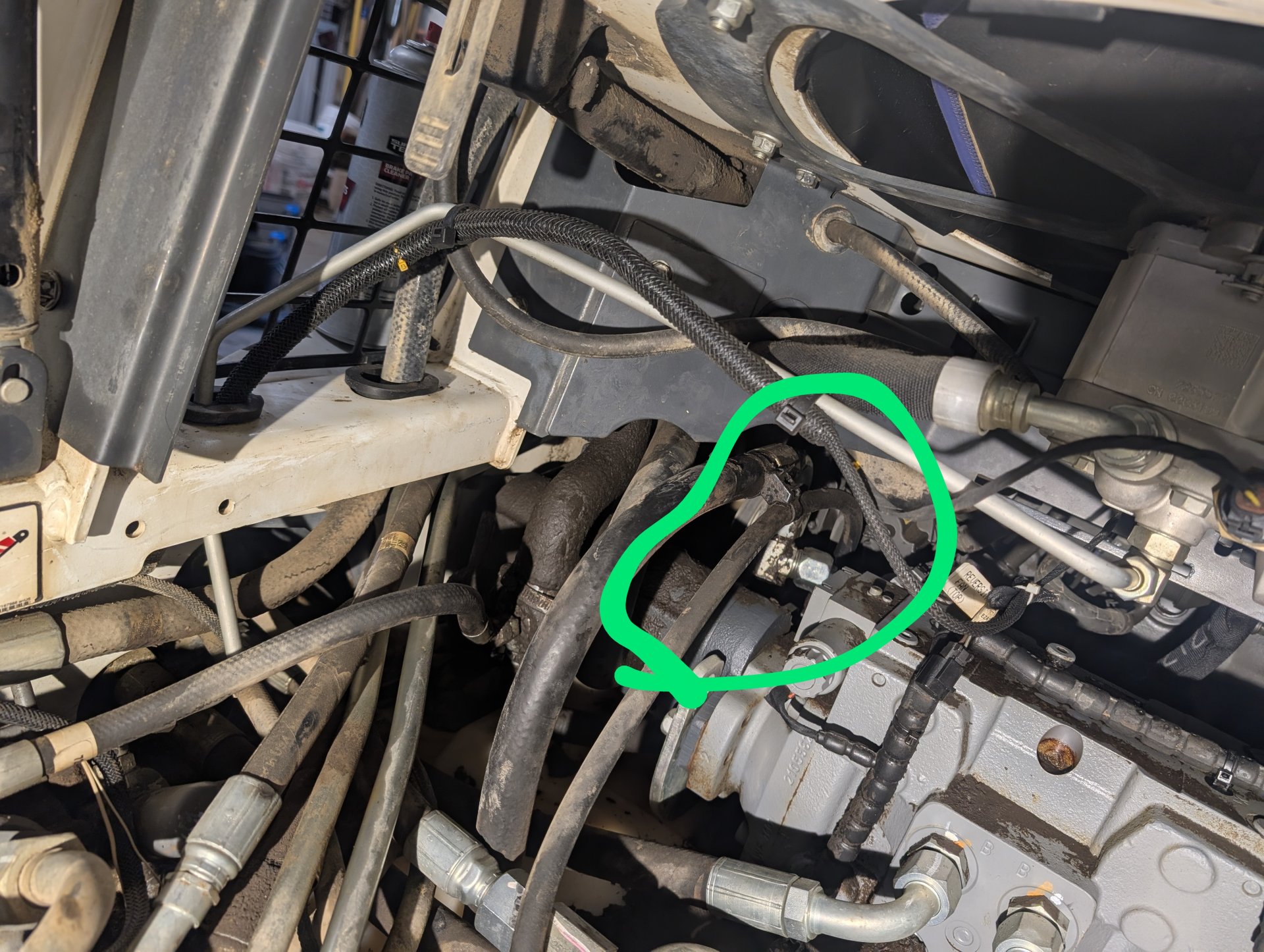

OK, did you replace the T-=Fitting with a straight one, I think the replacement part number is 15KB1212.
Did you had the codes with the swash plate before? Did you check the pump harness? Specially underneath the pump, there are the swash plate sensors.
We did not have any codes before the hydraulic leak. And No we did not, we took the cap off the end of the house and mounted it to the side of the T fitting eliminating the leaking hose. the local bobcat shop said it would be fine and just might be slightly louder. We have not but will inspect the harness for the swash plate sensor
So the picture is for or after the repair of the fitting?
