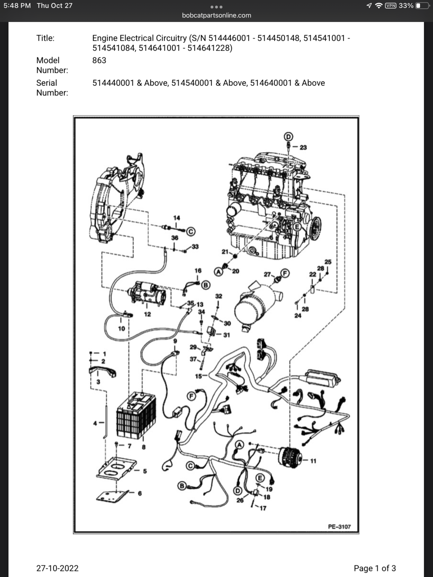

In the first screenshot number 31 is your “THERMOSTAT, engine oil temp.”

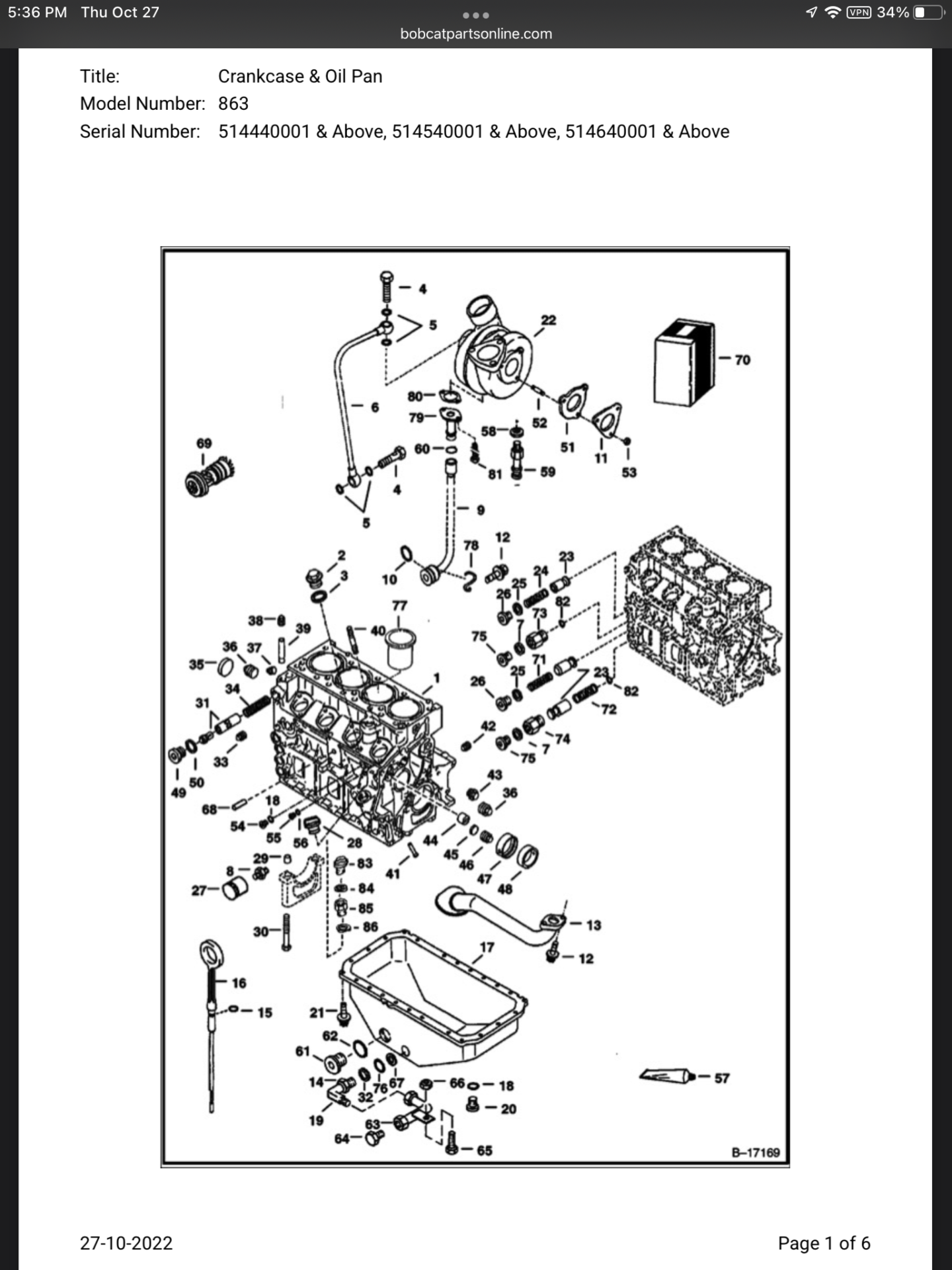

In the second screenshot number 36 is your “ENG TEMP SENDER, engine
temp”

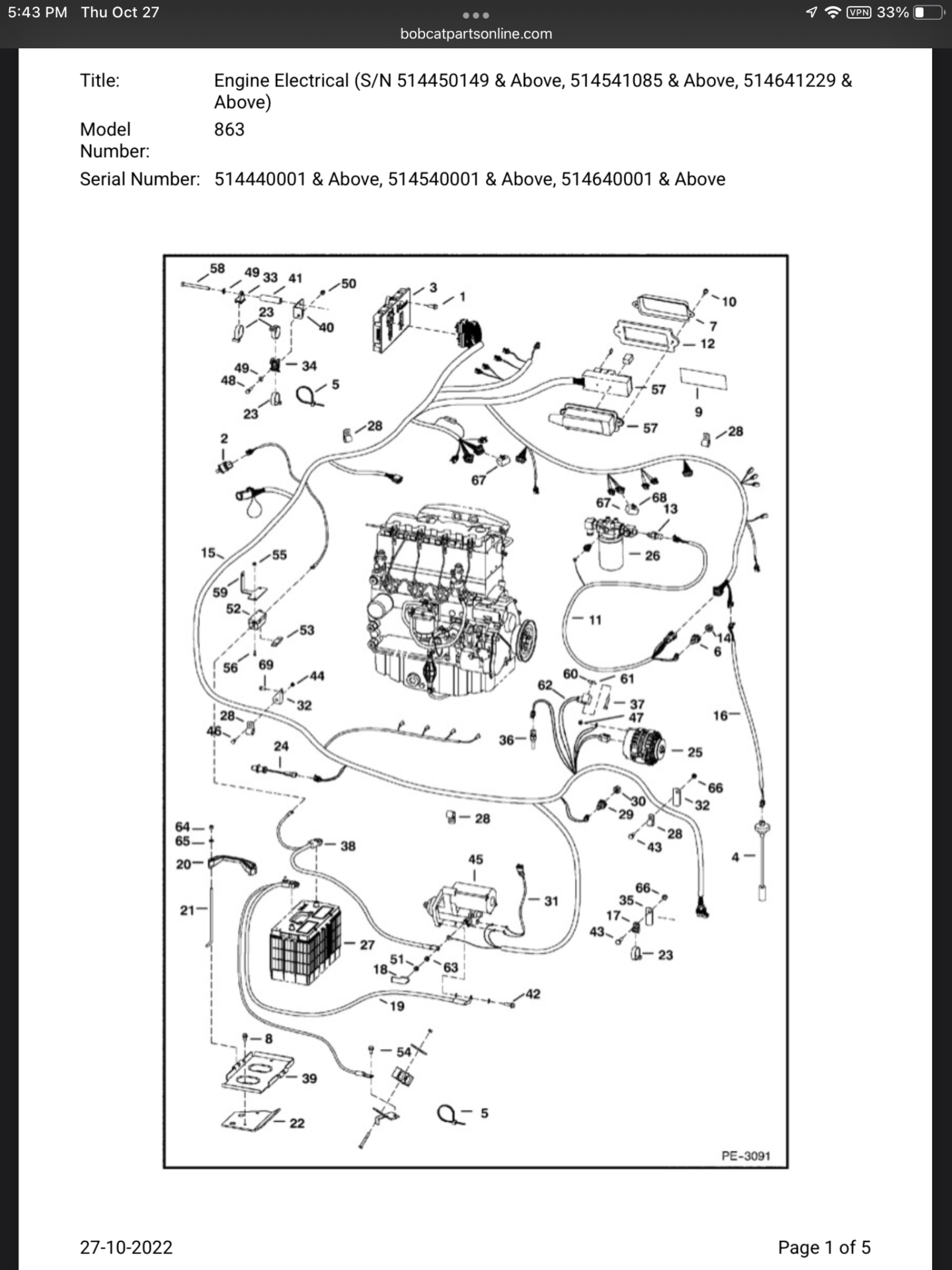

In the third screenshot number 23 is your “ENG TEMP SENDER, engine temp”
I think you mainly want the third screenshot.
These can all be found with more accuracy with your serial number here:
https://www.bobcatpartsonline.com/#/catalogBrowser
Hope this helps.
