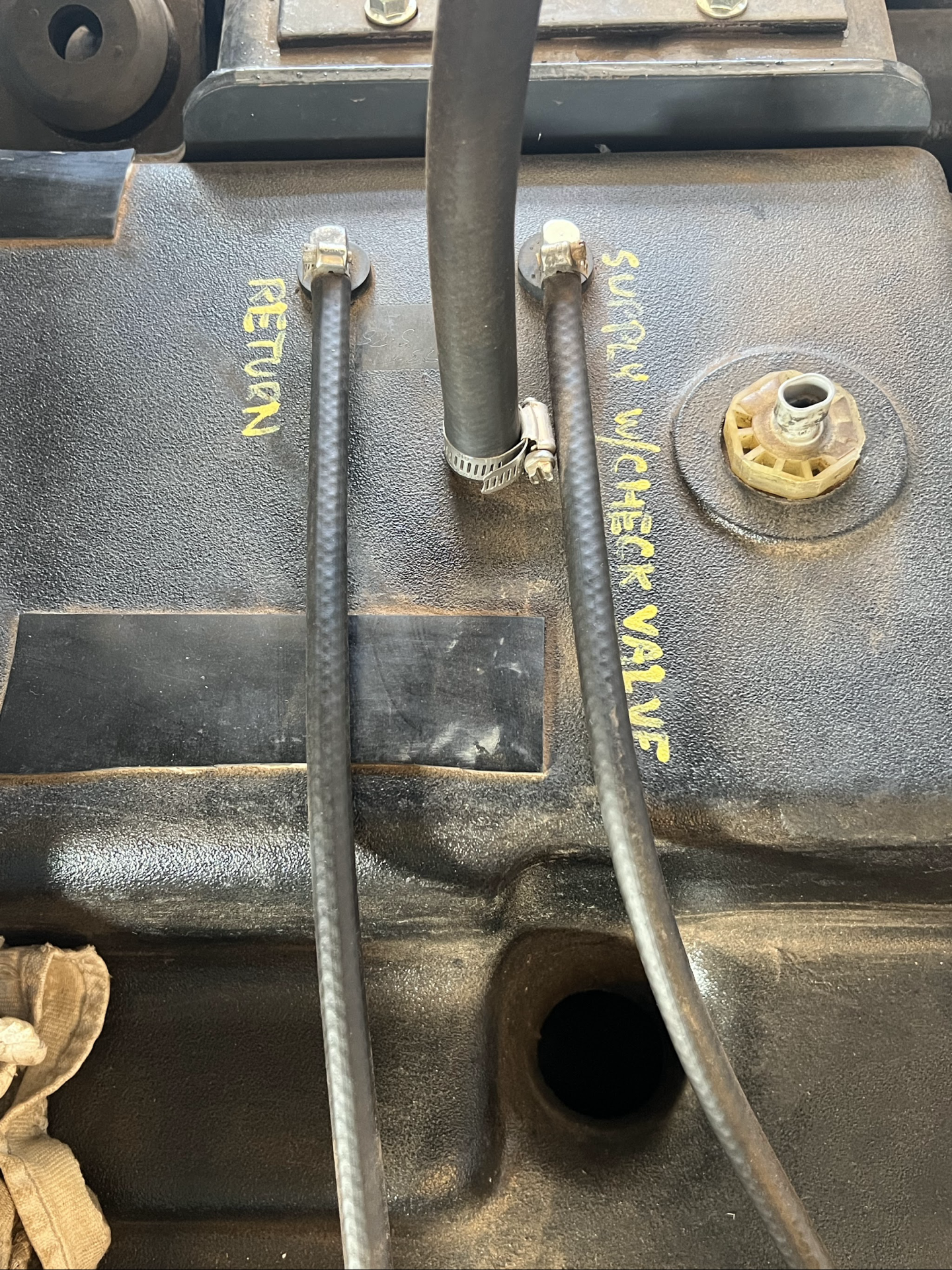

I did change the in-tank return line on mine. At first I was going to blow it off, because I thought what difference does it make if the fuel splashes into the tank or not. Somewhere on the site I read about eventually losing your fuel prime if there is an air gap.
I wrote the note to myself about the check valve in the hopes that down the road nobody tries to clean out that line with compressed air.

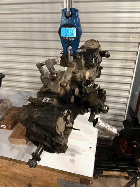

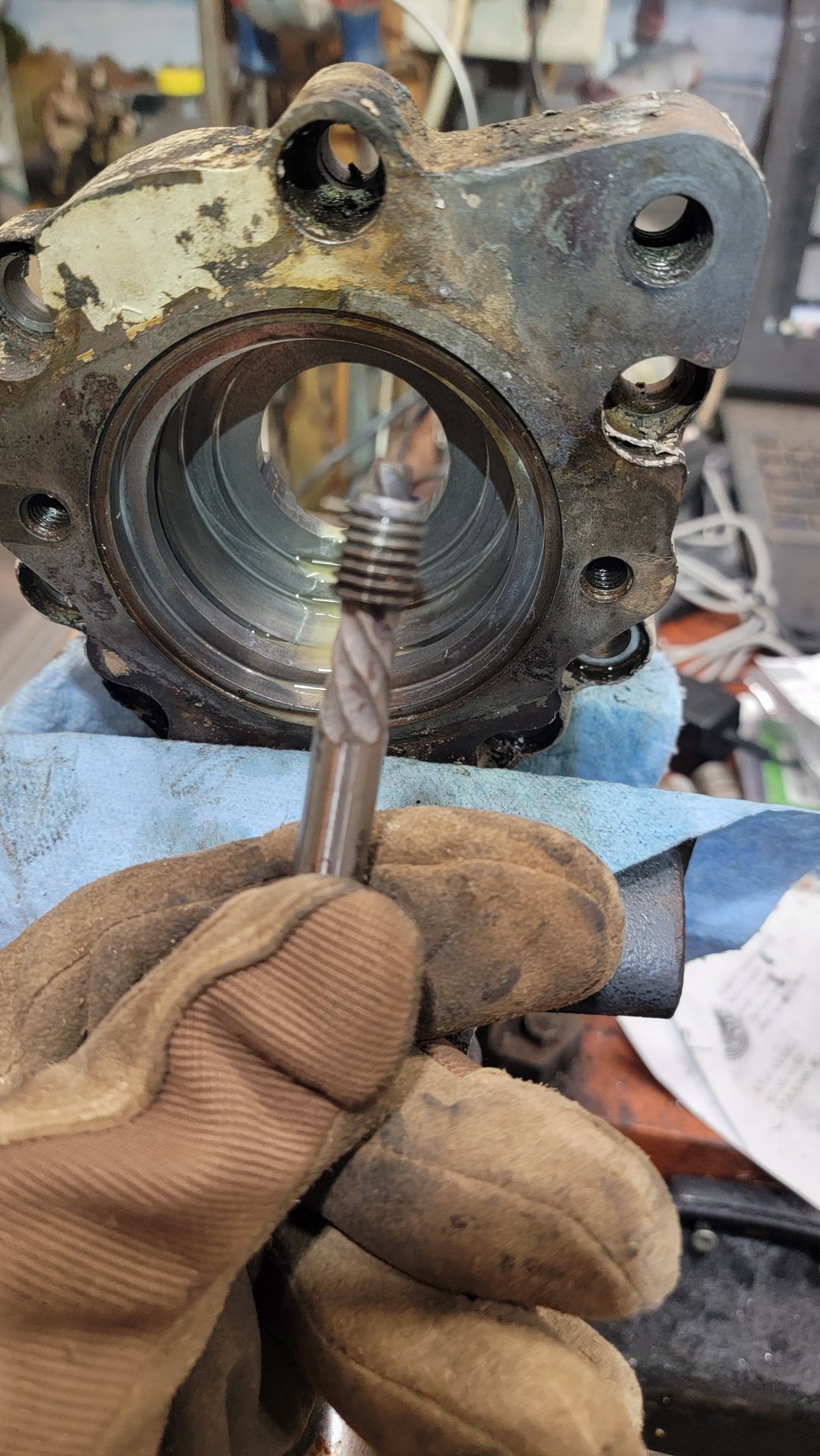

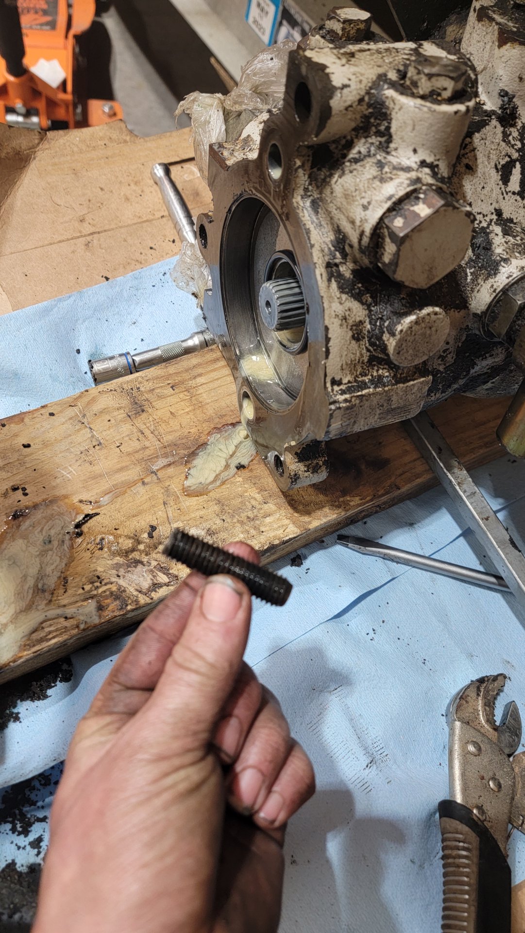

Thanks to this forum My 853 is back alive! No major issues putting the pump back together and the engine back in. The M46 pump gasket kit I bought did not have the correct O rings that go in between the right and left side pumps so I had to order them directly from bobcat (as well as the two replacement broken bolts) all this work for two broken bolts! The gasket kit did have most of the other correct O rings and gaskets.
For anyone doing this, it took me about 8 hours for the engine removal a few hours to mess with the pump and then about another 8 hours of it going back in. I did all the work by myself, there is not much room for another person to help anyhow. Also the fancy engine hoist is very nice, but if you only had a forklift that would work ok to pull the engine. BTW, that hydraulic pump is HEAVY!!!!!!!!! I make a makeshift stand for it and lowered the engine/pump down until the pump set on that stand then I took if off from the engine.

One question. I bought a new fuel pickup line to replace as was mentioned earlier in this thread. But it looks like there are actually two? One for the primer ball and one for the other fuel line? Should I replace both pickups or just the one (and which one?) I have one pickup line kit now that I bought and it does have the screen at the bottom which seems to match the diagram for the fuel line that has the primer ball. Is that the main one to replace?
Yes the one with the dip tube and screen is the fuel supply replace that one the other is the return and has no dip tube on it it just free returns fuel to the tank. Look at the manual diagrams to see which is witch.
