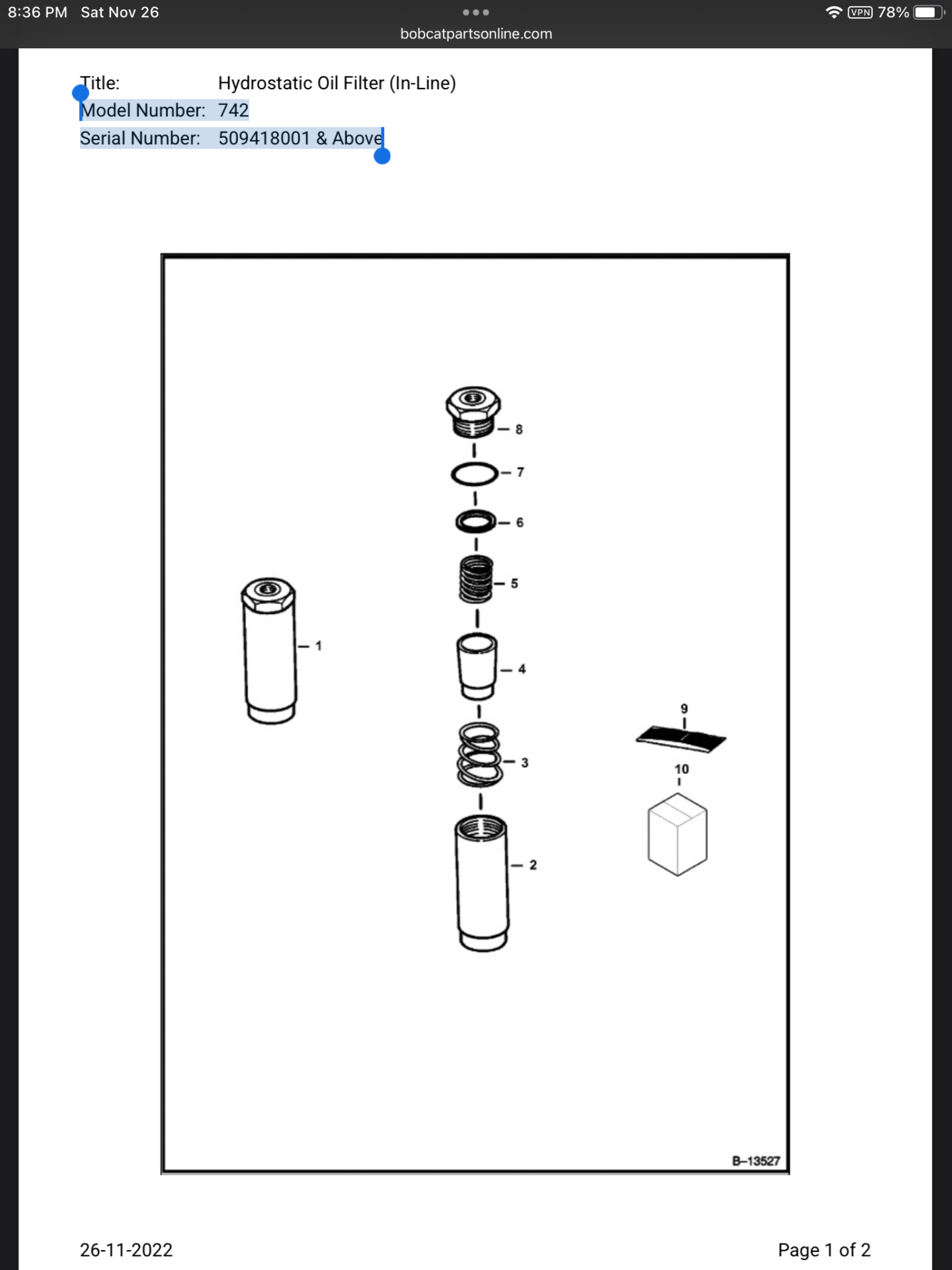

Here is an exploded view of one:

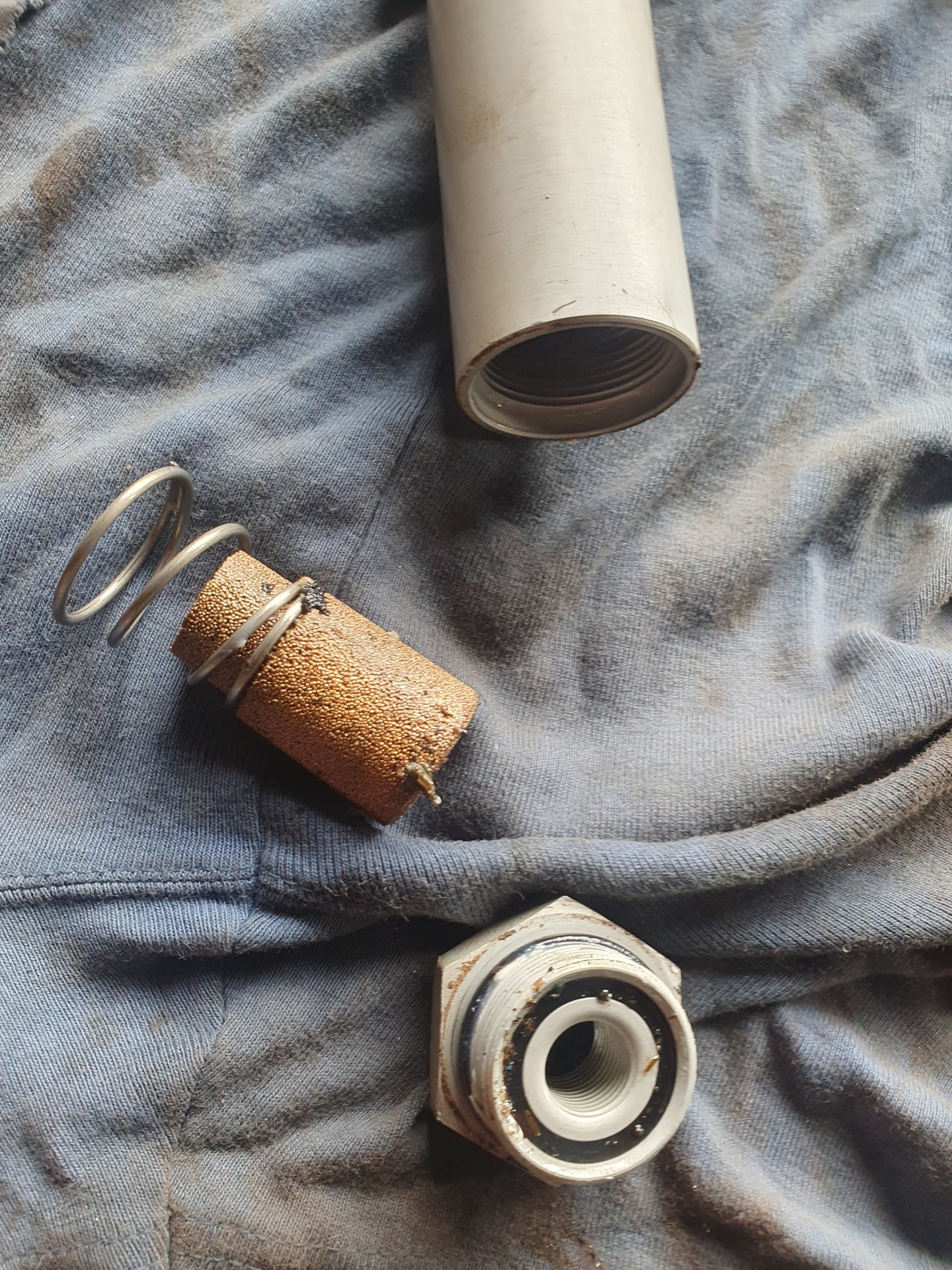

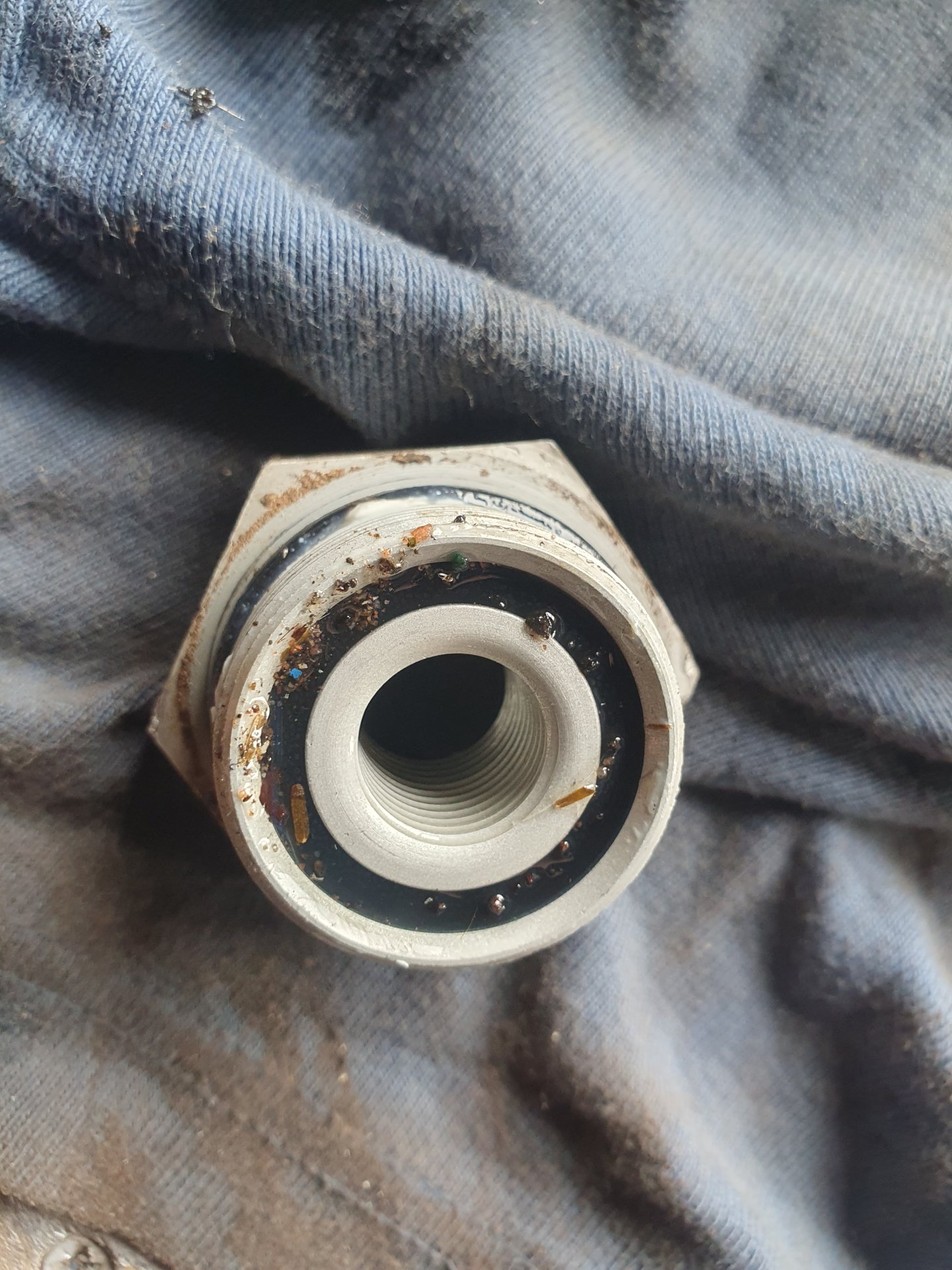

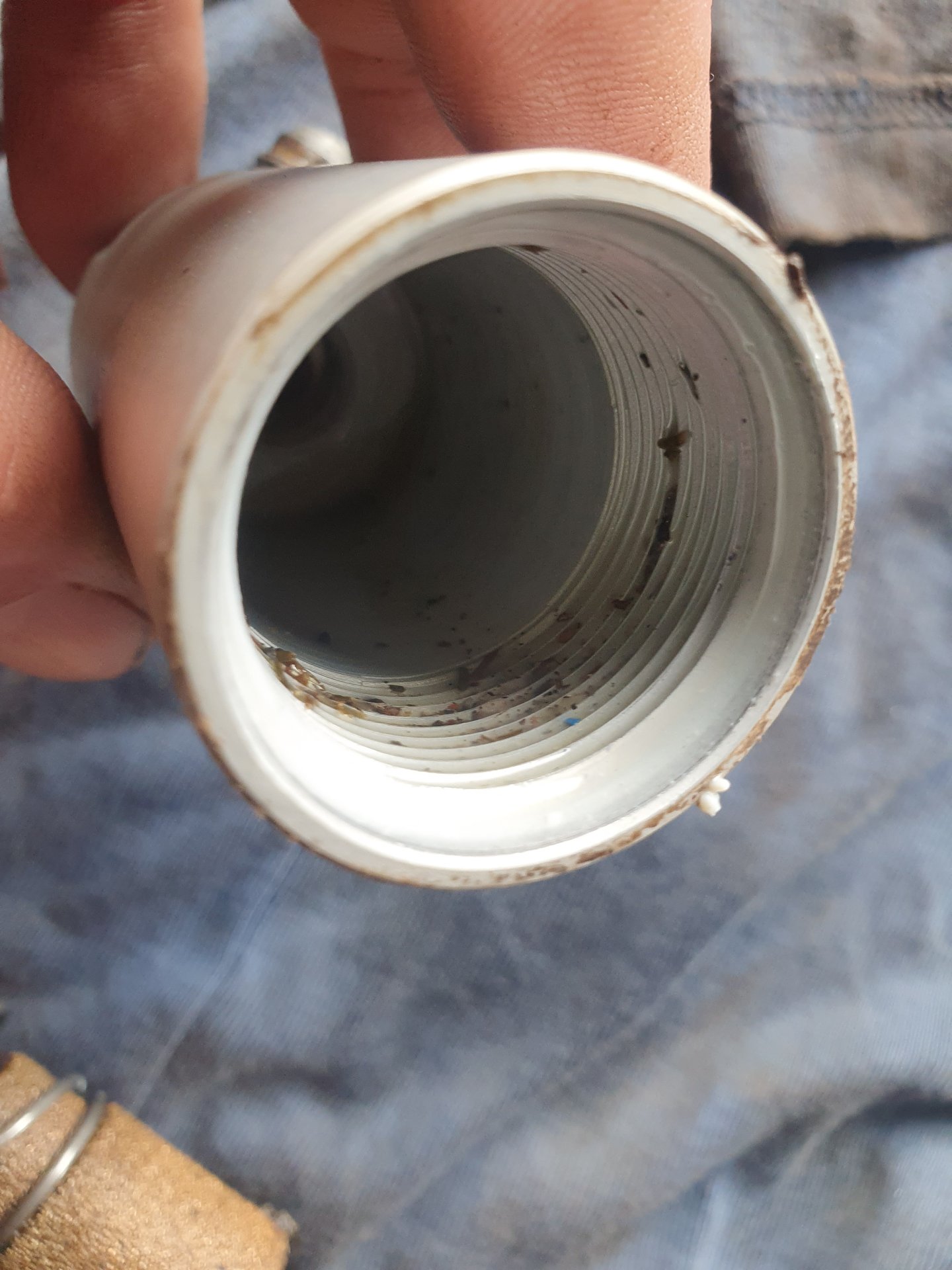

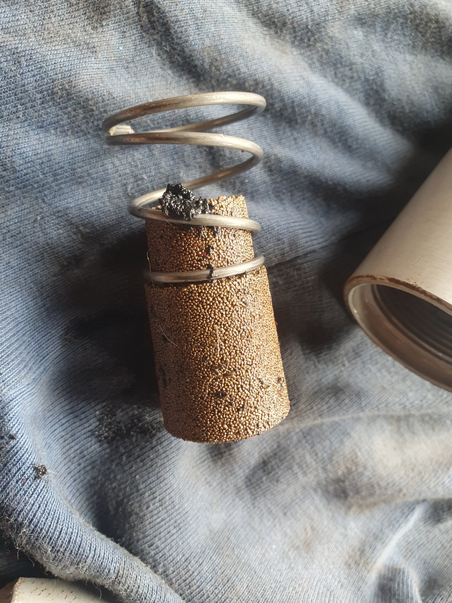

Dont know if its good or bad news...

My machine had 3200 hours on it when I got it and seriously doubt anybody had ever looked at it. After rebuilding the first drive motor which failed is when I replaced it and inspected the old one. It had much more stuff that that one does. IMHO you are in good shape with that but as has been stated previously, doubt it will affect noise.
And by rebuilding the 2 drive motors? Would that help even? Or am i worryi g about nothimg. Awesime old machine would lime it to be in tip top shape
Iguana, that does not appear to be excessive and I agree with dfb.
maybe slight deterioration of seals but not alarming. I don’t see metal flake. Run it;use it…and keep routine maintenance on hydraulic fluid and filter….in my humble opinion.
