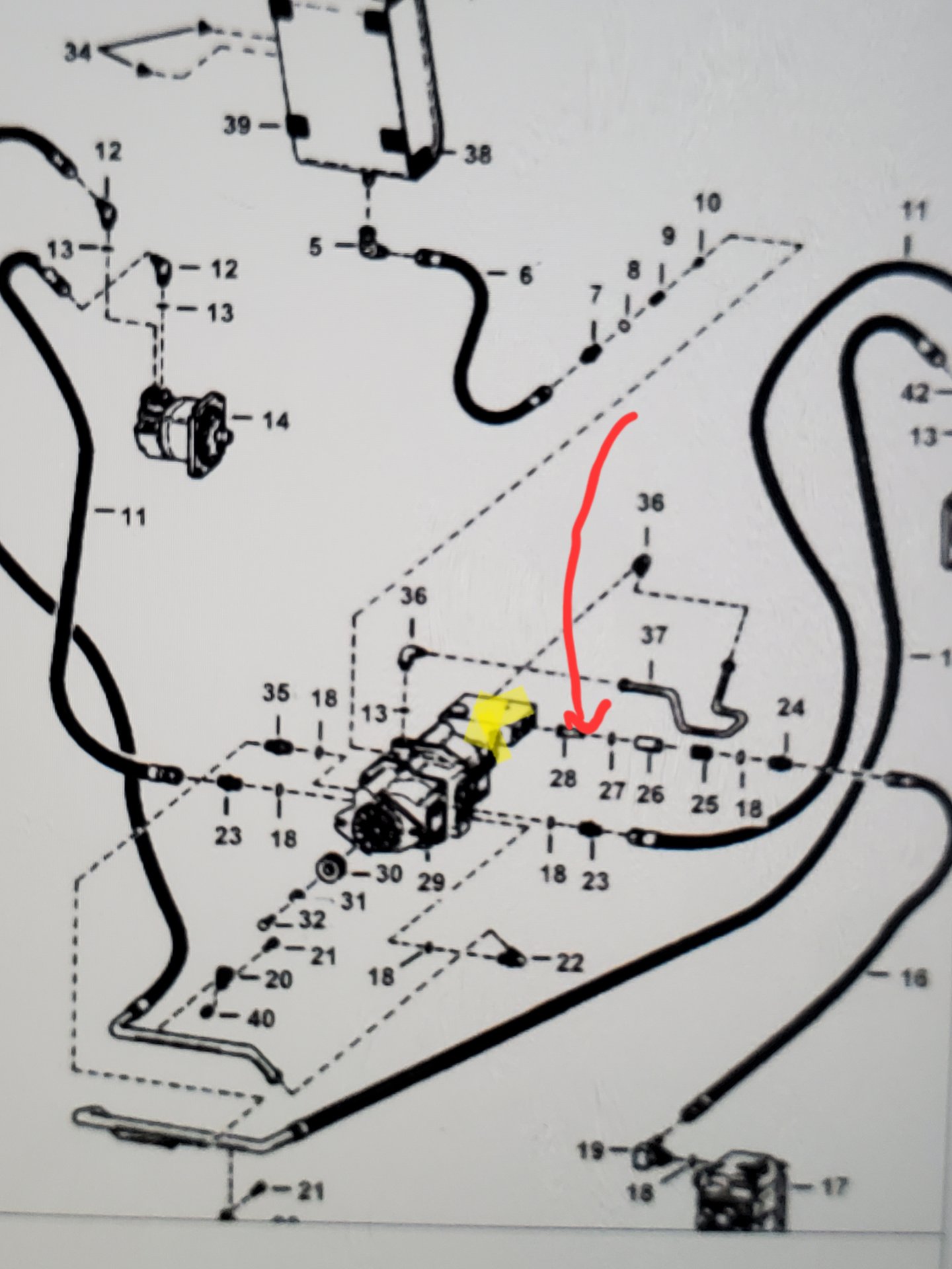

im not able to open up the cab right now, but here’s a pic from the parts online…yellow hi light is the port block. Red arrow points to the bronze filter. In this diagram, front of machine is Northeast.

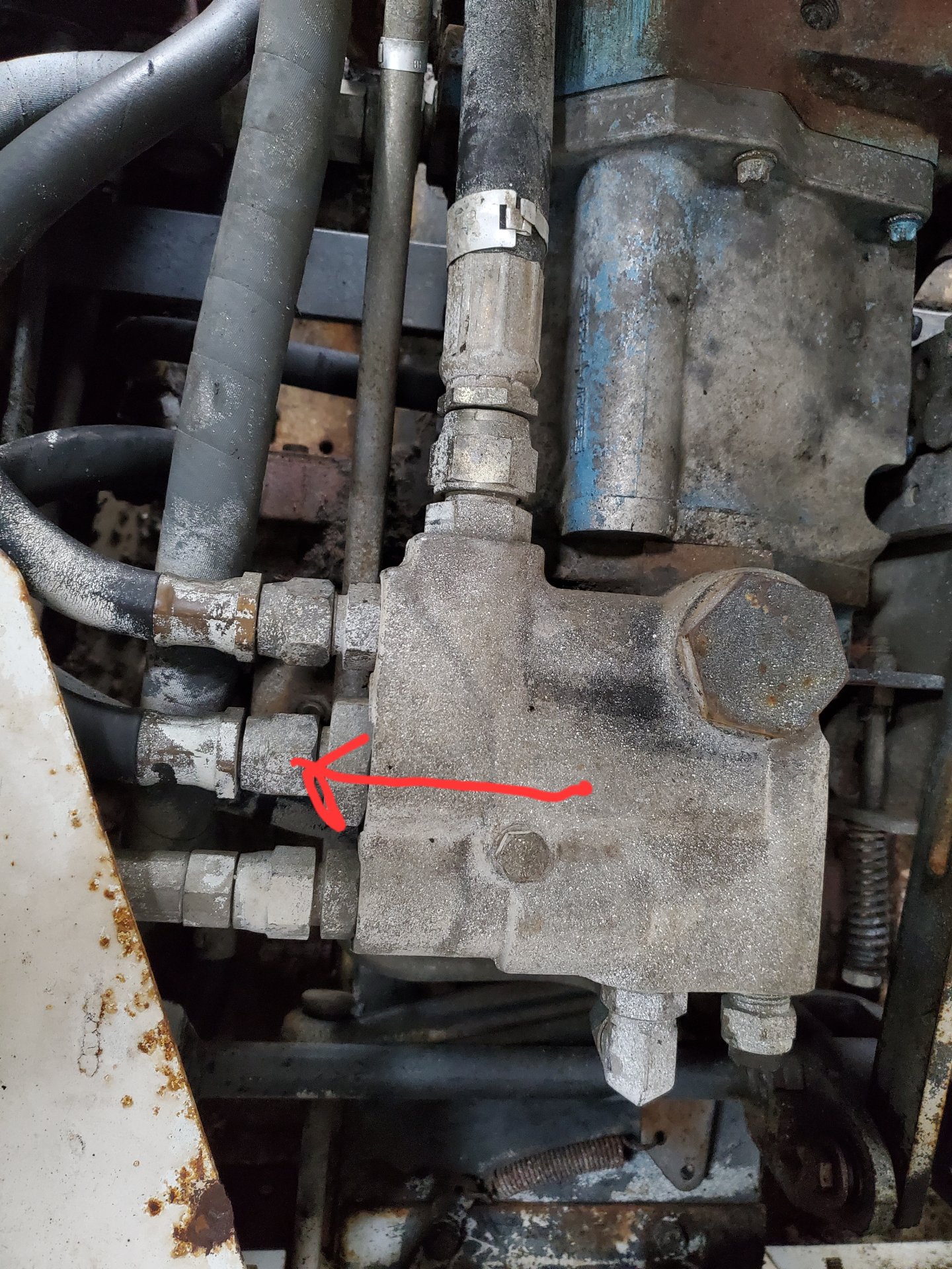

Here is a pic from mine. Front of machine is at bottom of pic. Cab is lifted of course. Red arrow shows the fitting which houses my port block bronze filter. Remove that hose first. Then remove the hose fitting from the port block. There’s a spring, o ring, and bronze filter. Filter kit bobcat #6563995. Again…this is for my early sn 743.
    650.1 KB

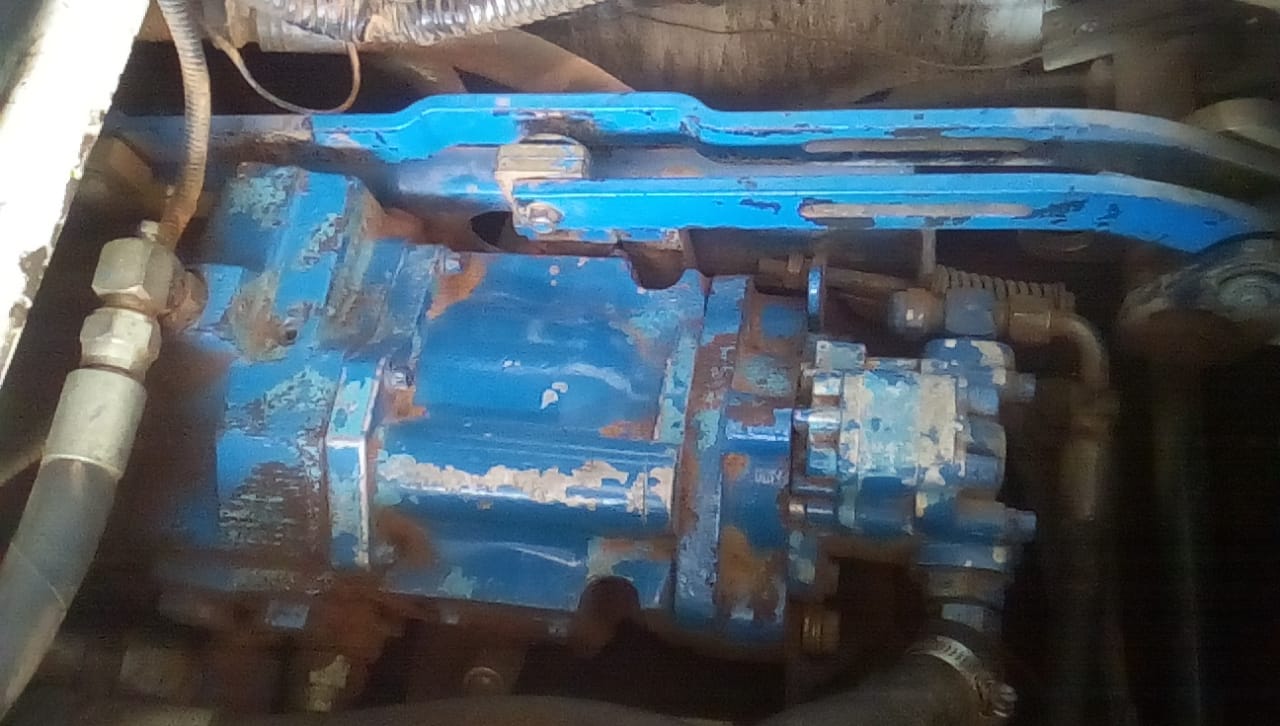

Only pics i could find really really old ones. Will get better ones soon

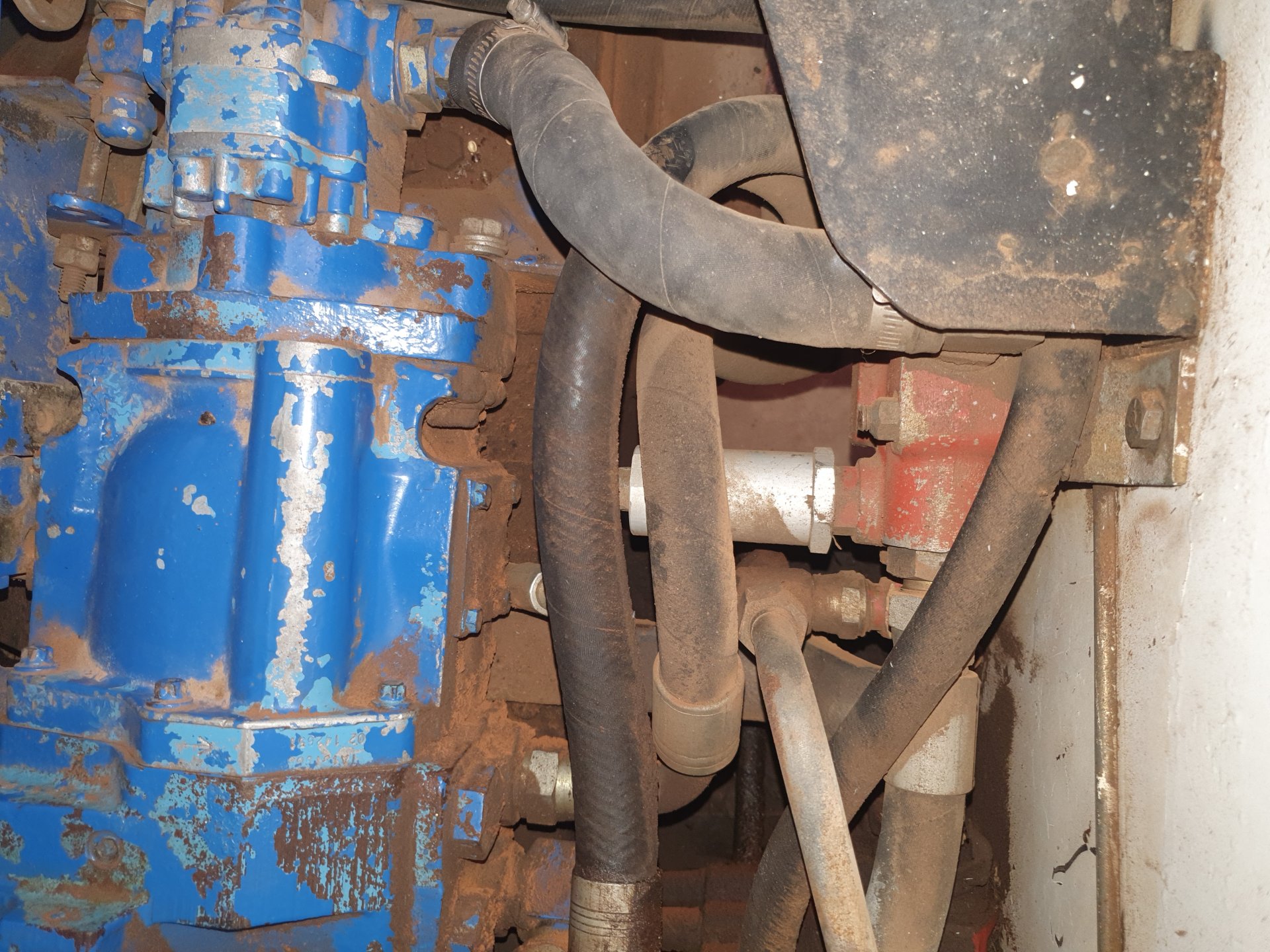

  • VID-20221026-WA0003.mp4
    435.2 KB
    103.6 KB
You definitely do not have a port block mounted on the hyd/hst pump. I looked at the parts diagrams for later sn 743s online, and the ones that do not have the port block on top of the pump appear not to have this bronze filter. So we might be chasing something that doesn’t exist on your machine. This rabbit hole started from a noise concern. My 743 groans when moving, equally both sides, with no decrement in power or ability. I mentioned it recently to a hydraulic expert and he said these hydrostatic motors in the 743s made more noise than later series bobcats. So with no adverse symptoms, I use mine and don’t worry.
Markle thanx a million suppose we must just run it and stop worrying. Like the saying goes if it aint broke...
Thanx for all the help

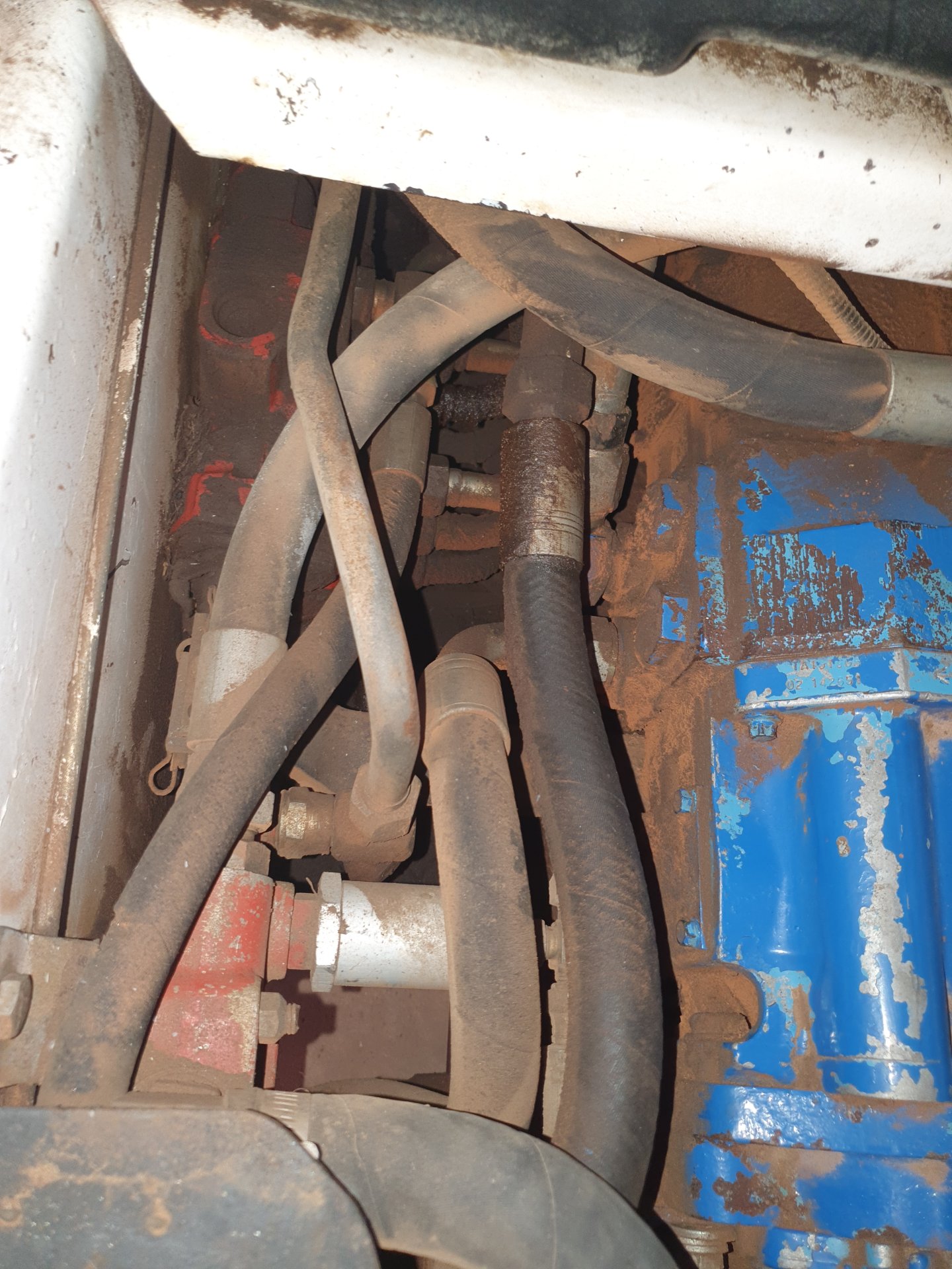

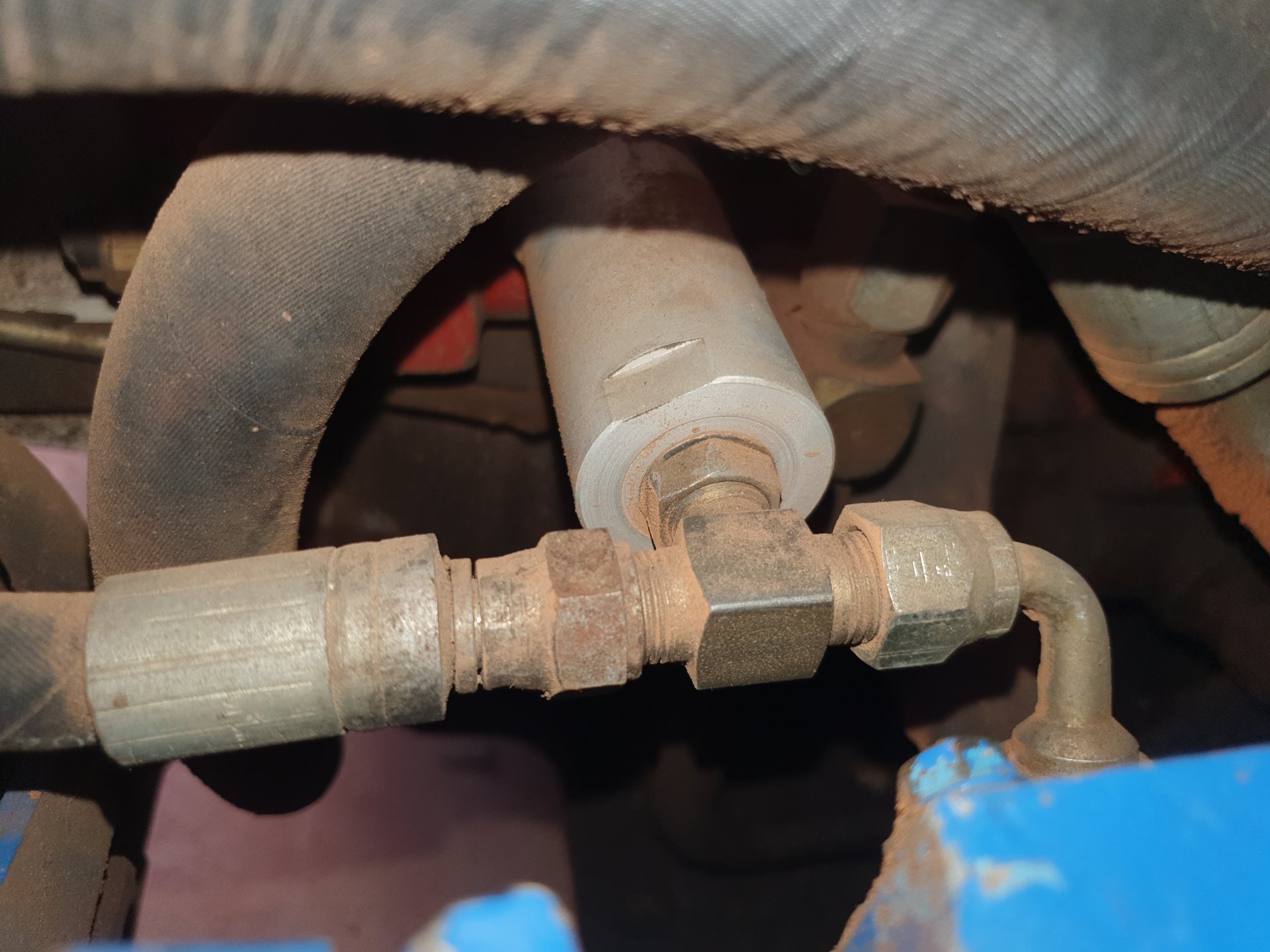

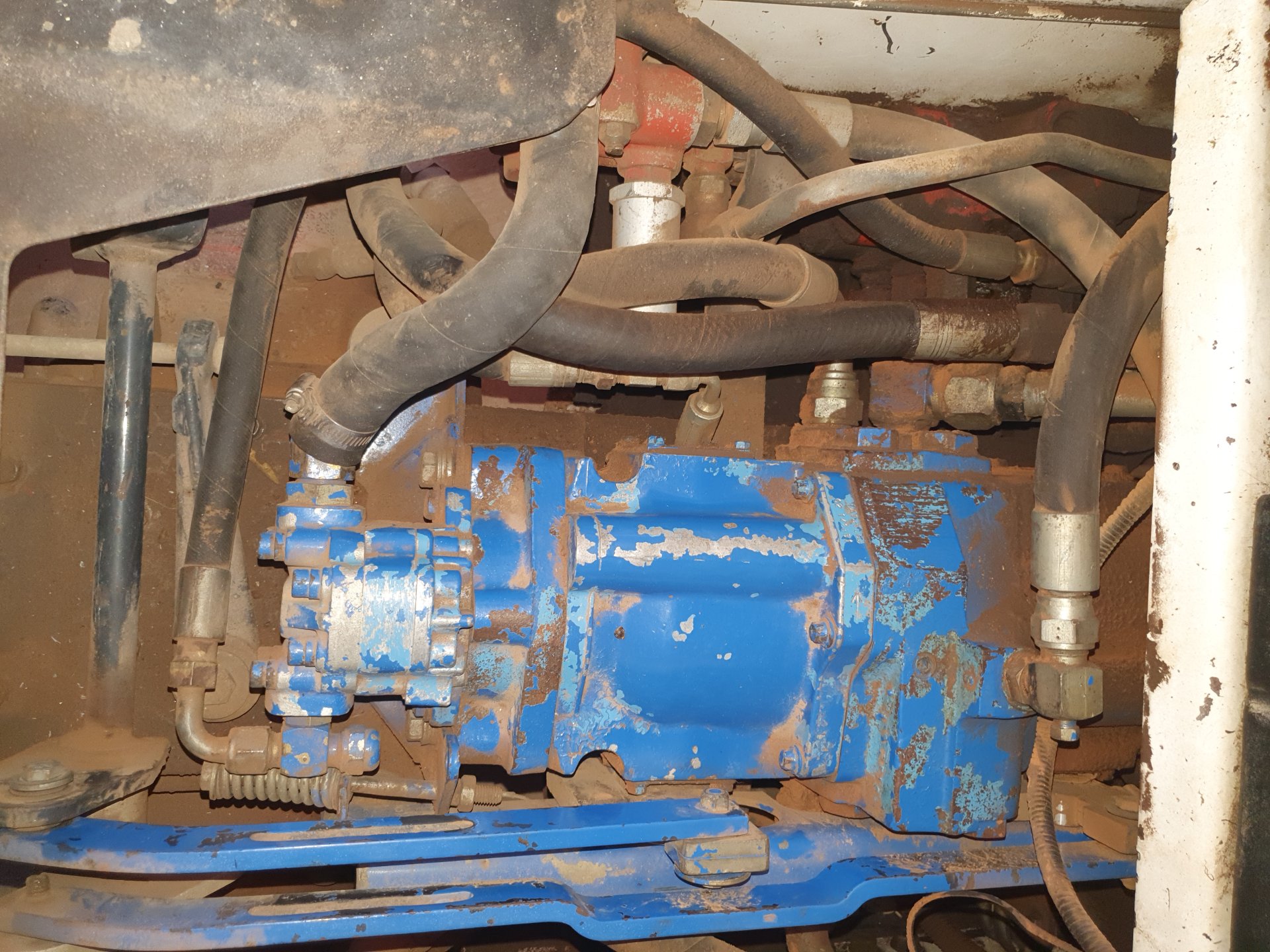

Guys good morning! Just to follow up on my post i think i found my brass filter!
    518.5 KB
    538.3 KB
    315.9 KB
    443.2 KB
