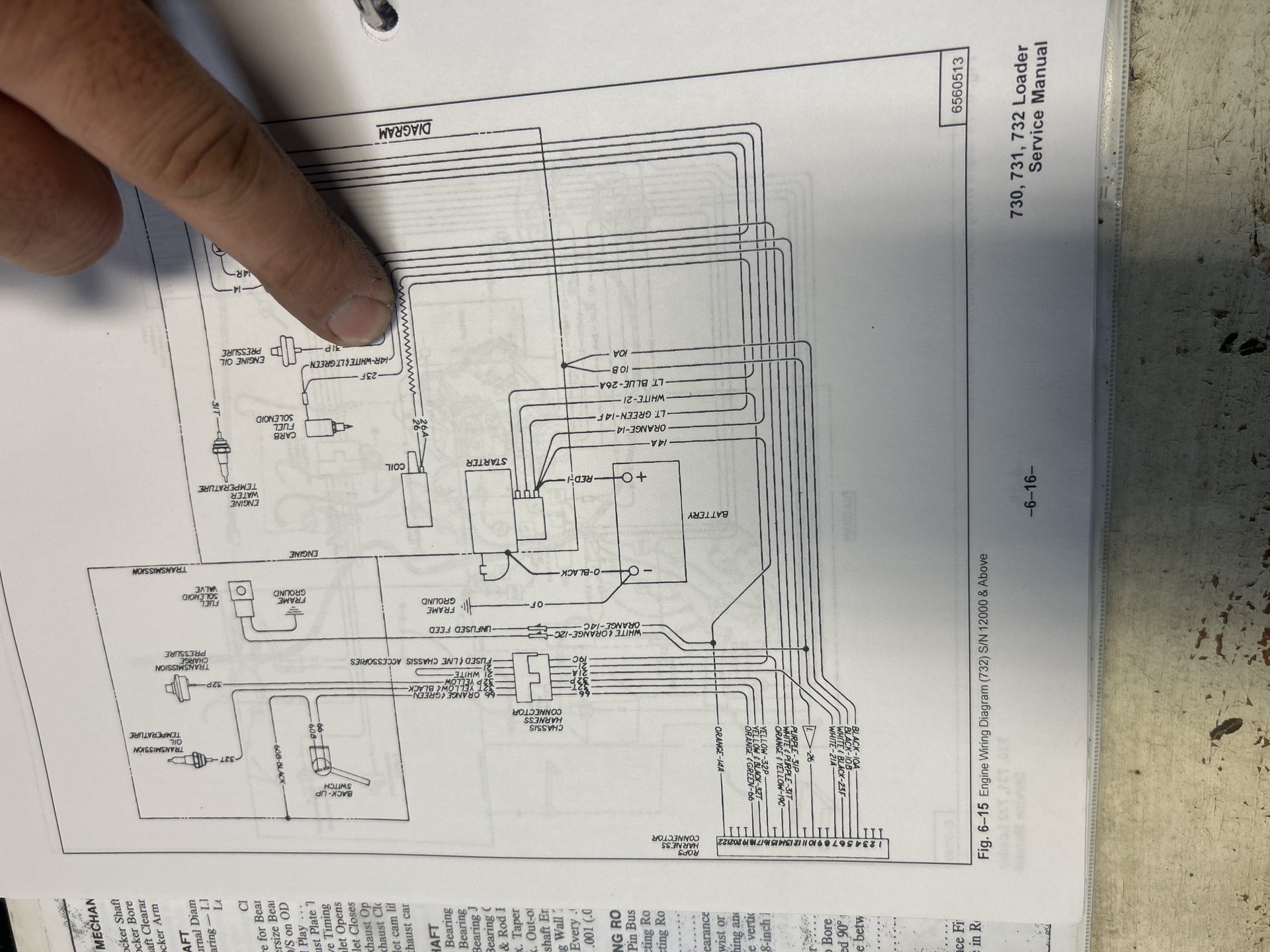

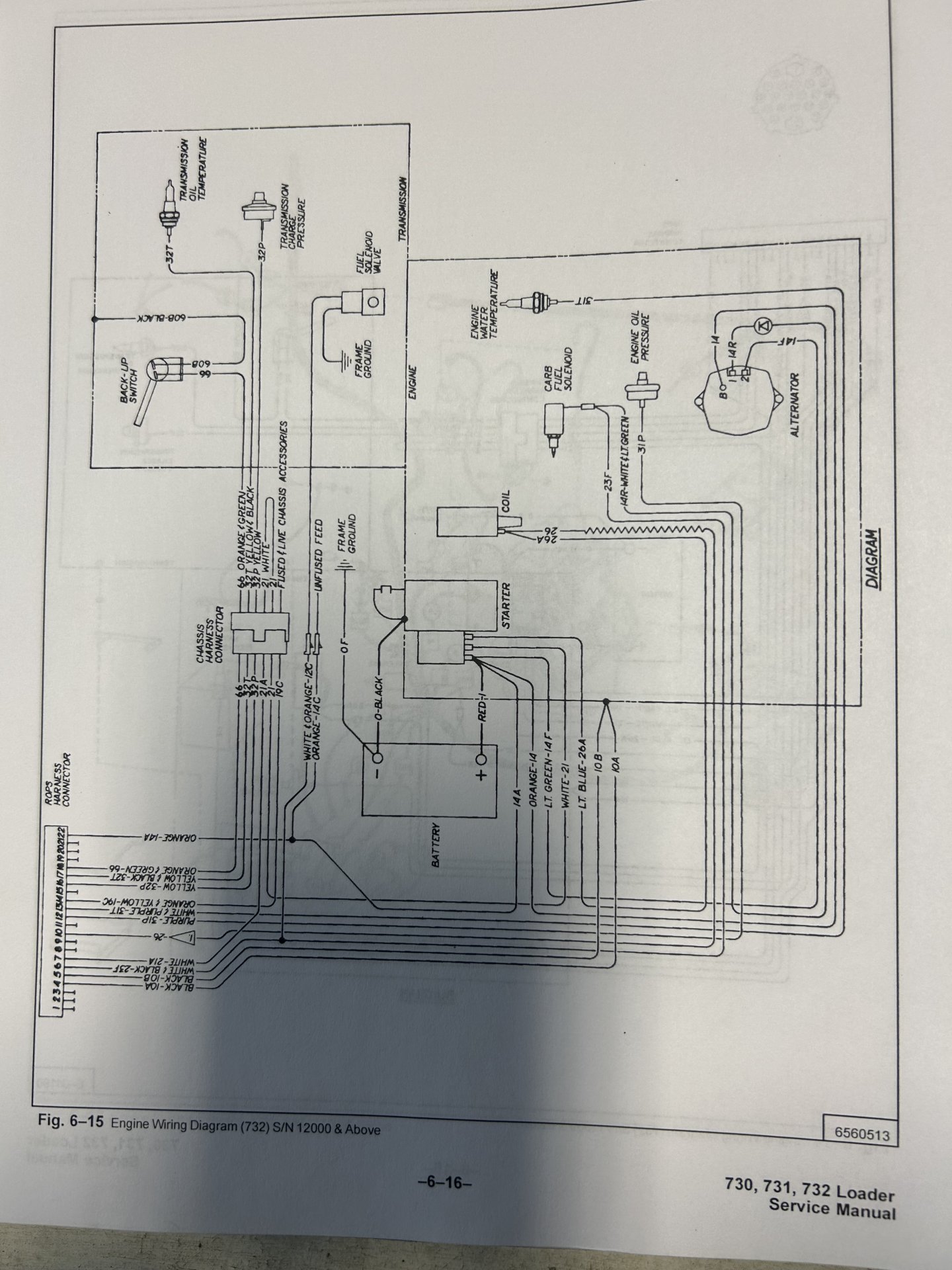

Here's a picture of the wiring diagram for the 732 with the Ford engine, as far as I know the only difference is the 742 has a temperature sensor in addition to the temperature switch... either way, the ignition wiring is the same. In the second picture I'm pointing at the resistor in the diagram. Hopefully you've found the issue by now, but if not, hopefully this helps!
Cheers,
Toby
