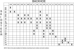

Here is the backhoe/skidsteer model overlap.
