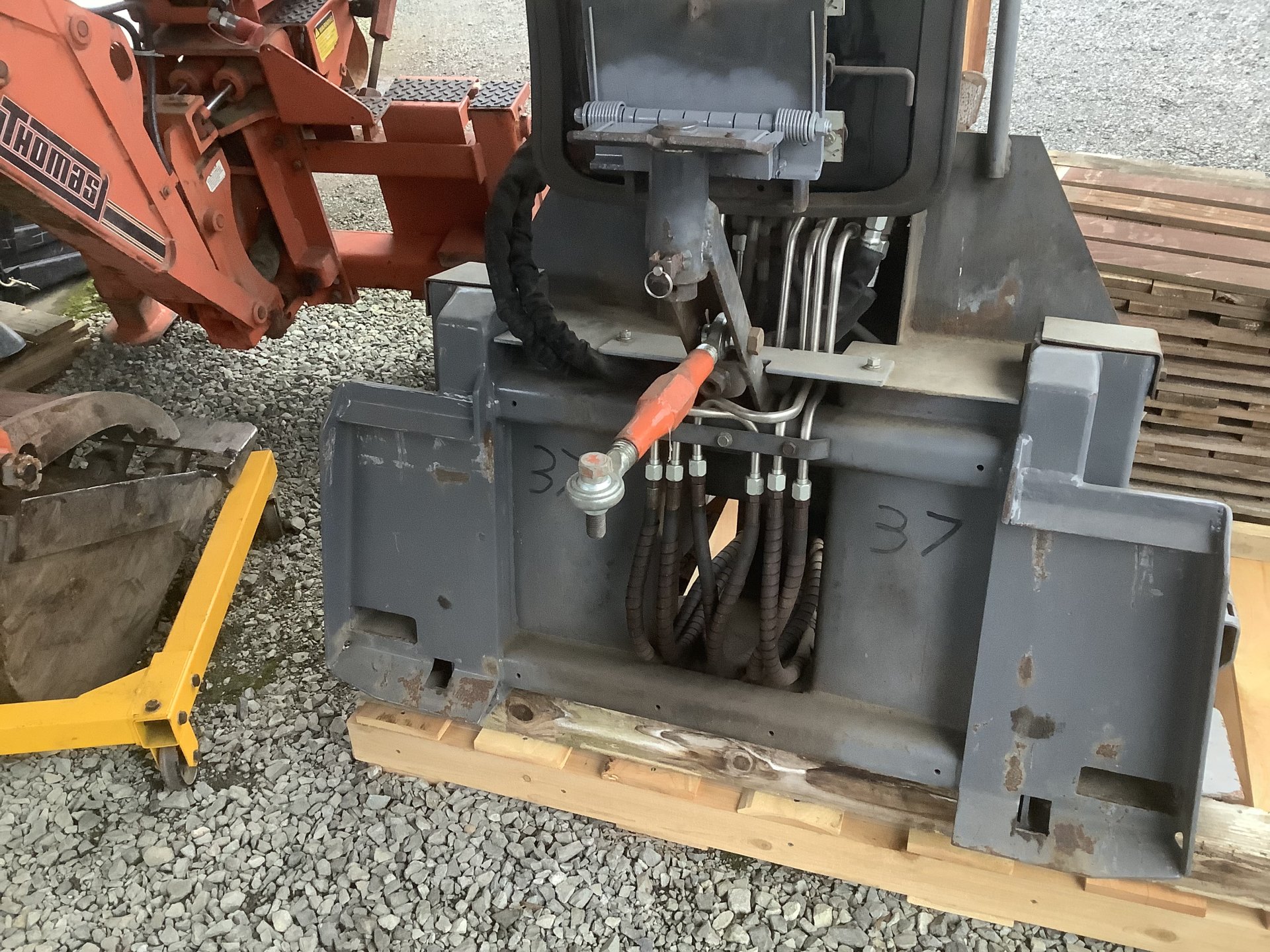

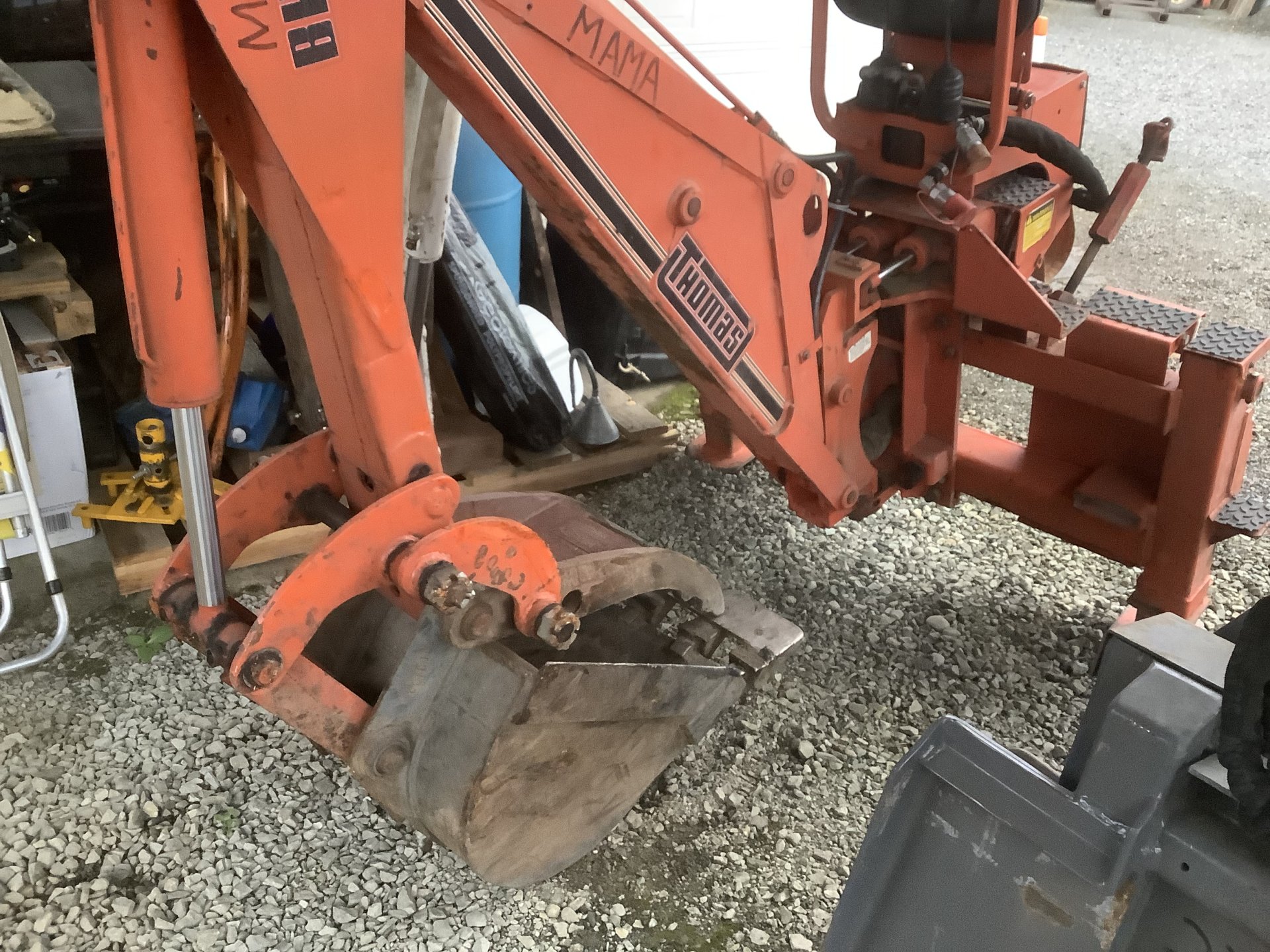

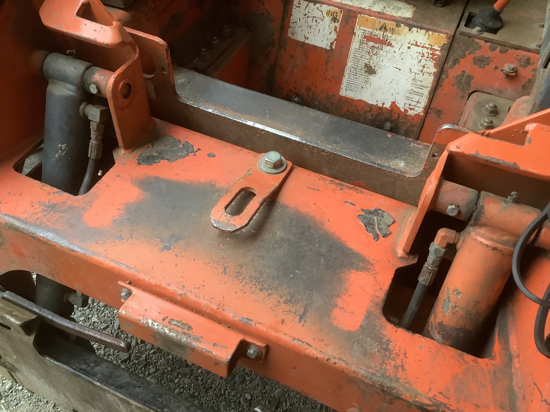

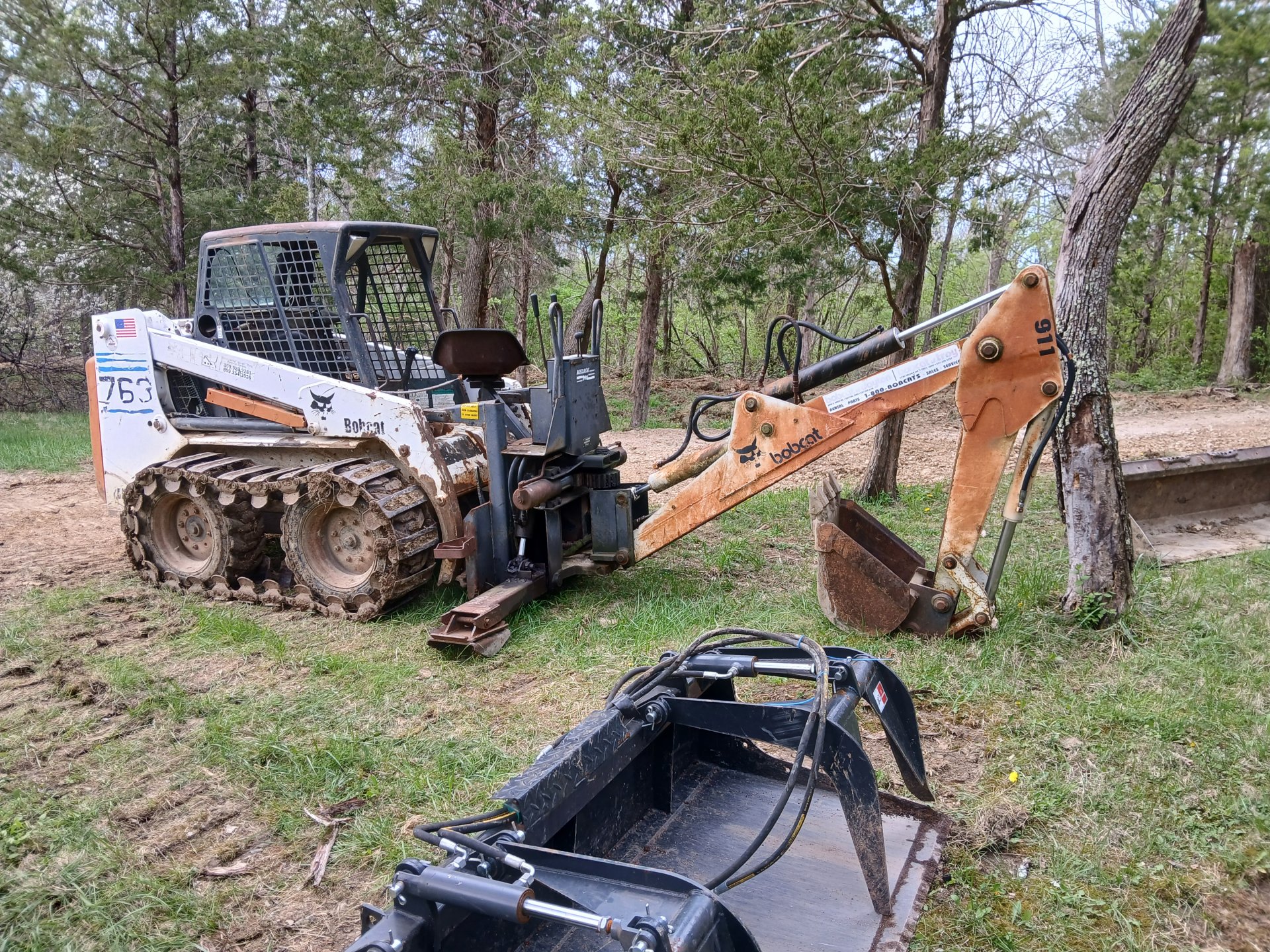

The backhoe has the old trailer hitch mounting system which won't work on my 763. So I'm curious what others have done to marry them together.
Here's a few pics of what I have.

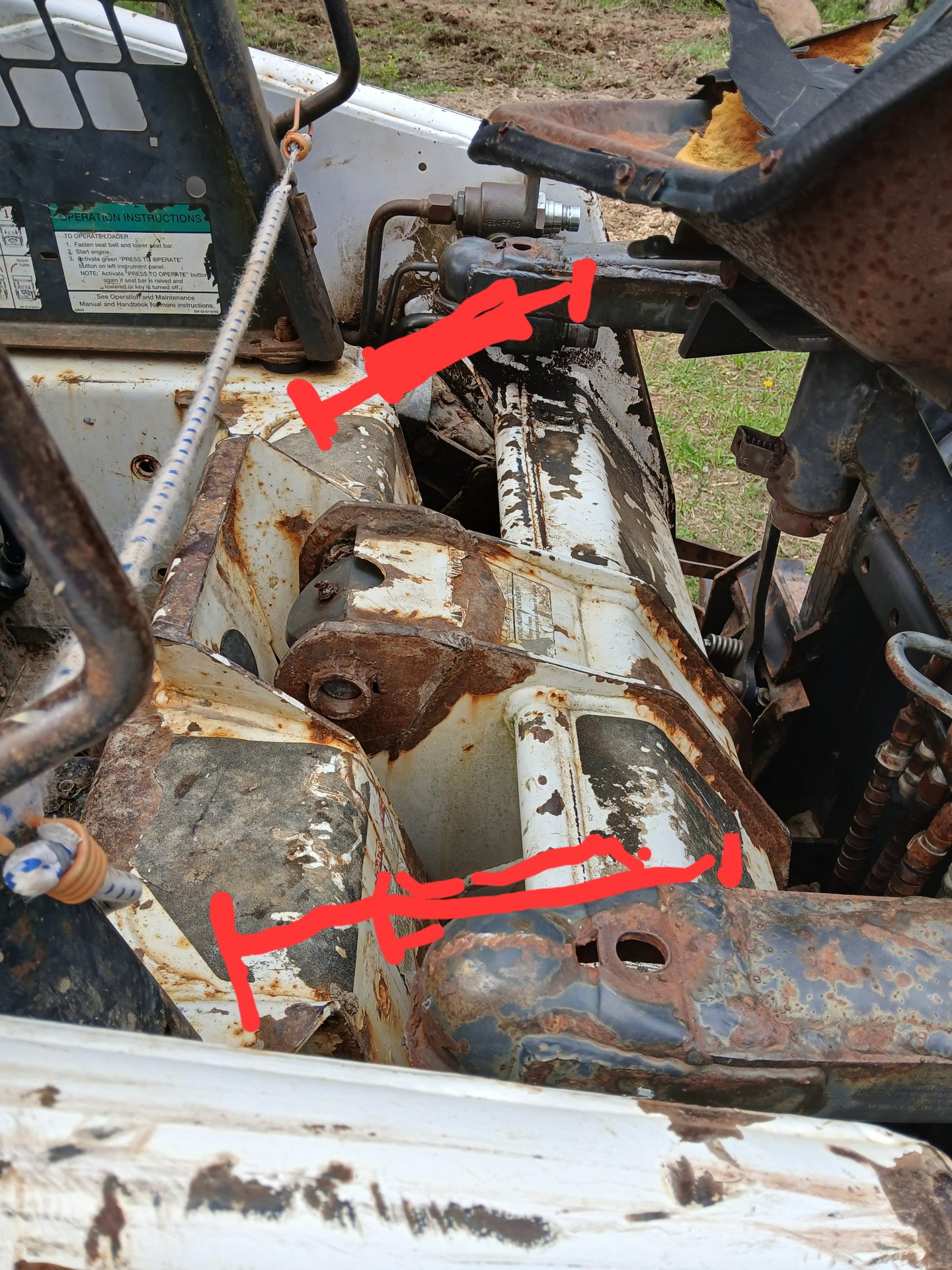

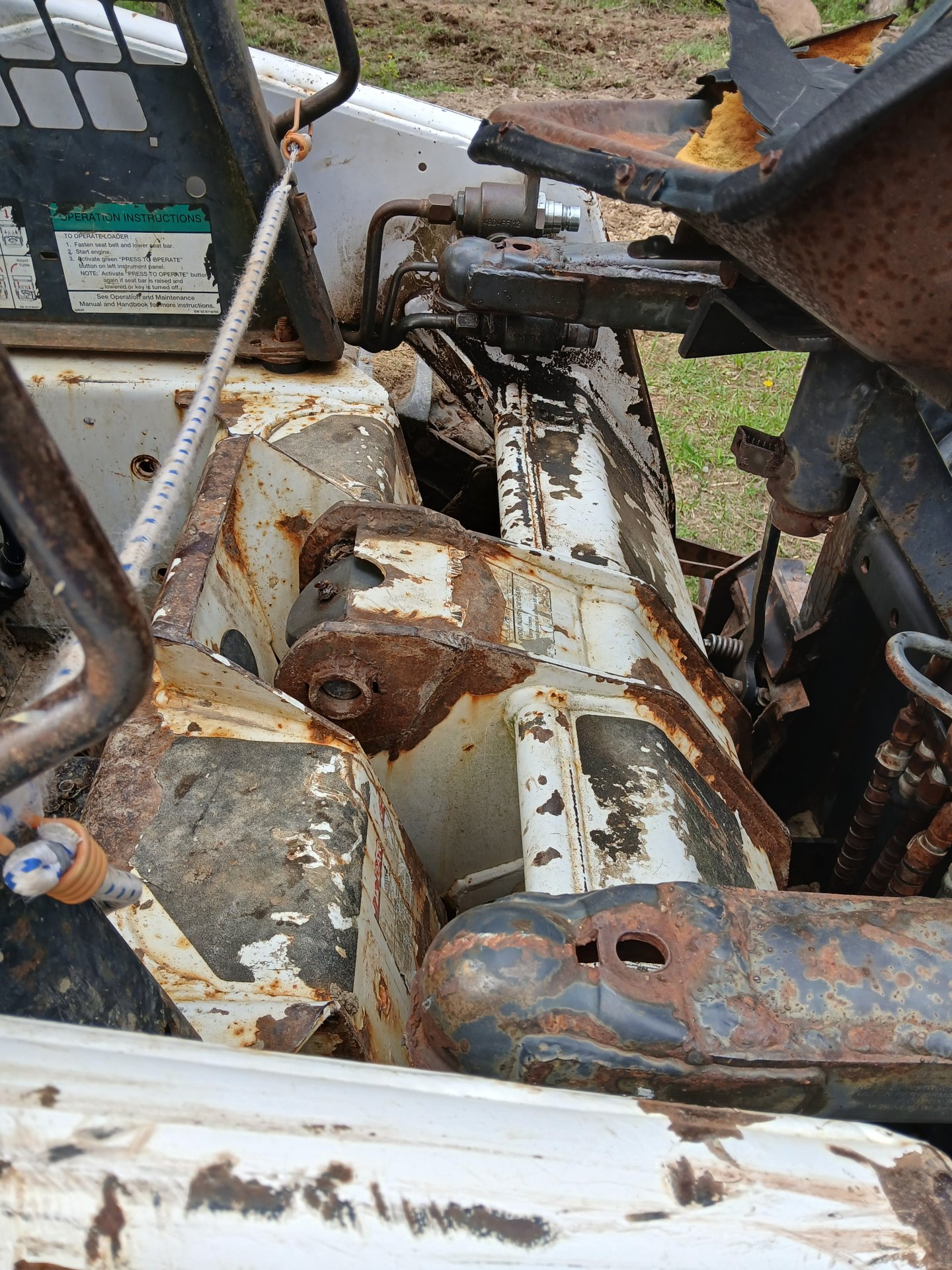

I'm considering mounting turnbuckles or 3 point hitch adjusters right here. Any reason why that wouldn't work.

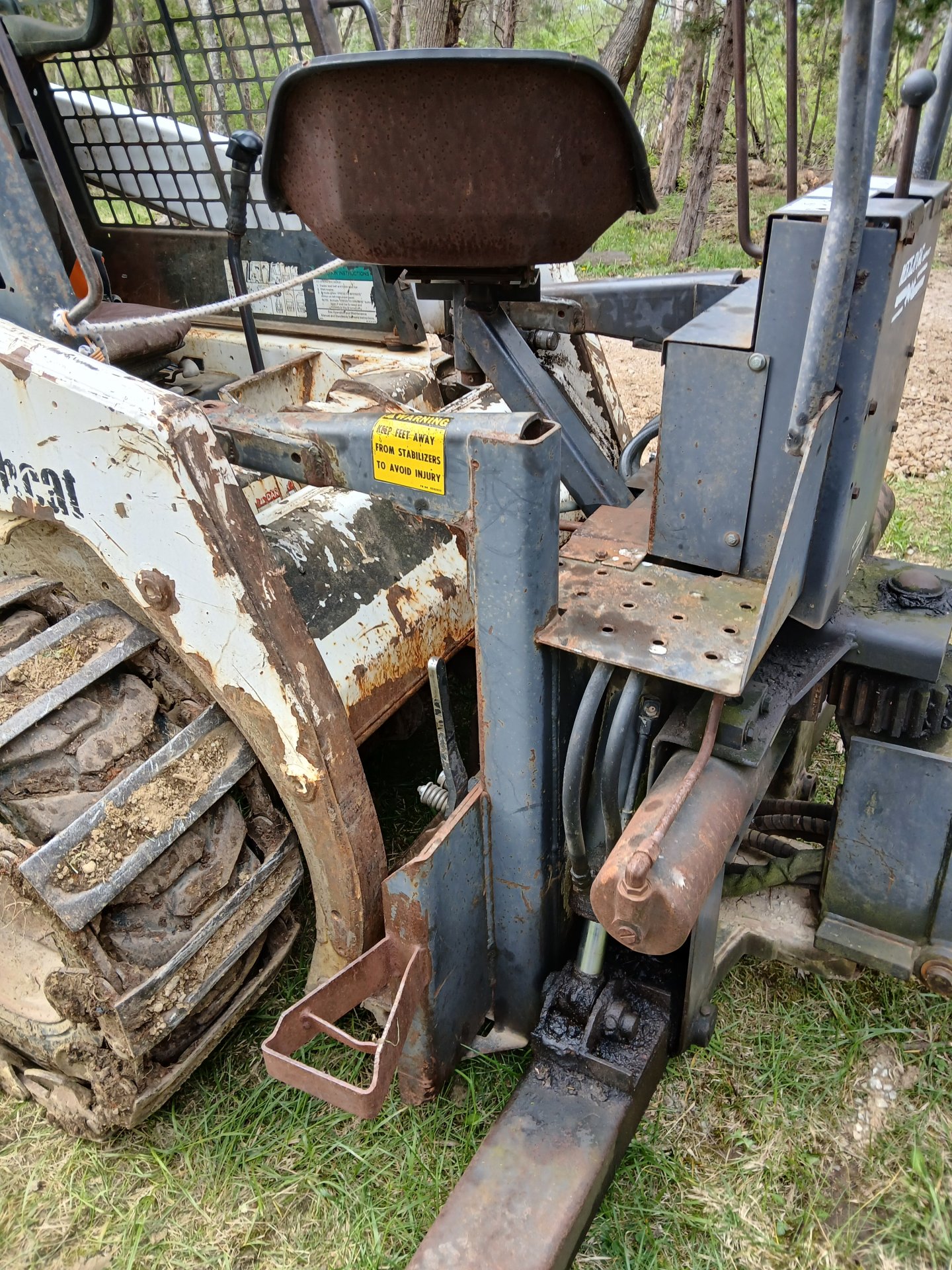

That is exactly what I had done to attach the 907 Bobcat to my Thomas T133s. One single turn buckle in the center attached to the loader arm frame. Bought a 3 point turn buckle from Harbor freight, and then had to shorten it to fit. You really want it attached to the machine frame to minimize stress on the loader arms. I had to remove the ball mounts because the mounts were going to hit the hydraulic lines from the attachment. I have three backhoe attachments, Bobcat 907, 709 and the Thomas BH 108 with a mechanical thumb. The BH 108 is the only one in the world with the thumb. Had to spend days engineering this to work the way it was designed. Needless to say, I do not use the Bobcat attachments any more because they do not have the thumb. I have been digging many stumps on my property In the mountains over the last year and a half. It is great for picking up the stumps and getting the dirt out of them to burn. The property in a river bed from thousands of years ago and it also works great to pick up rocks in the holes.
Just be careful on the loader arms, this is a lot of stress. Hopefully you will just be digging easy dirt with a few small rocks.

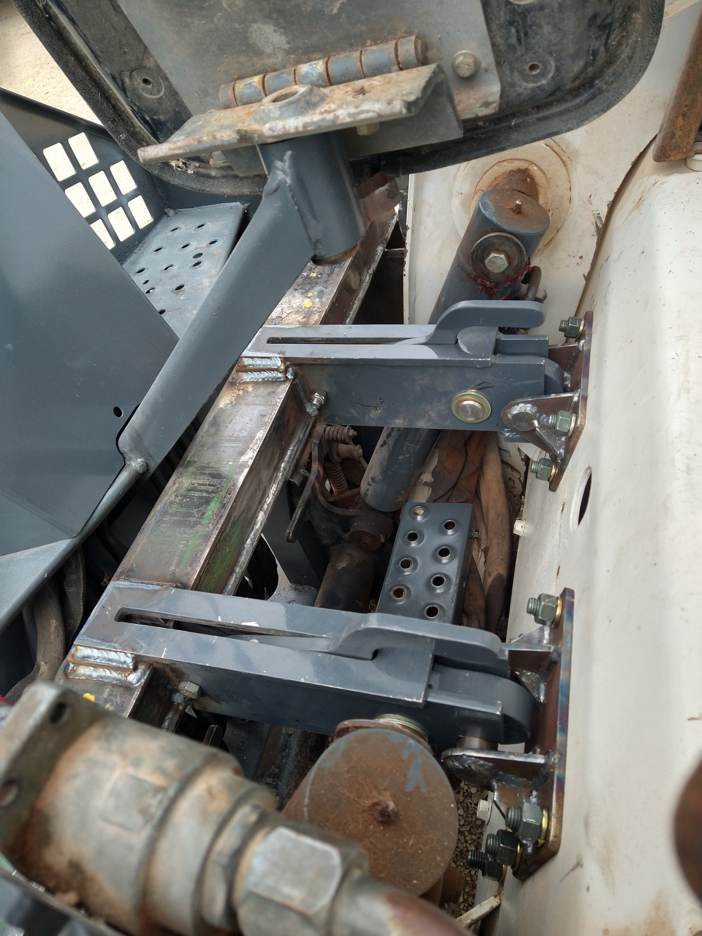

Which ever way you choose, make sure it is rock solid, (no possible lift arm movement). I found that out when I fabricated my attaching mounts for an 811 to my S300. It took some head scratching, but I built mine patterned after the mounts for an 8811 to S300. They work great.
AJ, thanks for the reply! It's good to hear that this works. I plan on connecting it to the frame so that all the back and forth pressure isn't exerted on the cylinders. It was kind of you to go into detail and post pics. Very helpful!
The ball mounts on mine are a bit of a nuisance, but they don't interfere with anything, so I'm going to leave them in case I re-sell down the road.
If this had a thumb, I'd never consider selling it.
Terry, thank you as well. I'll be sure to do that.
Second question...
I planned on lowering the arms all the way down. Is that how they were intended or was it designed to be slightly lifted for more ground clearance? All the way down will be a lot easier and how I'm going to do it.

Thank you. I made them and mounts on the machine from scratch. Both sets together from Bobcat around $1700.00.
That's impressive. If you ever have some time, I'd really appreciate a parts list/ short explanation of how you made the locking arms. Making mounts like that is on my todo list and the locking mechanism is what I've struggled to come up with.

Thank you. Not sure what you mean there. If I need to relocate, I just lift the outriggers, move or readjust the machine, then back to digging. Only time removing the hoe is necessary is when I'm done with it.
I'll see if I can come up with something. There was a lot of head scratching, trial and error, mock ups-and patience. It's a pretty complicated yet simple system , to perform a simple task.
