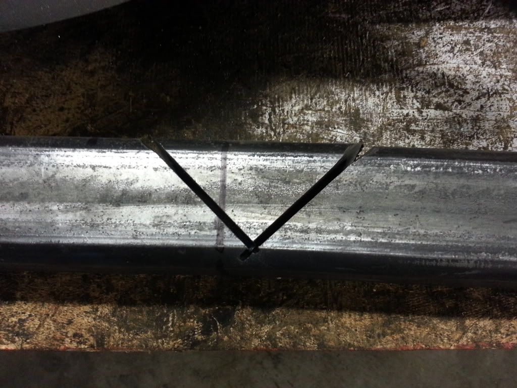

First, I'm a novice welder and much of what your about to see will appear to be quite ugly (especially to expert welders). However, I learn quickly from my mistakes and appreciate helpful advise. So I started Thursday evening cutting the 2" square tube.
