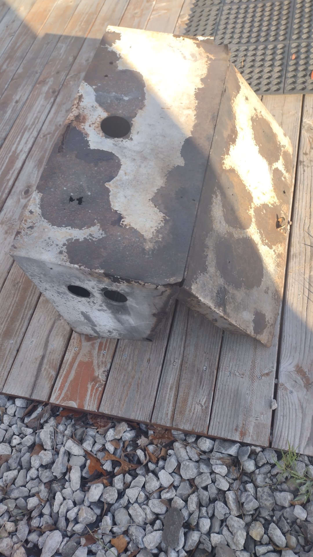

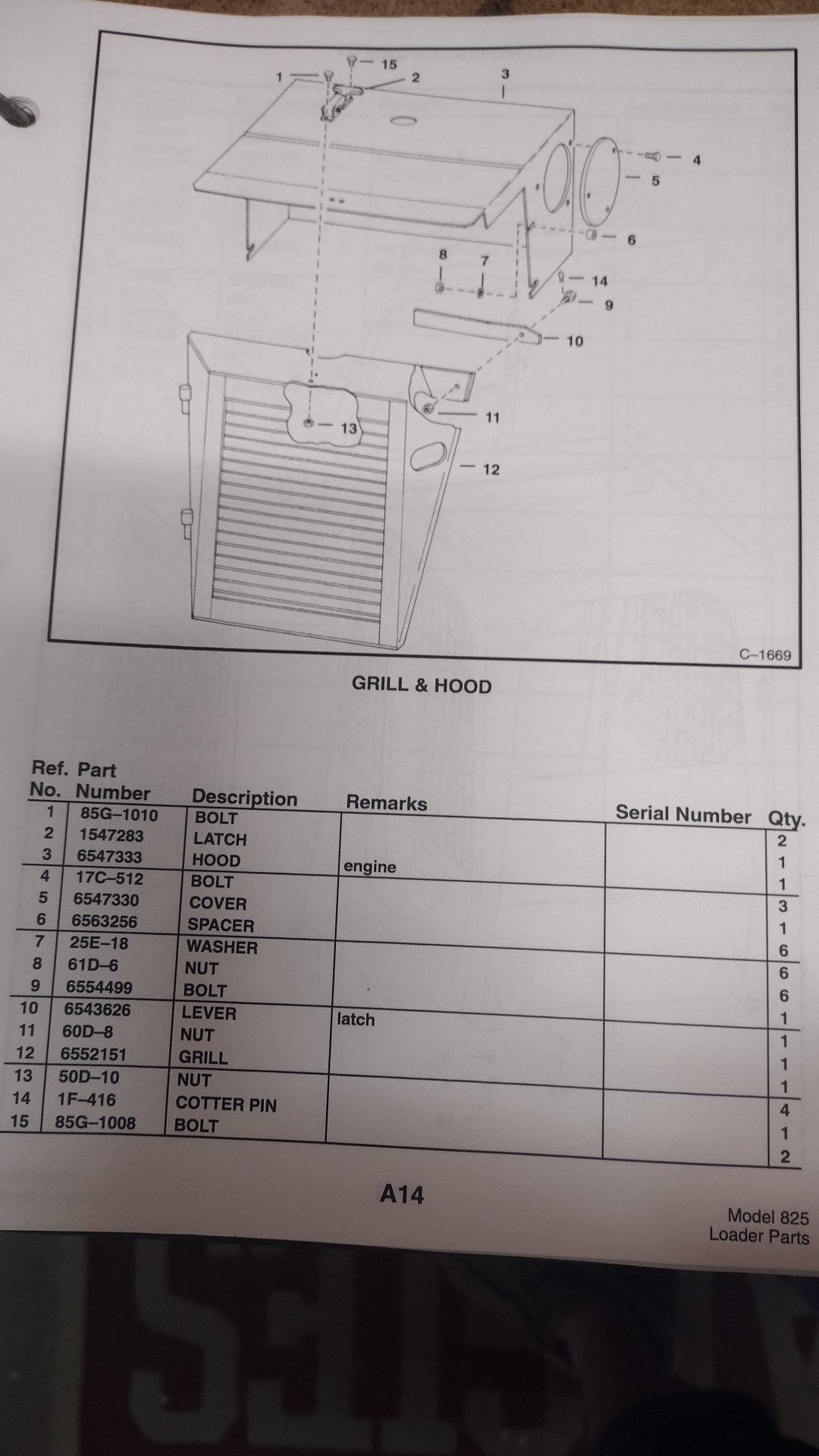

Hey all. I’m in the process of restoring an 825. I’ve got it stripped down and sandblasted. I do need to fabricate the engine cover but the parts manual doesn’t really help me. If someone has this machine, could they post a few pictures of the cover so I can see attachment points? Currently fabricating new pedal module. On another note, why did they put a hydraulic filter in the hydraulic fluid well? It really doesn’t make sense to me.

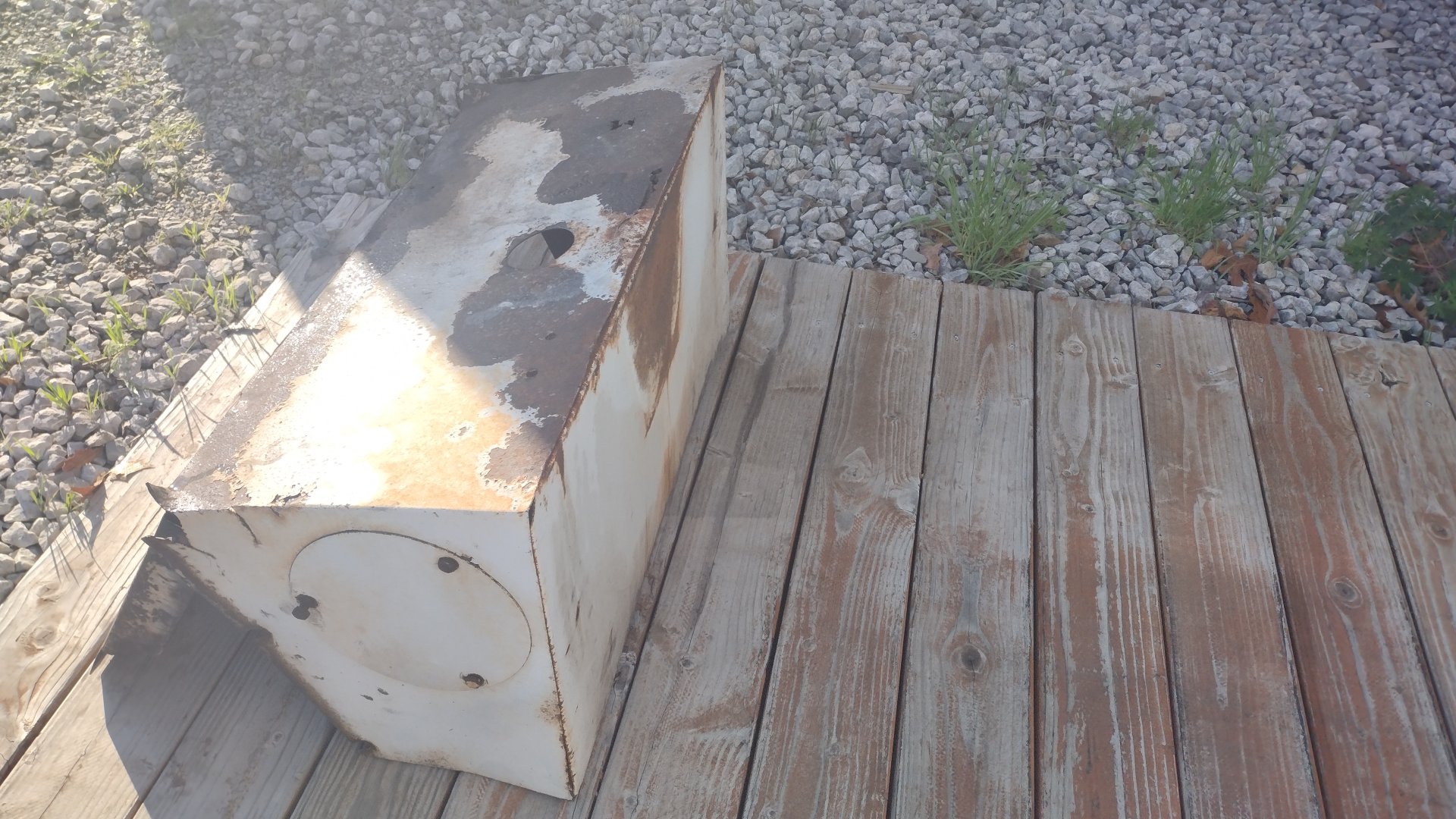

Apologies for not seeing this earlier. Restoring an 825 as well and need to replace cover but still have the old one. Attached is what I have. Also, I am not aware of a filter in the hydraulic well. I have two, both external.

Just saw this. Thanks. Now I know the proportions. Stopped for a bit, needed to repair tractor. Have just started rebuilding the pedal assembly.
