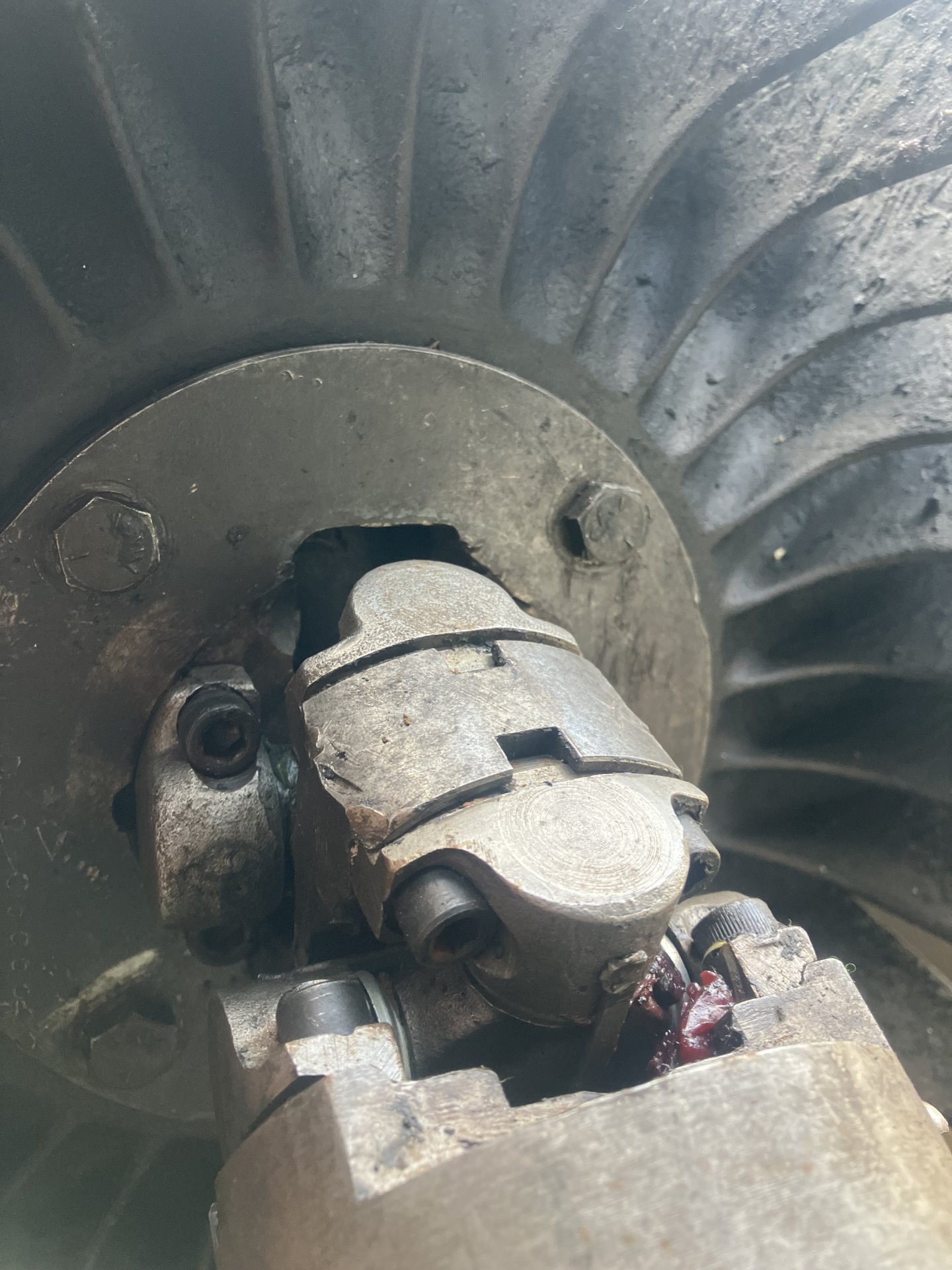

Can you post a picture of the coupler assembly? I just replaced an engine to hydro coupler in one of my Cases due to a yoke spline failure. The engine to hydro alignment is clearly off a little but it matters nothing. That's why there is a Cardan joint there. I'll echo the response above about checking how easily the new U joints move. The coupler I rebuilt uses 1310 crosses and the new crosses came with 3 different retaining ring thicknesses. Using the wrong ring would have made the crosses really bind up.

Sorry I just got my phone off the charger. Yes I will first thing in the morning. It's already dark and I have been working on it outside so I wouldn't have a good picture

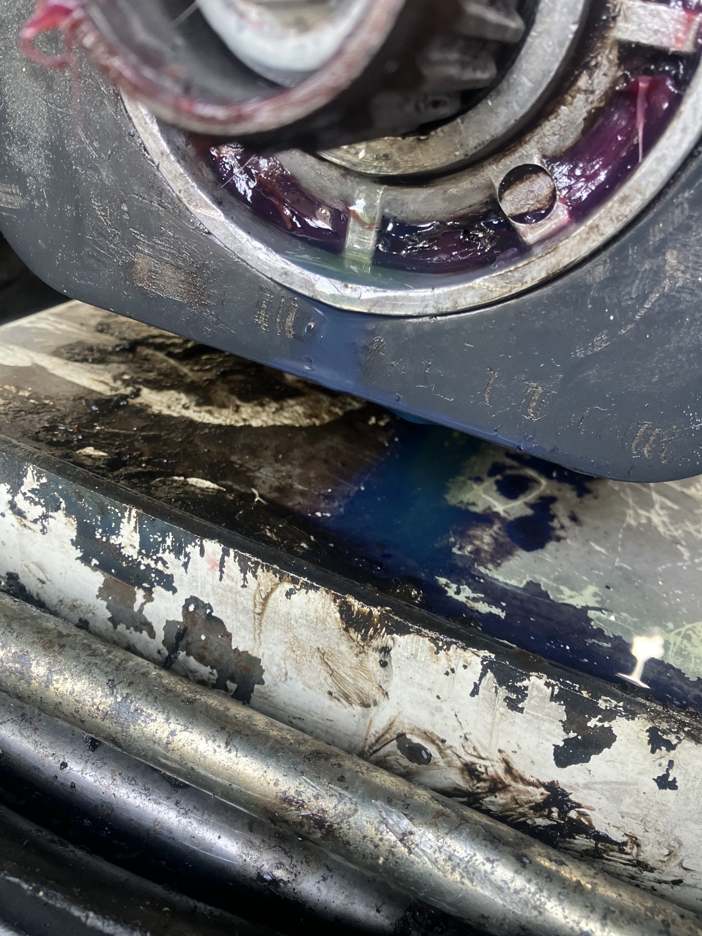

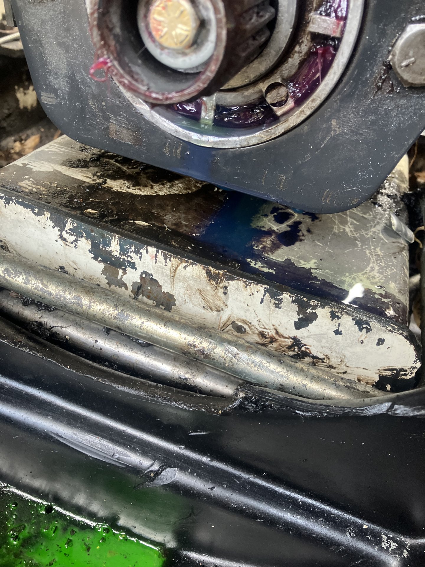

I hope these are good
for you to see. I can take more. I don't know what the little bit of hydraulic fluid is from that was dripping out of the outside of the adapter ring but it was not enough to show on the stick. I measured from the floor to the center of the pump adapter and it was about 10 inches I have the engine in there and I am going to try and get a measurement of the ujoint coupler maybe because the motor mounts that came off was 20+ years old and worn down that I have raised it just enough with the new ones to throw it off. If so I don't know how to get it back down. FYI I am in no way even a back yard mechanic when my mom was going through the chemo we didn't have the money to get someone to fix it her ex paid the 800 for ujoints so don't mistake me for knowing what some of you guys are talking about. You may not know it but you are doing a great thing guiding me. I didn't get the parts back in time for my mom to get on it again but I am going to finish it somehow for her

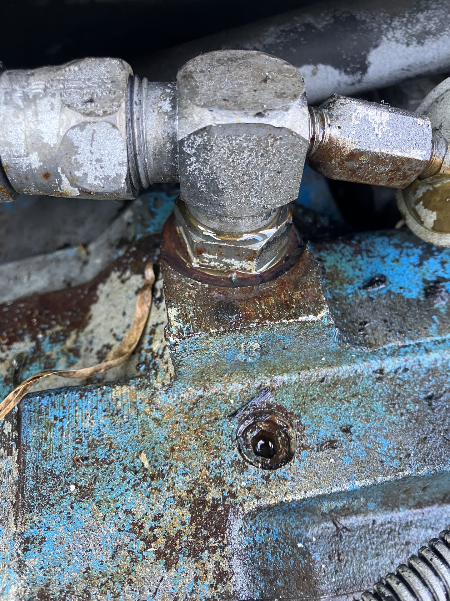

The last photo is of the top of the hydrostatic pump. Got a little fluid around the main fitting???
1,197
Could that fluid be coming from the pressure fitting adapter? It looks like it has been hit from the top and is bent at the threads.
