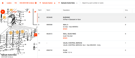

Here is the short version of my story... Have lift spool leak - did my research prior to starting the job - when I pulled the spool out of the block there were no bushings as the parts diagram calls out (I used my serial number on Bobcat parts book webpage) - I attempted with my finger and some picks to pull them out if they were stuck but no movement.

Make sure that there is not more than one control valve listed in the parts list for your machine.
Also, these parts catalogs are not without their errors. I would suggest just putting In your model number and taking a look at the other control valves shown for different serial numbered machines. I think the latest 743 models do not have the bushings.
I did what brdgbldr said…my 743 did not have bushings . The Gresen valve spools on some 743s do not have bushings

Thanks for the replys. I did look at the other SN breaks prior to posting here and they all show bushings.
Markle is showing the tilt control section. I am working on the Lift spool #7 in this diagram and my control valve body matches that shown in the same diagram
Everything else was there detent springs (2) and balls (4) I also replaced the small o-ring under the stud in the spool. I am convinced that there are no bushings or this is an aftermarket unit.
Do they stamp the block anywhere so I can determine if this is an OEM block and is anyone aware of aftermarket producers of this assembly?

Roger that. Do you have any insight as to why the parts book calls out bushings (#8 In diagram above) and there is nowhere for these bushings to go in my valve block?
Was the valve block changed out in the past? They might have not used a direct replacement.
See bobcat hydr spool manual attached. According to this, only older valve blocks had bushings.

Well… After more time than I wanted to put into online research and the phone to find an aftermarket supplier of the control valve (never found one) and why this block didn't have bushings. I was able to find a gentleman from parts support and he said he was 99.9% certain that all 743's had the bashings. I replied I bet I'm in the .1%… wish I could've called that in to Vegas.
Anyway he was a good guy and was willing to dig into the issue. He reported back that there was a period of time ~16 months where they trialed a different design (mine w/o bushings) then went back to the original design (w bushings)
