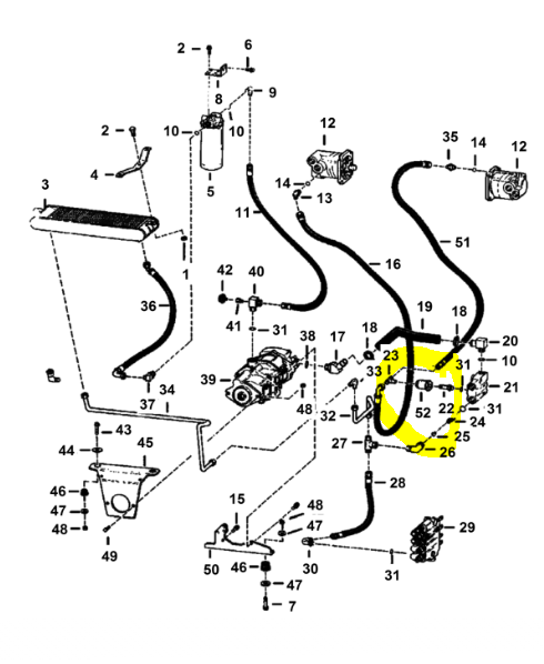

It appears from your pictures that you have a later model 743. You still have an inline hydraulic filter similar to the bronze filter, but it is in a different location. If I remember right the block that's in Markle's picture will have been moved to the side of the machine frame. There should be an inline filter in there, item 52 in this picture.

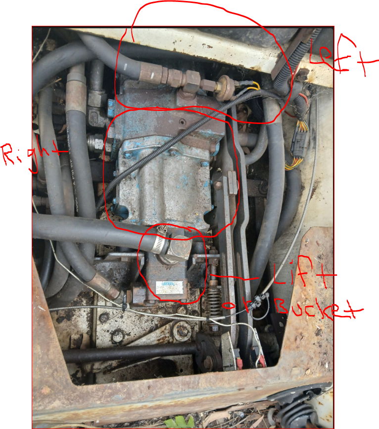

THe real question is how does it dig or push will it spin the wheels or does one side spin and the other does not, from the sounds of it the pupms are worn out, the above picture shows the lift pump and the right hand side drive pump the left is further up in under the crossmember, it is using a common center housing for the left and right hand side of the drive, ie the high pressure. View attachment 8303
Ok great thanks for the diagram greatly appreciated.

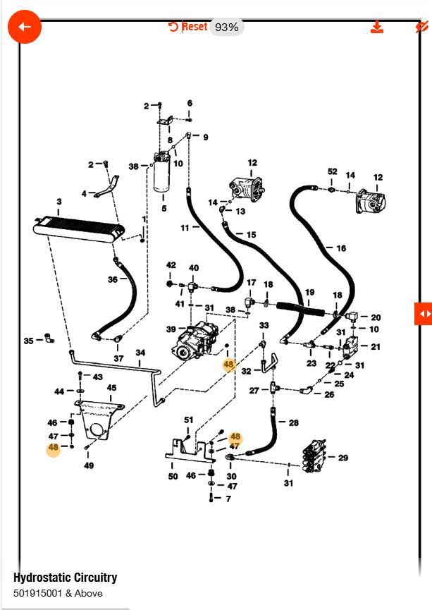

My hydrostatic circuitry looks like this one which doesn't have filter 52 unfortunately my serial number is 506738xxx

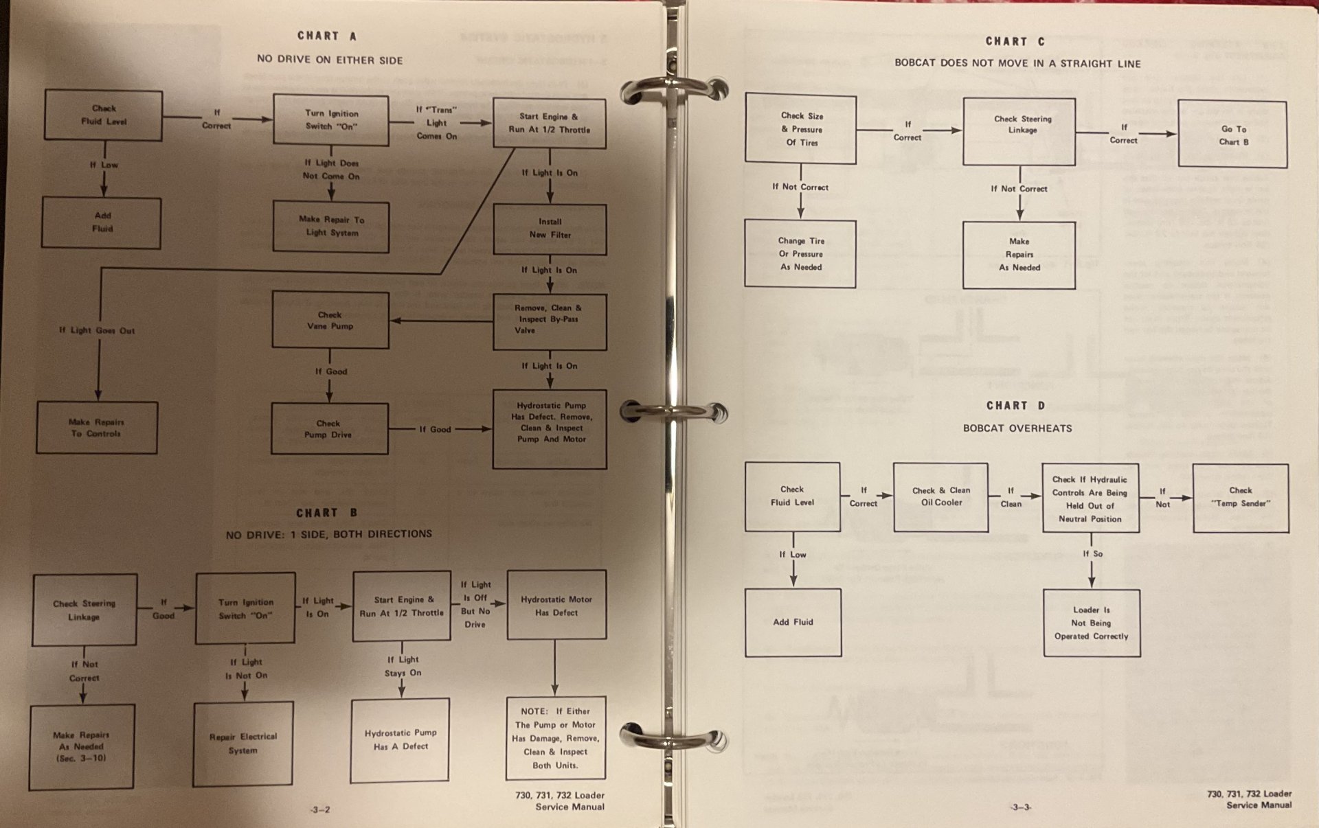

Not sure how much this will help you but this is the troubleshooting chart in my manual. It’s for the 730 series machines but for all intents and purposes your hydrostatic system is virtually the same.

Not sure how much this will help you but this is the troubleshooting chart in my manual. It's for the 730 series machines but for all intents and purposes your hydrostatic system is virtually the same.
ok great thanks i'll work through it.
