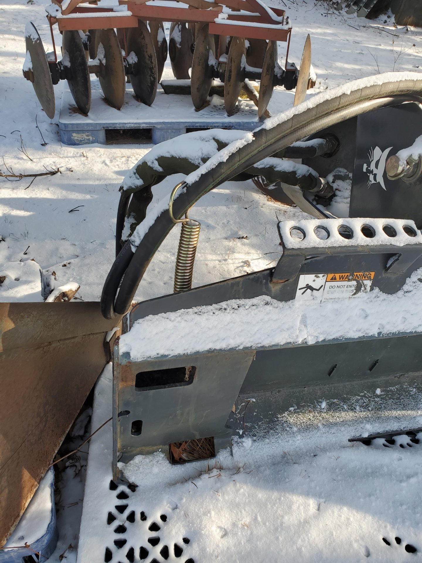

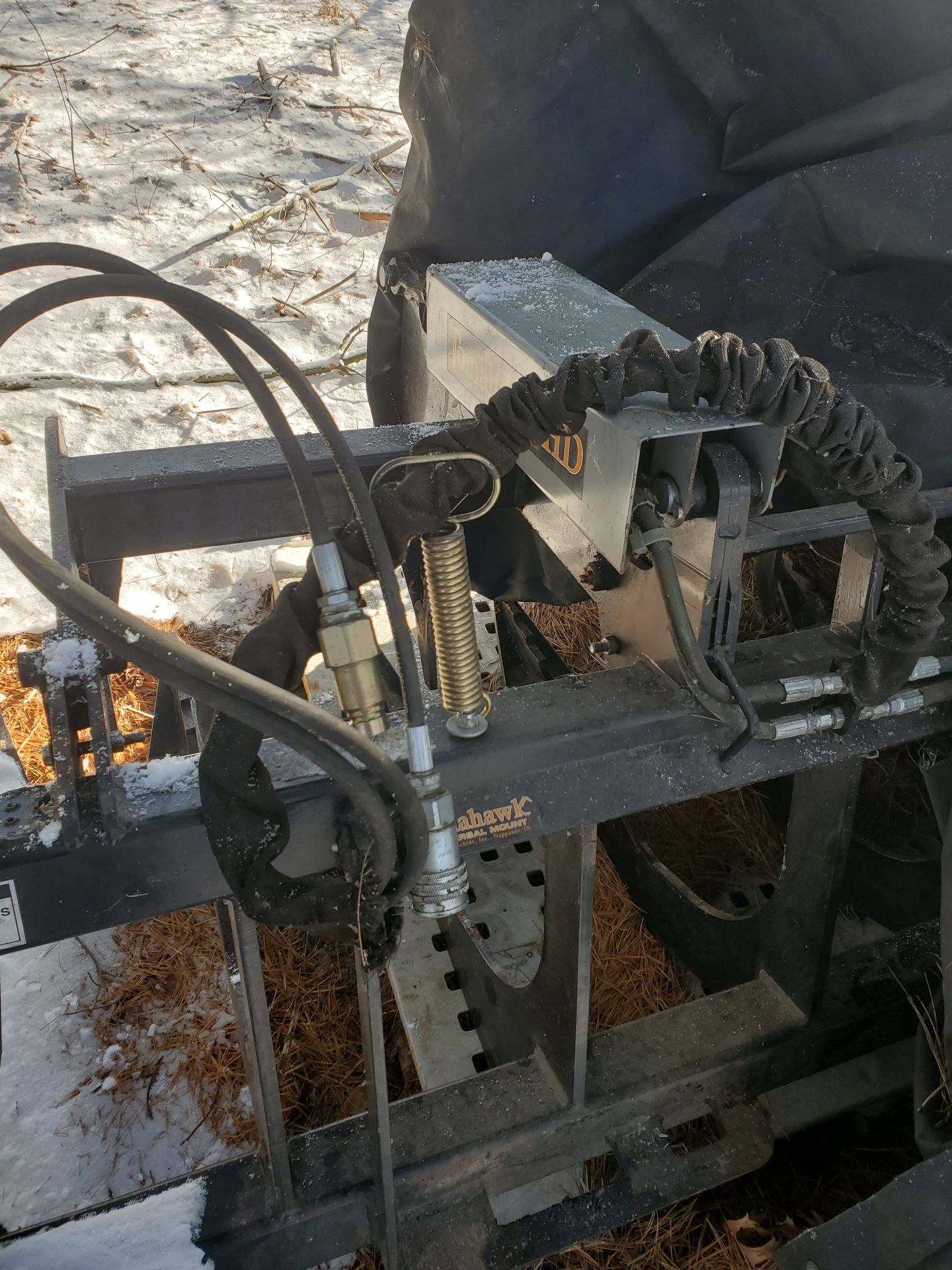

One other point to consider, look for hydraulic hose location on the grapple to prevent pinch between the bobtach and the left boom arm. Very ease for hoses to drop in there…tilt back …then crush. I had to buy a hydraulic hose holder springy thing to attach to the grapple to keep the hoses out of the pinch area.
Can you post a pic of this set-up please? I always worry about this.
Thx
Here are 2 pics of the hydr hose keeper on a auger and a grapple. You mount the hose keeper wherever you feel you need it to keep dem buggers out of the pinch area.
