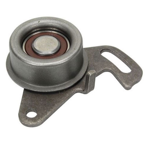

I just had mine break and I don't think it hurt the valves or piston. I was told it is an non interference engine. I am looking for a tensioner since bobcat parts told me it was $578 thru them.
Did you find a tensioner somewhere else? details? I would expect one for an automotive (dodge colt, etc) application should have worked, but would be nice to hear details of what you found.
I replaced my timing belt tensioner with the belt as maintenance before it was a "broken" problem, the bearing was loud. I did not go the Bobcat route for the new one and recall getting the automotive one only to find the bracket was a bit different. I gave both of them to a welder buddy of mine and he grafted the old bracket section necessary to make the new automotive tensioner work. At the end of it all I had a nice new tensioner at a fraction of the Bobcat cost.
Nice path taken @dfb awesome that you are all good. I was wondering if anyone else have found a matching part for those who aren't gifted welders or have friend who are?
