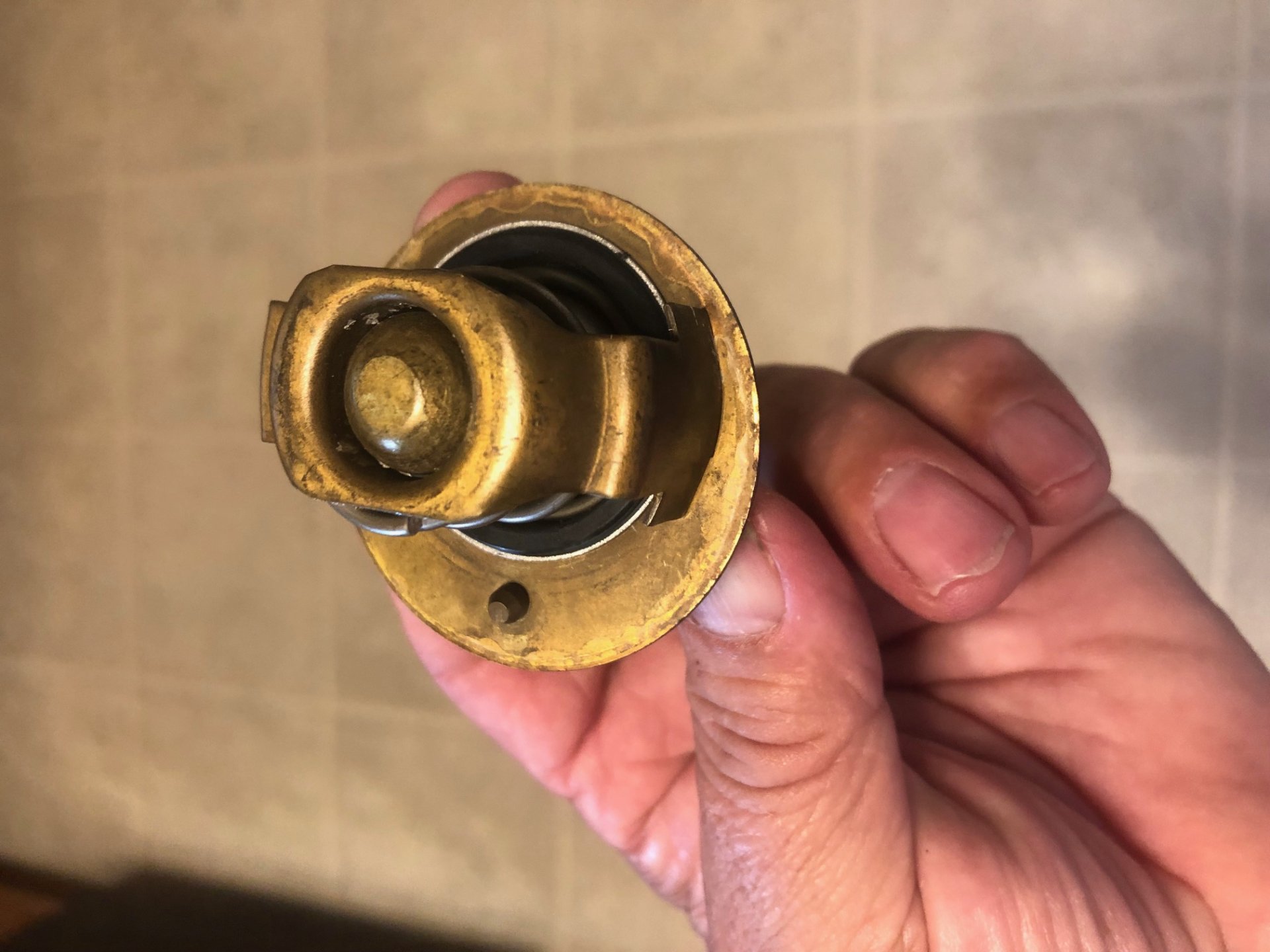

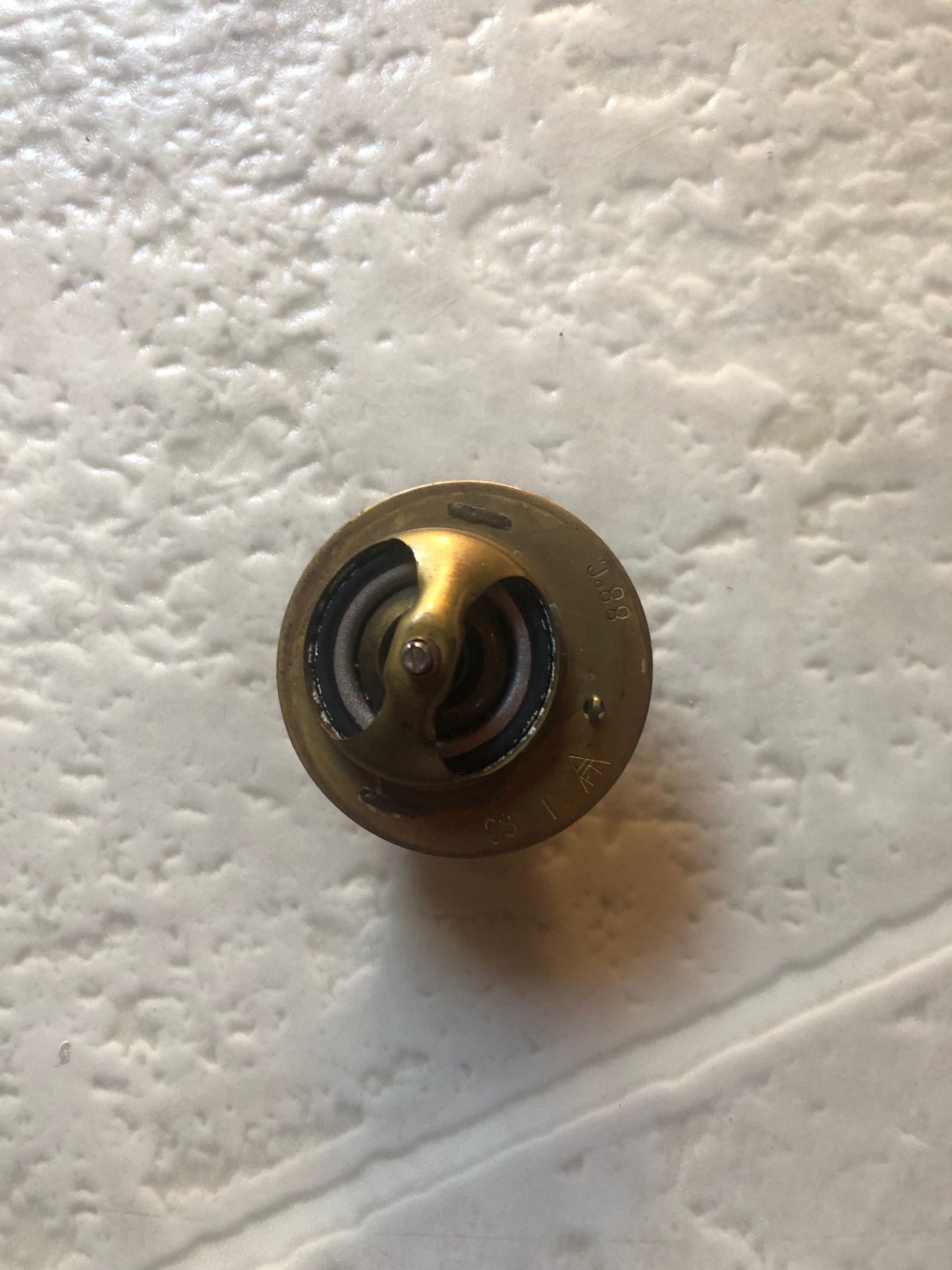

I found what I believe was in the 642 machine in a box. was wandering why it is offset? I put it in hot water and did not open up. The only numbers on it is 88C and 03 anybody have any advice on it my local parts store told me to go to Bobcat.

88c is the temp. in centigrade which would be in the 180 ish F. range.

That's a generic 600 series thermostat. I have the bobcat 642 the ford version and went through this whole deal with the bobcat dealer. First round they gave me that unit. I guess it can go in any of the 600 series units motors is what I was told. The actual one for the ford version opens at 190 degrees.
The actual mitch. Motors opens around same. Along with diesel motors so that one will work. Operation temps are 170-220 degrees but bobcat dealer says you usually don't want to see them much over 200 degrees but can expect 205-210 on very hot days and expect to let the units to cool/take breaks on hot days... when you start pushing the 220 range that's when you get warped heads.... figured I better share this info because it was some of the most frustrating info to find on the 642 series. There was alot vague info out there.
