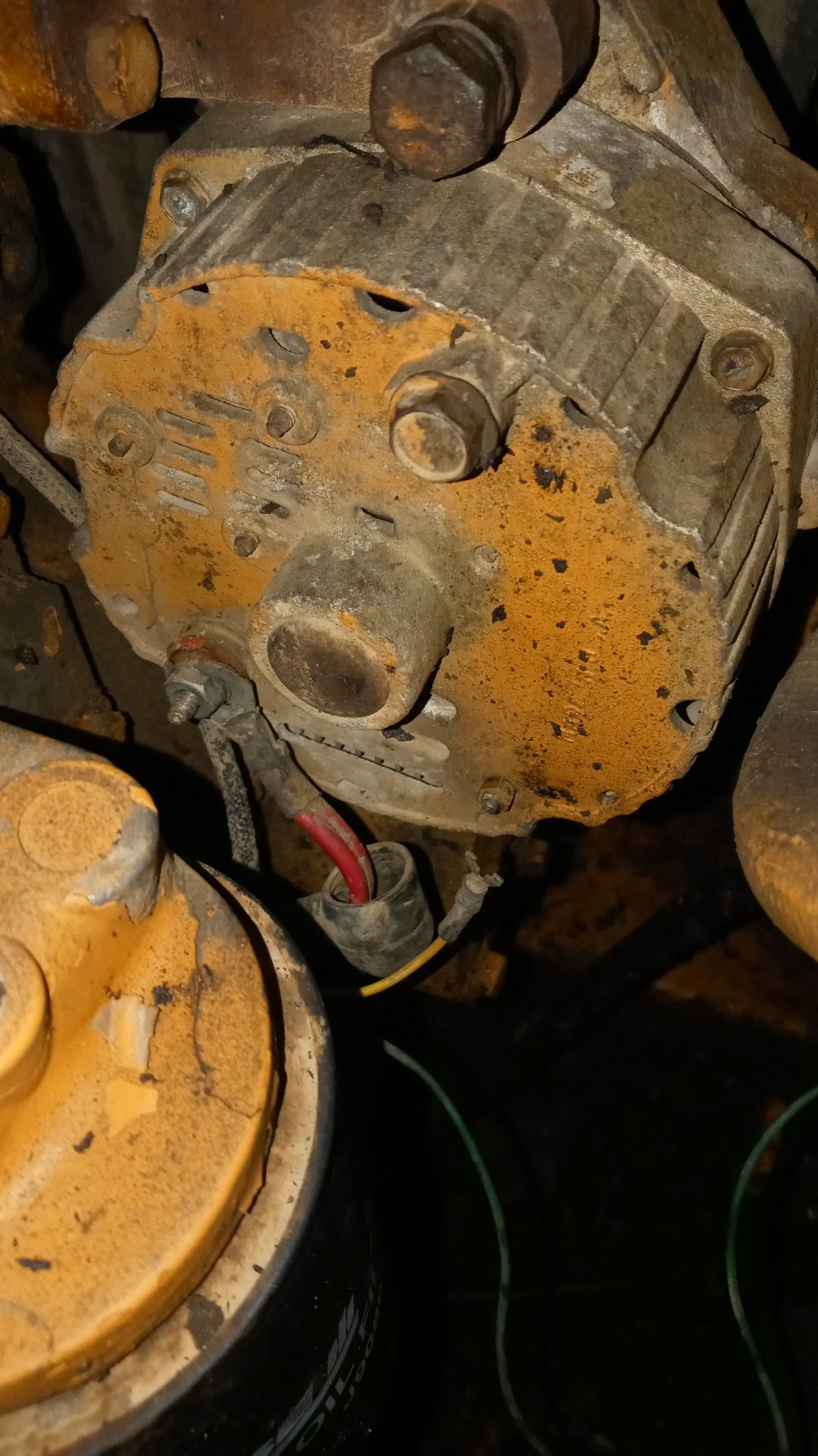

Where does the little unattached wire go

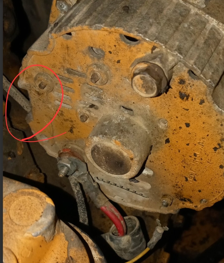

If you take a multi meter and check that wire... Is it 12+? Full time or just key on? If it is near zero volts, does it have continuity to ground?
In the circled area... Are there two (or three) 1/4 inch spade terminals?
1,306
some alternators have a sense wire , the wire is supposed to go to something that is hot when the switch is on that is the furtherest point in the machines electrical circuit. What is is suopposed to do is help eith getting the alternator to charge the circuit with the correct voltage at the farthets point. It also lets the alternator start charging on start up at a lower rpm.
1,306
get a meter or test light and turn the key on and check that hanging wire if it gets voltage, at least tape it up to prevent it from shorting to the frame ground. if it does get power chances are it is the sense wire from where it is hanging.
