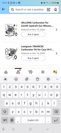

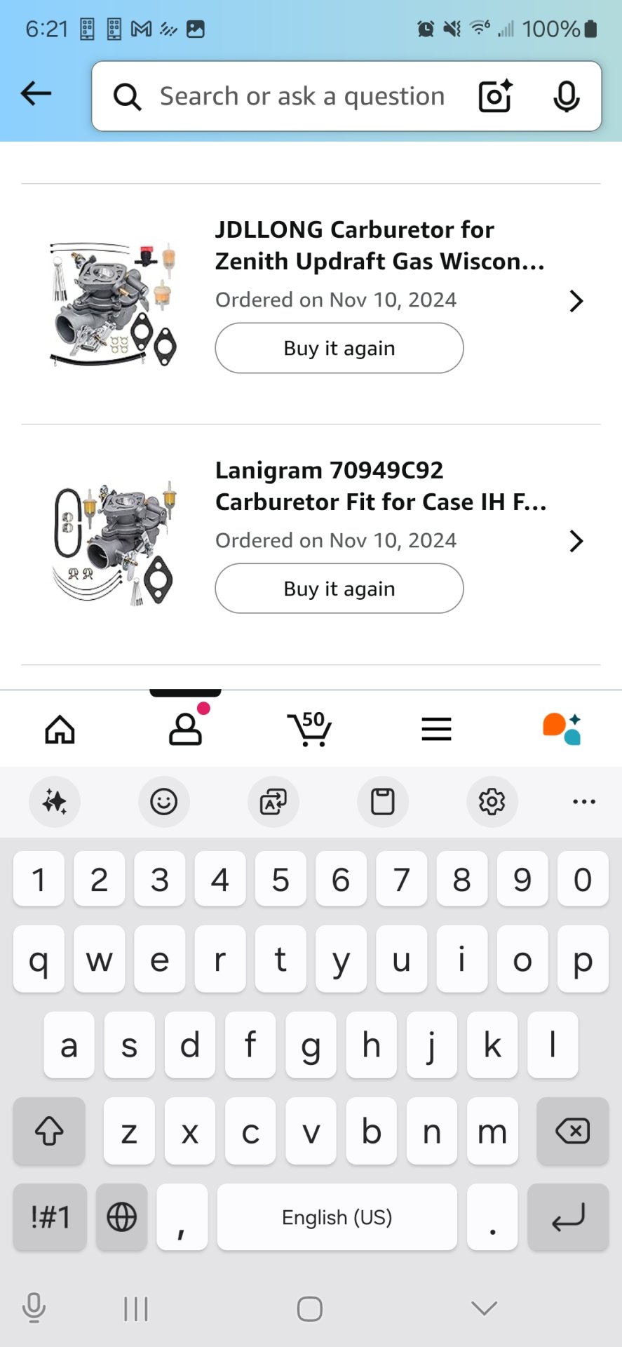

Amazon shows that carb for a 196 cc engine--I doubt it could ever supply adequate fuel to your 1700 cc Wisconsin motor. Might be worth taking another run at a larger carb. I used this from Amazon: Carburetor 6632616 Compatible with Bobcat Skid Steers Loaders 642B 742B Mitsubishi 4G32 engine. My problem was a carb that suddenly started running very rich, but that had always smelled too rich anyway. Couldn't find specs for float height anywhere. Carb otherwise was good, but I tried and didn't like shooting in the dark on float height. So tried the above. Wasn't a simple swap, but not too complicated for my 4g332 engine, 1600 cc. There are endless vendors selling apparently identical carbs. This is a 2 bbl carb, similar to the original, where Bobcat had blocked off the secondary throat, so I did too. I assume it was sized for 1600 cc at ~ 5-6000 RPM, not 2800. I would like to be able to measure the mixture richness to make sure I am not too lean--I suspect these carbs are made for fuel economy in a car, not max torque in a bobcat, so likely the main jet is a little small, but just a guess at this point. What did you buy to measure your fuel richness with? And how did you know what size jets to try in terms of threads and overall dimensions? Having no way of knowing anything about the carb I now have is a worry--I will never be able to buy a carb kit for it, nor know float height. I think it is basically disposable for $100. I will never put enough hours on it to matter if it is of reasonable quality. It seems to be.
I bought these carbs off Amazon. My Wisconsin runs great with it. Can't remember which out of the 2 I actually used. Only a few mods for the throttle linkage

I installed an oxygen sensor and afr gauge to ensure proper mix.
I installed this for fuel ratio confirmation. It works great and gives real time afr data.
