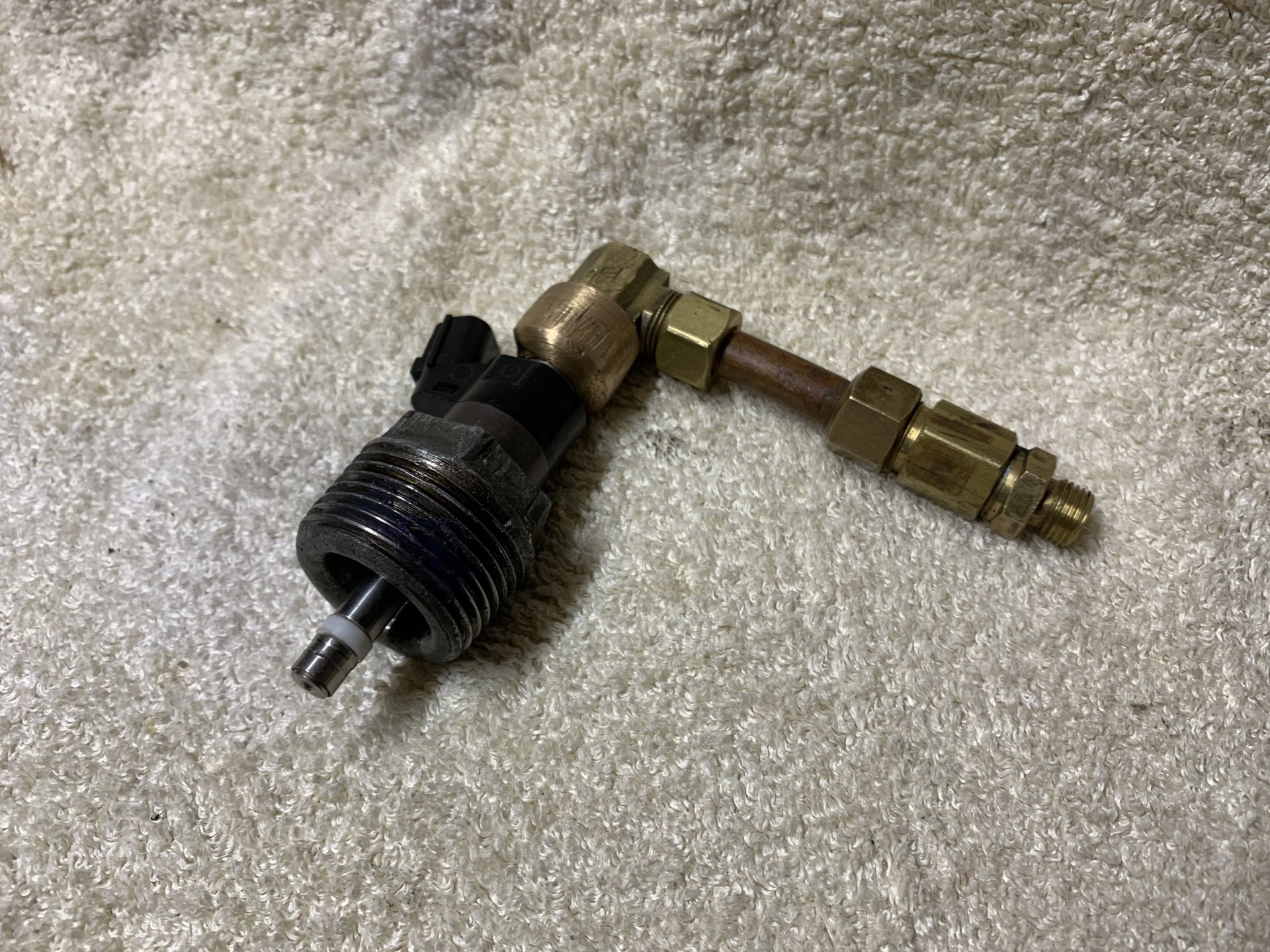

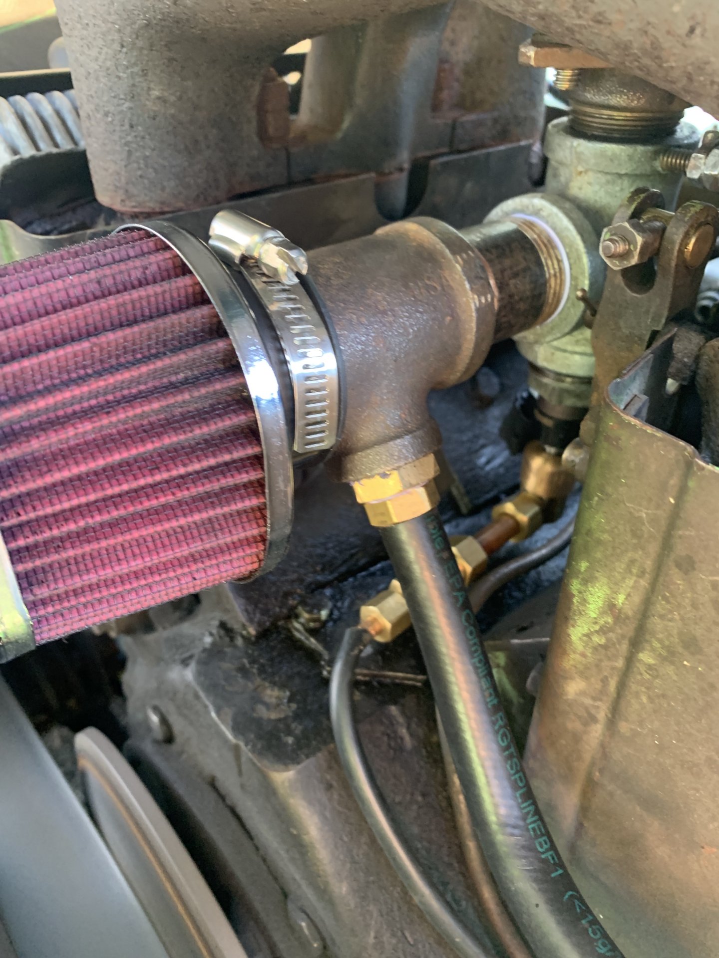

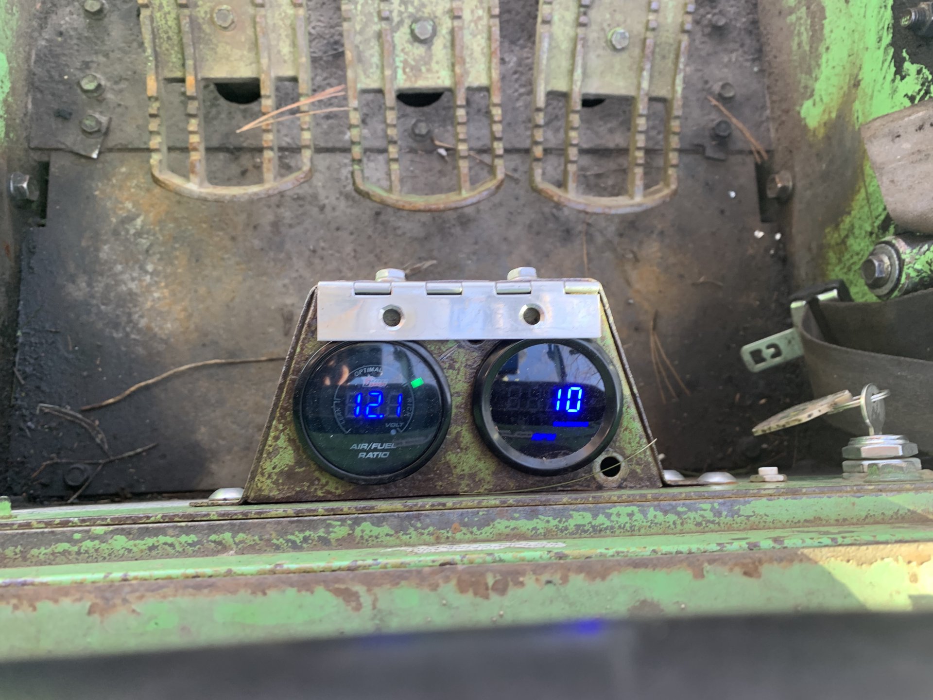

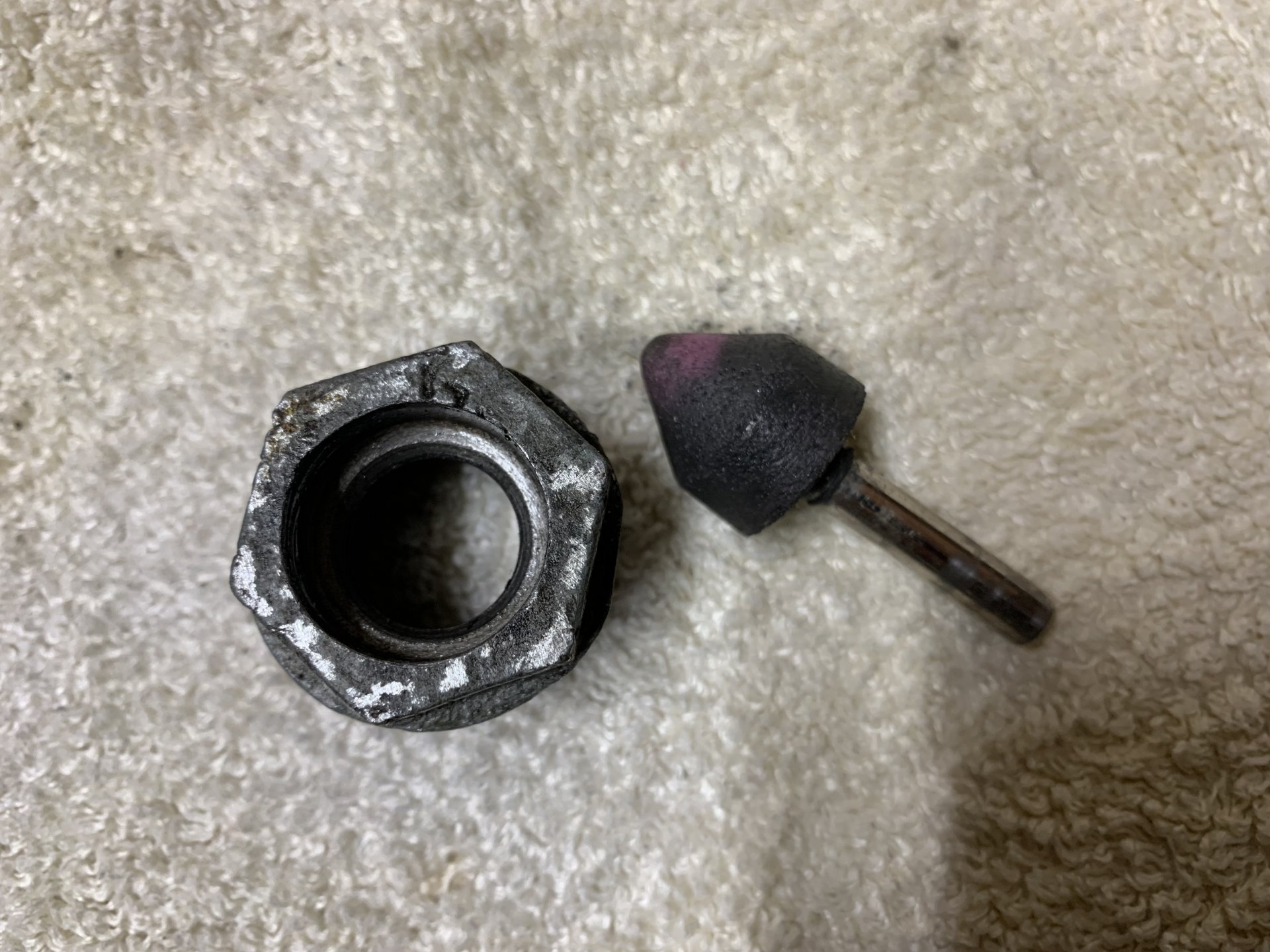

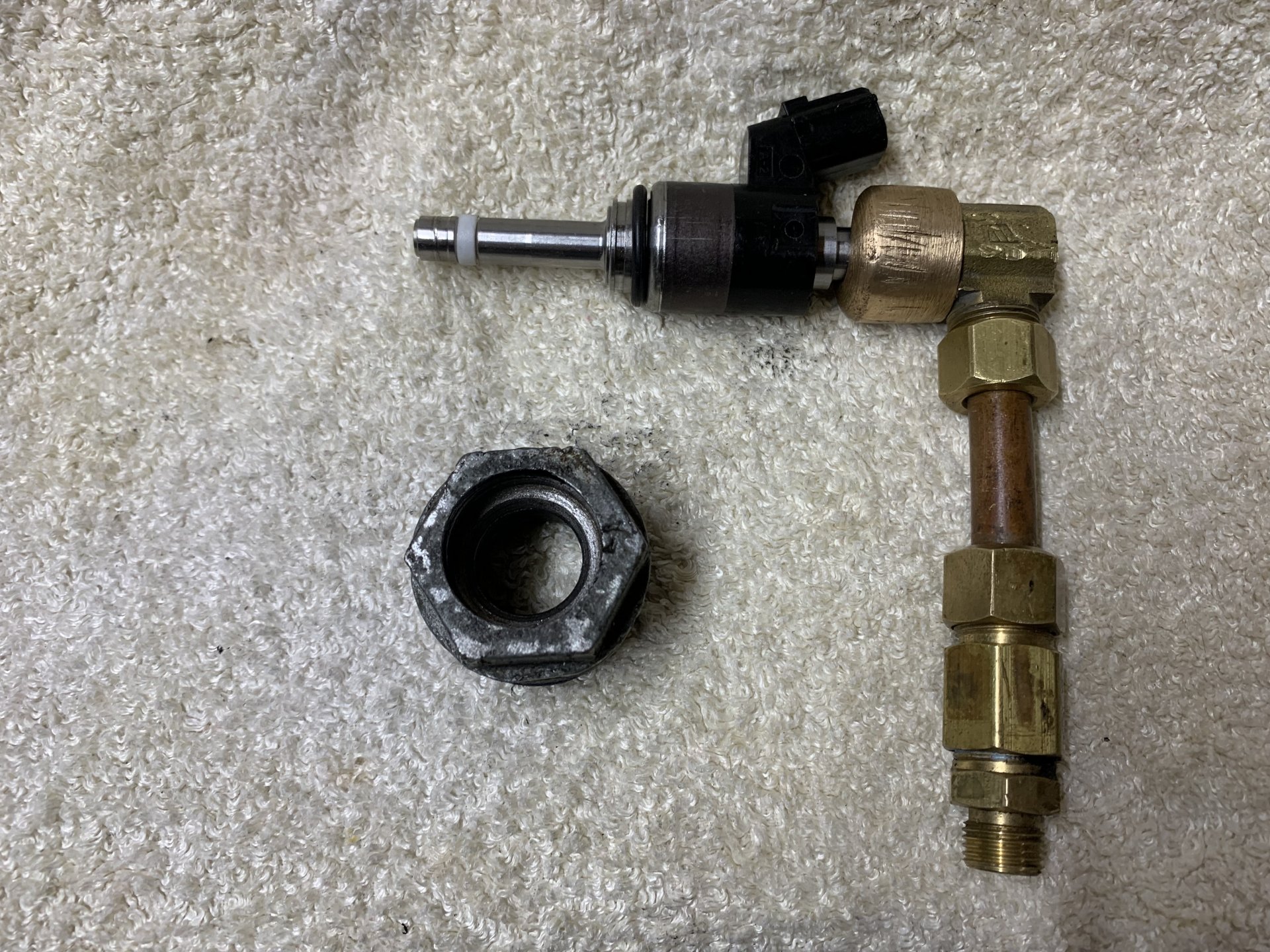

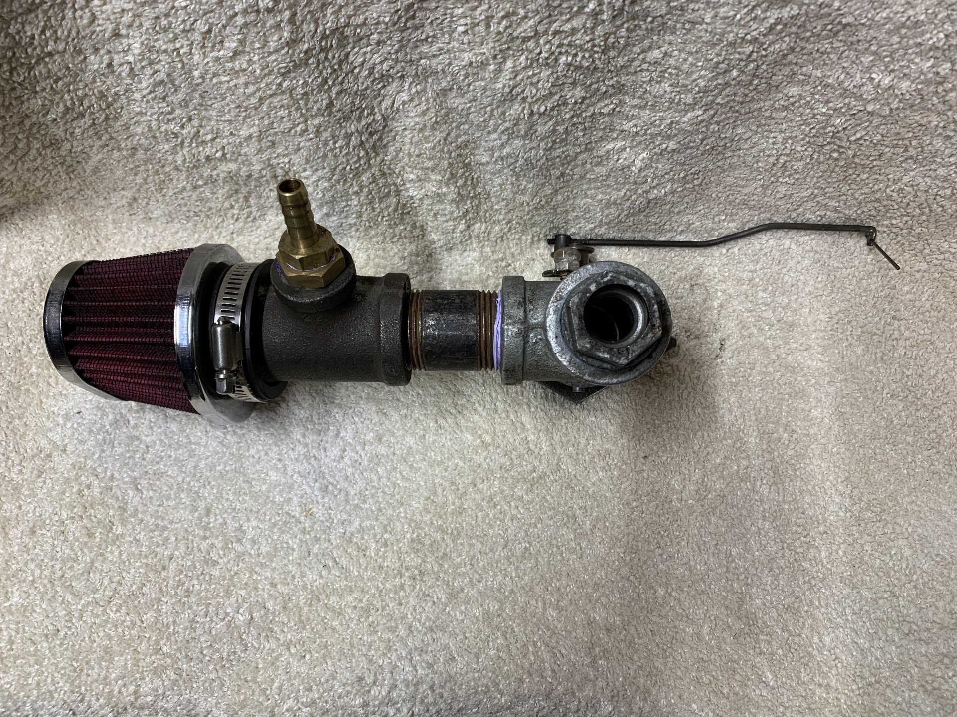

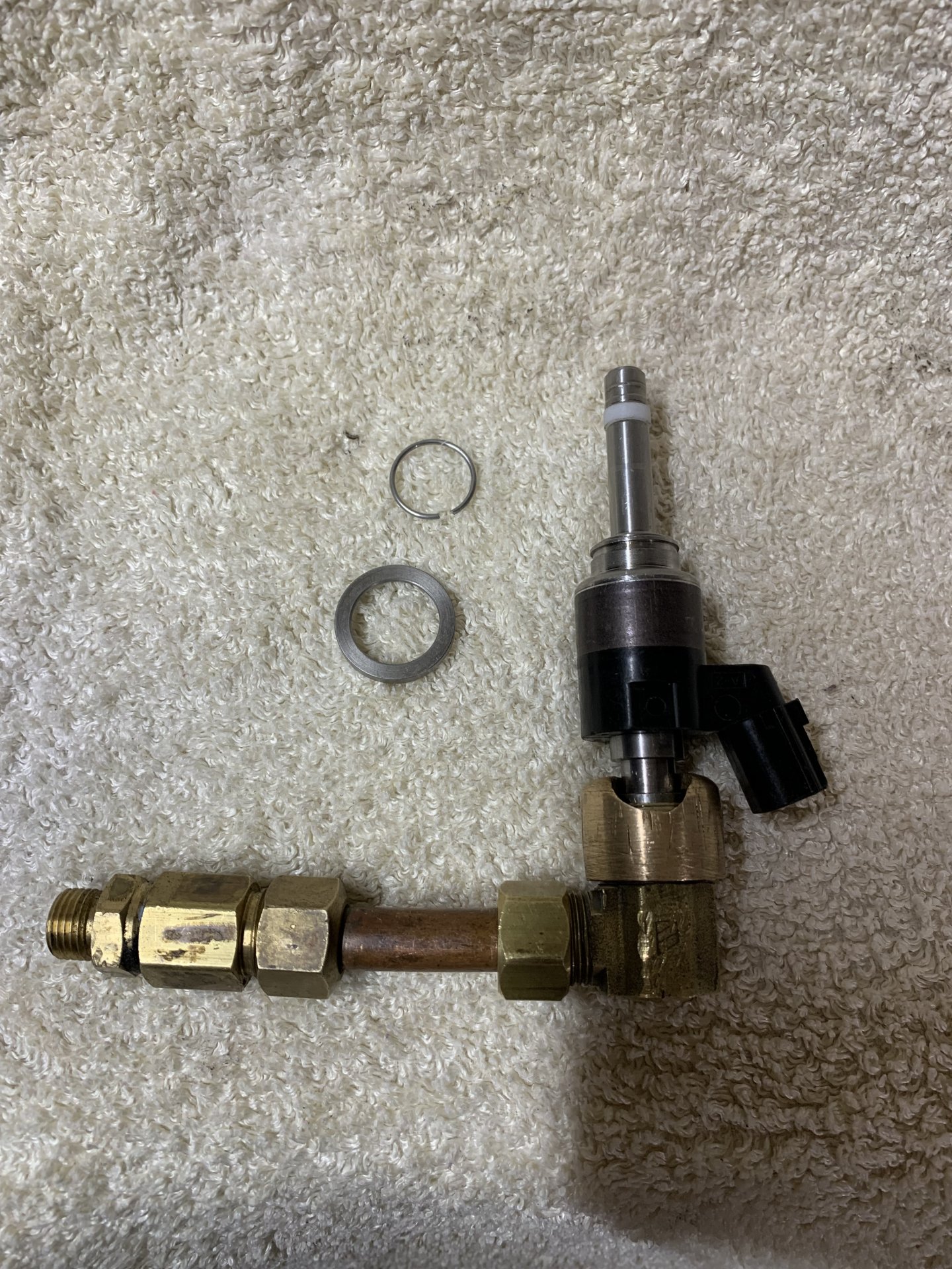

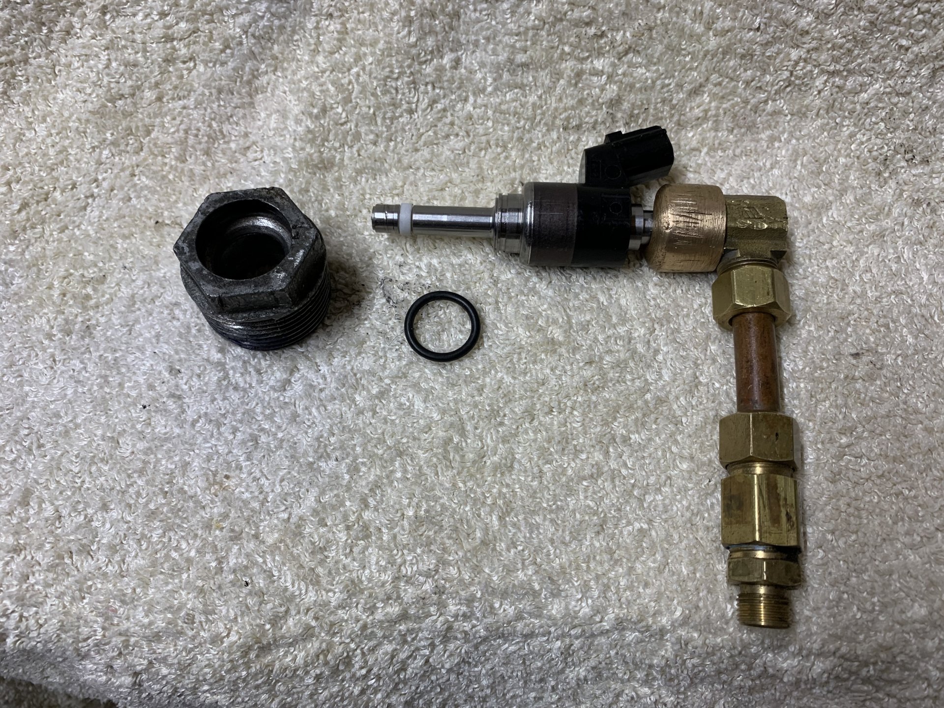

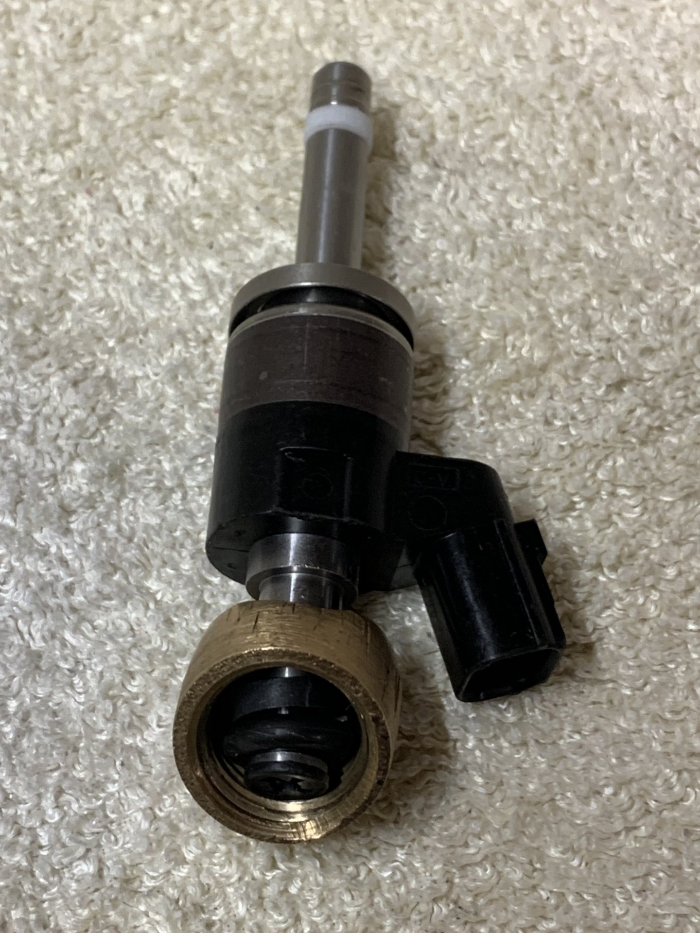

Finally, I removed everything before the intake and ordered a fuel injector, fabricated my own intake from 1” steel pipe, installed the butterfly from the zenith, installed an aftermarket oxygen sensor and air fuel ratio gauge, hooked up all the wiring and high pressure fuel pump, and got the engine running.

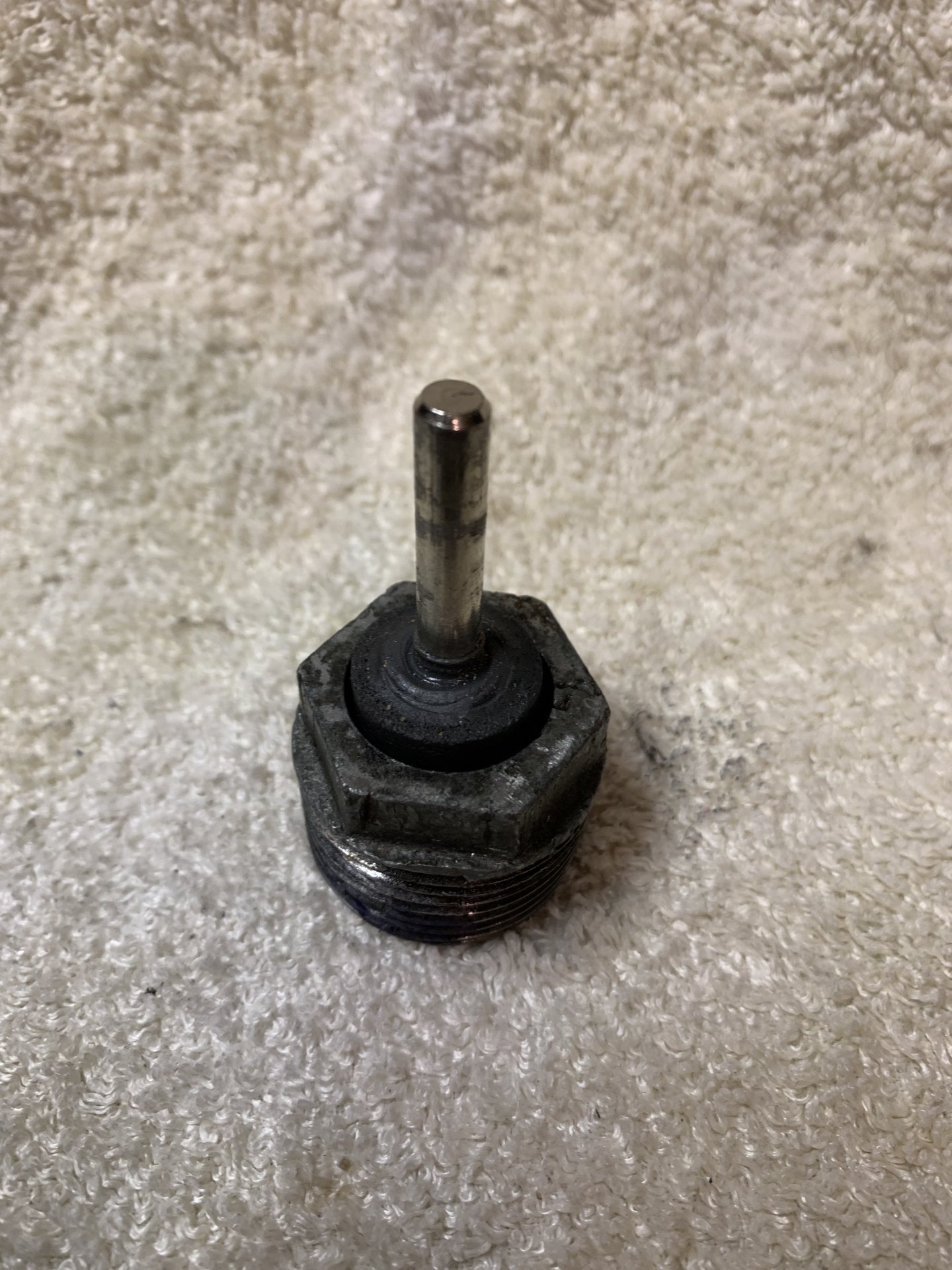

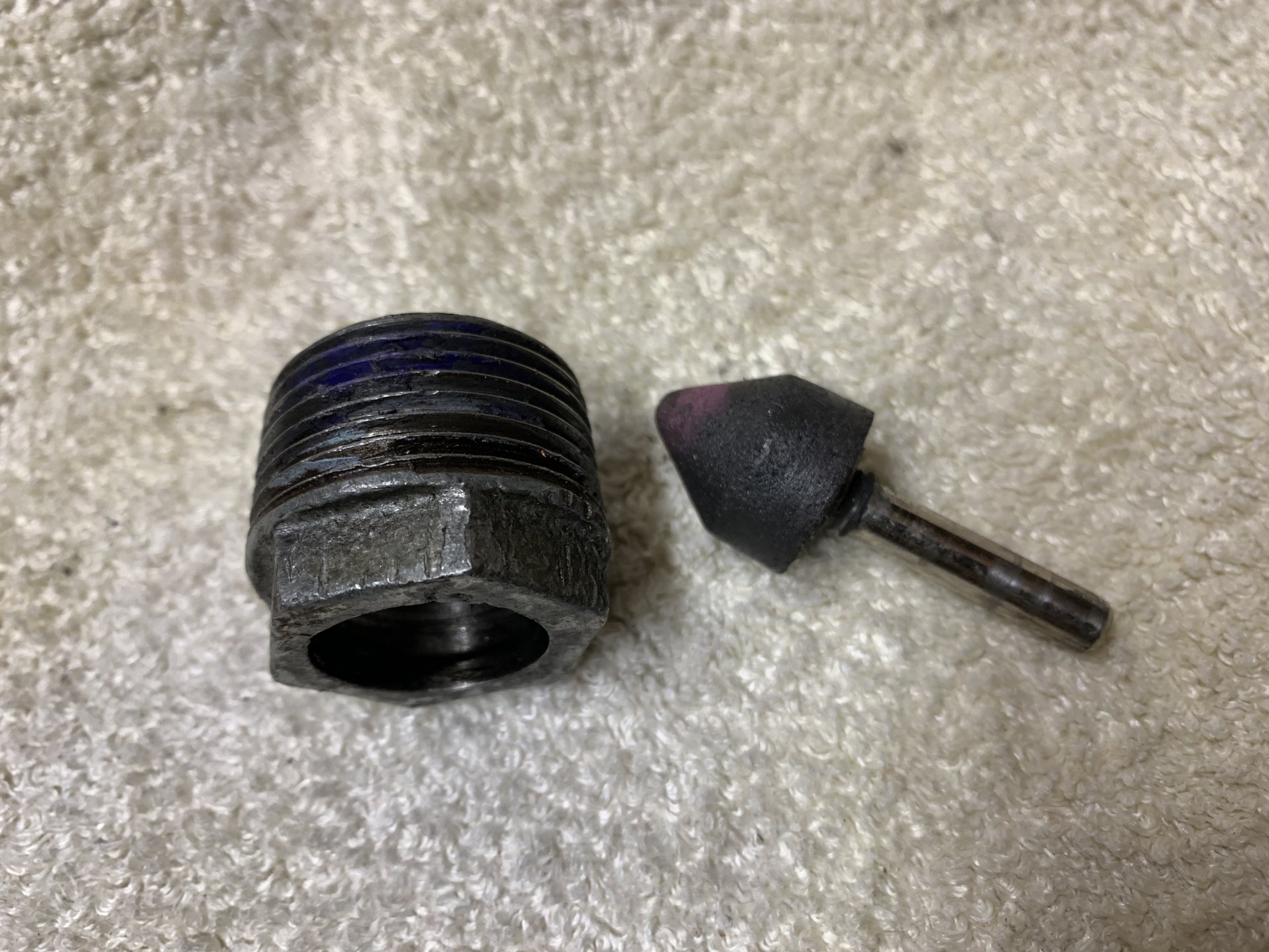

Currently, my challenge is that the injector is open constantly, and I adjust the fuel ratio by opening the return fuel valve to decrease the pressure. I can set the correct fuel ratio by setting the throttle, and then the valve while watching the afr gauge and rpm meter. It runs better than ever, but I cannot change the throttle unless I get off the machine and turn the fuel valve as well.

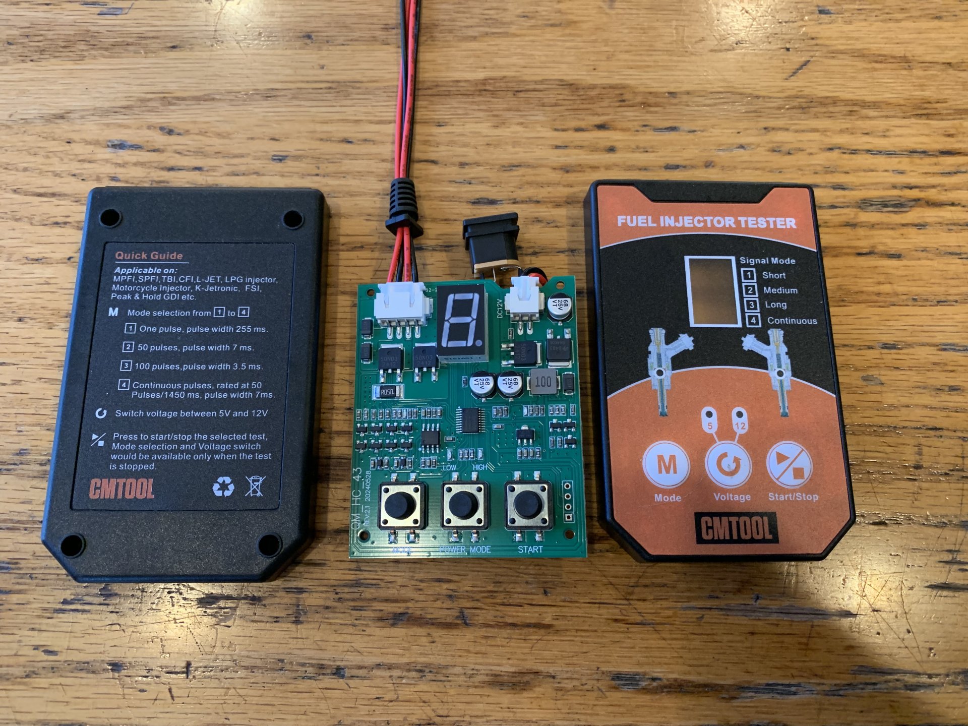

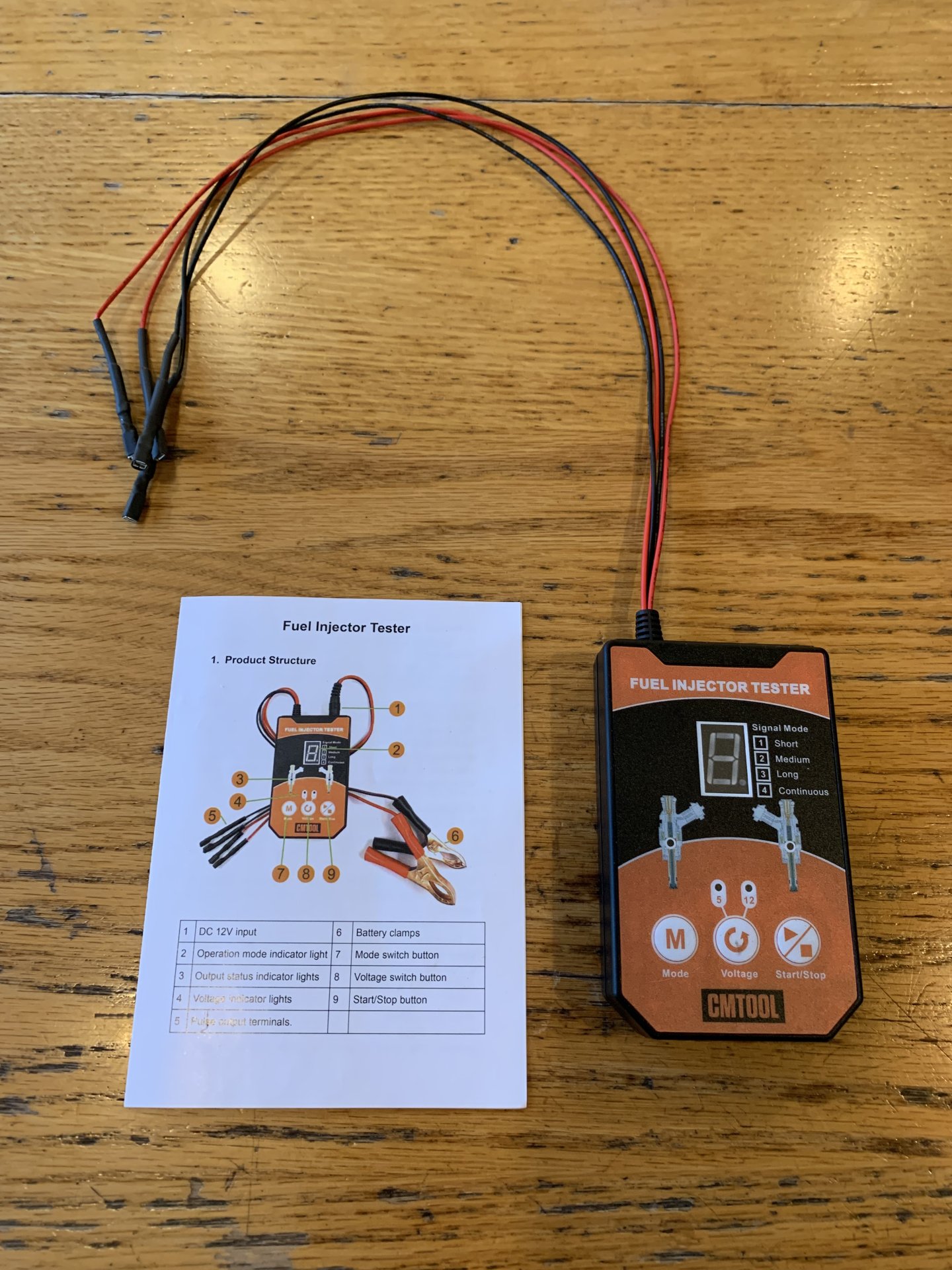

I toyed around with a 12v Pulse Width Modifier with limited success, but burned up a fuel injector as a result. I gather that the fuel injector solenoid overheated. I have looked online for a dedicated fuel injector driver, but all I can find is a fuel injector tester. I ordered one, but I do not have much confidence that the device will be able to handle the longevity I am requiring from it.
What I think I need is a throttle position sensor that works together with an adjustable
rate, 12v full-power pulse sending unit. I am a technical dinosaur with my hand stuck in a computer generation cookie jar. Please, anyone with some smarts in this direction deliver me from what I sense is an obvious answer just beyond my reach!

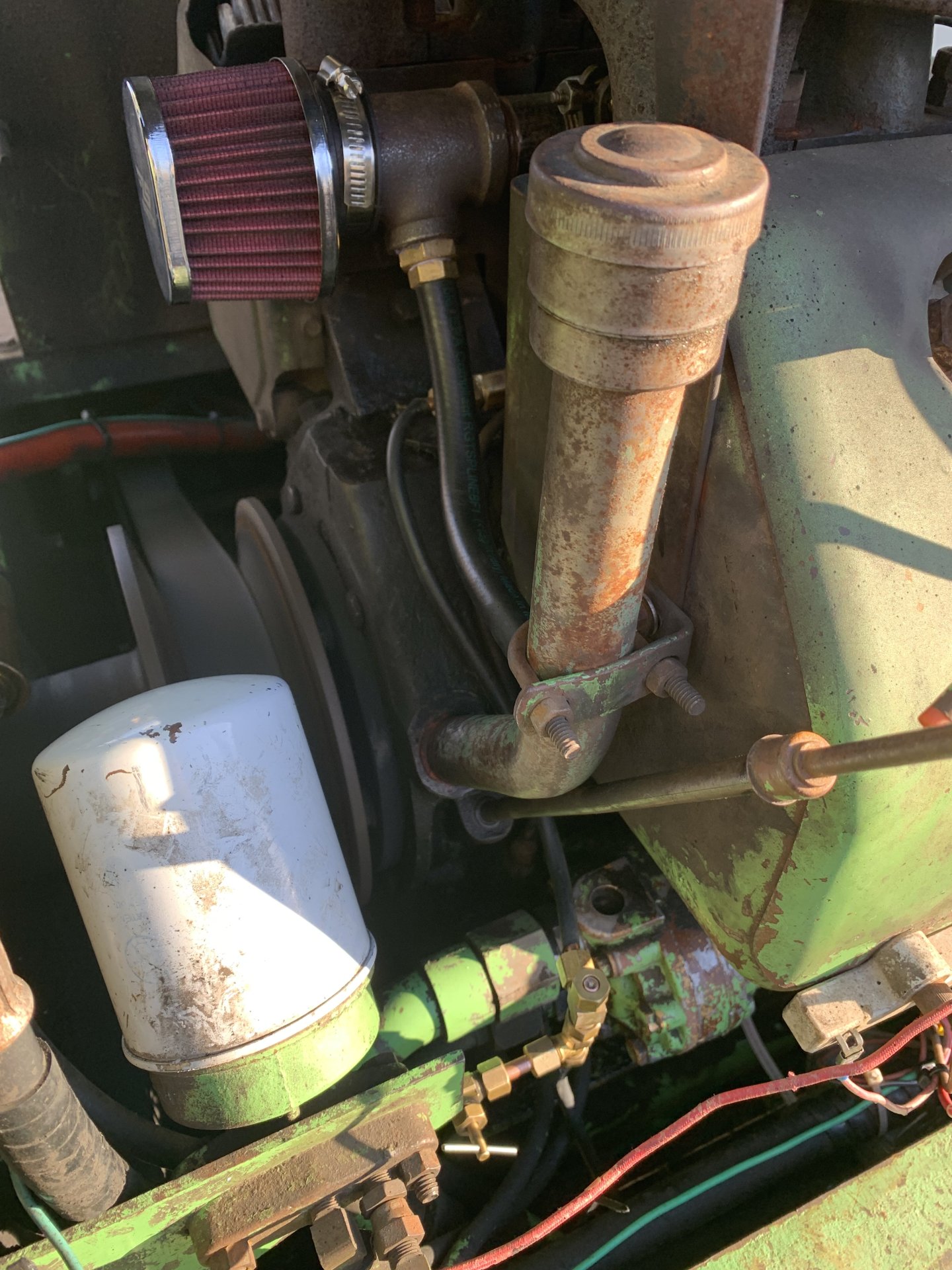

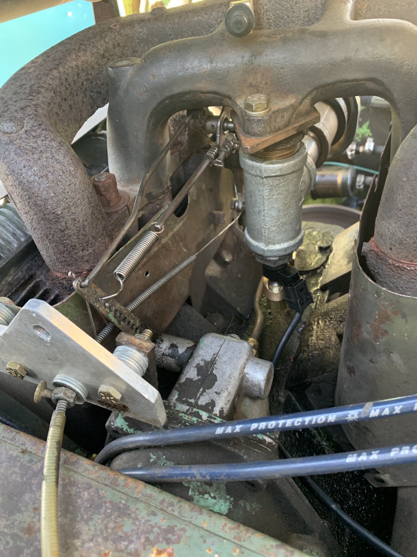

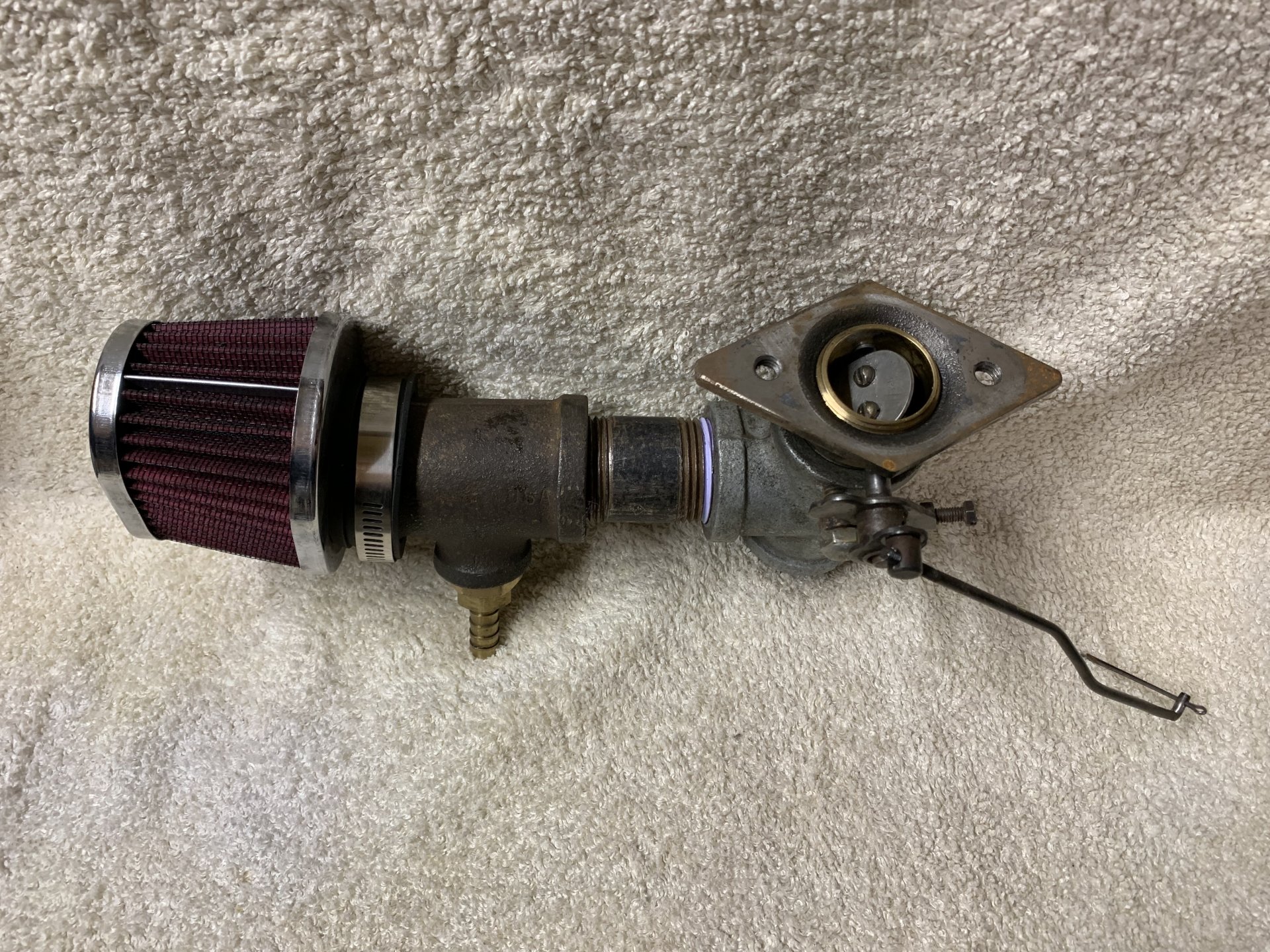

I made my own retrofit. I am pretty handy with the physical aspect of mechanics, I'm just half baked when it comes to electronics. I have no MAF, nor do I know how to make one work with an injector. Any retrofit I have researched is not designed to work with my engine. I would love to work with a budy who knows these types of systems, but so-far y'all are all I have to help me in that regard. Here are a few pictures of the system.

Oops, the pics didn’t load…

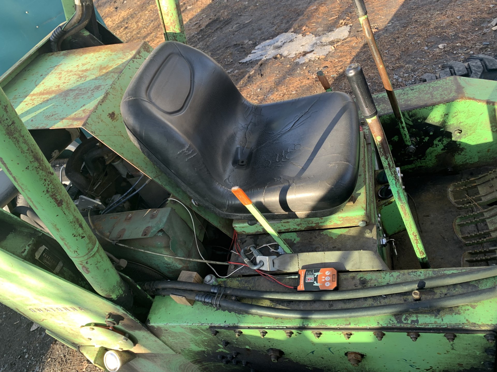

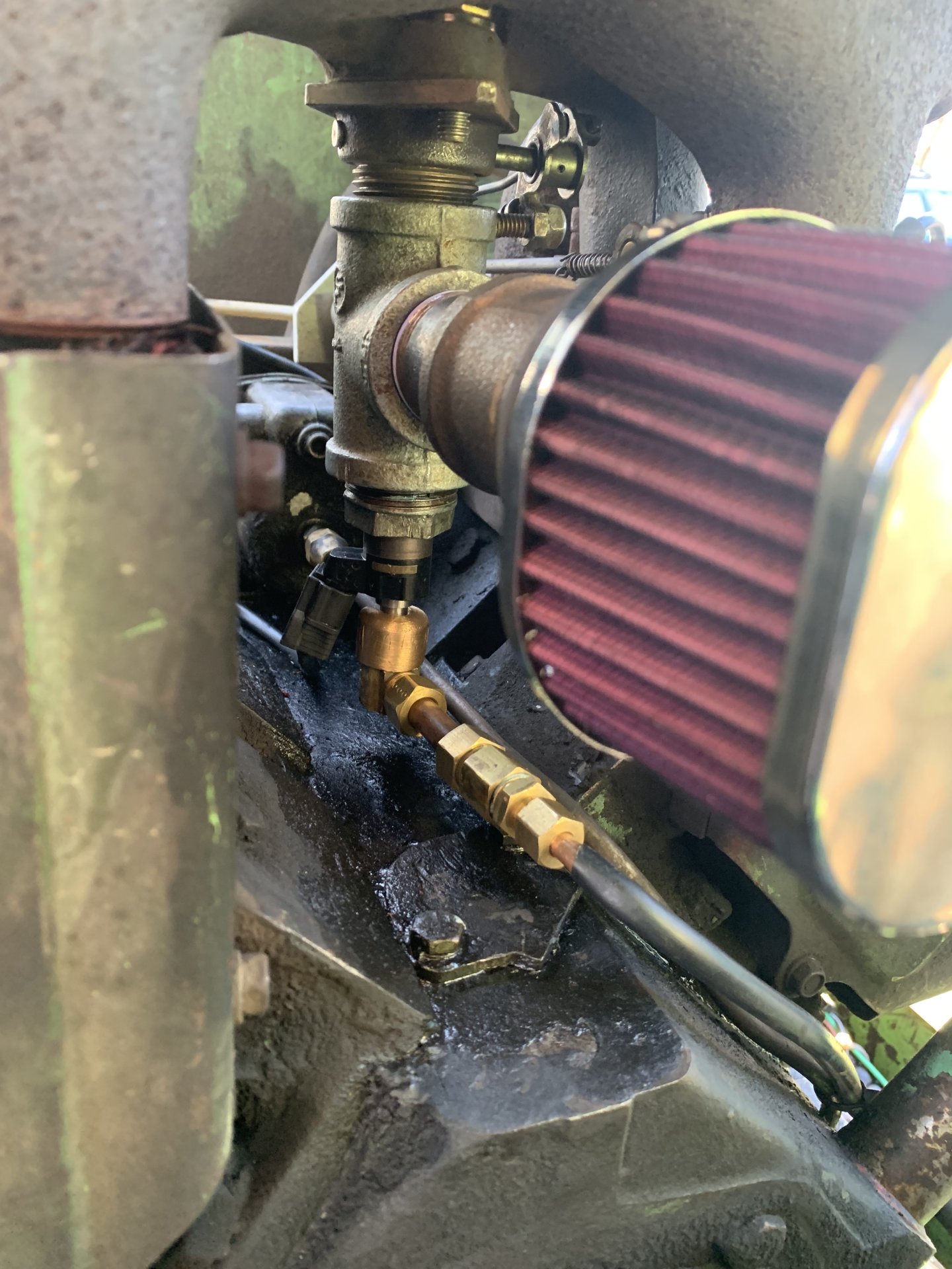

I installed the fuel injection system today along with the injector tester.
The tester has a continuous pulse mode which starts when I push the “play” button and runs indefinitely until power is turned off or the button is pressed again. This pulse runs at 50-7 millisecond pulses per every 1450 milliseconds. According to my calculations, this translates to about 34 pulses per second. When I run the engine, I get about 900 rpm at this level of fuel supply. Any higher throttle and it runs lean very quickly. If I could increase the dwell or pulse rate with a variable input from a throttle position sensor or rigged up pot adjuster, I could make it work. I’m just not sure how to do it, or what components to use. Here are some pictures of the installed and running unit

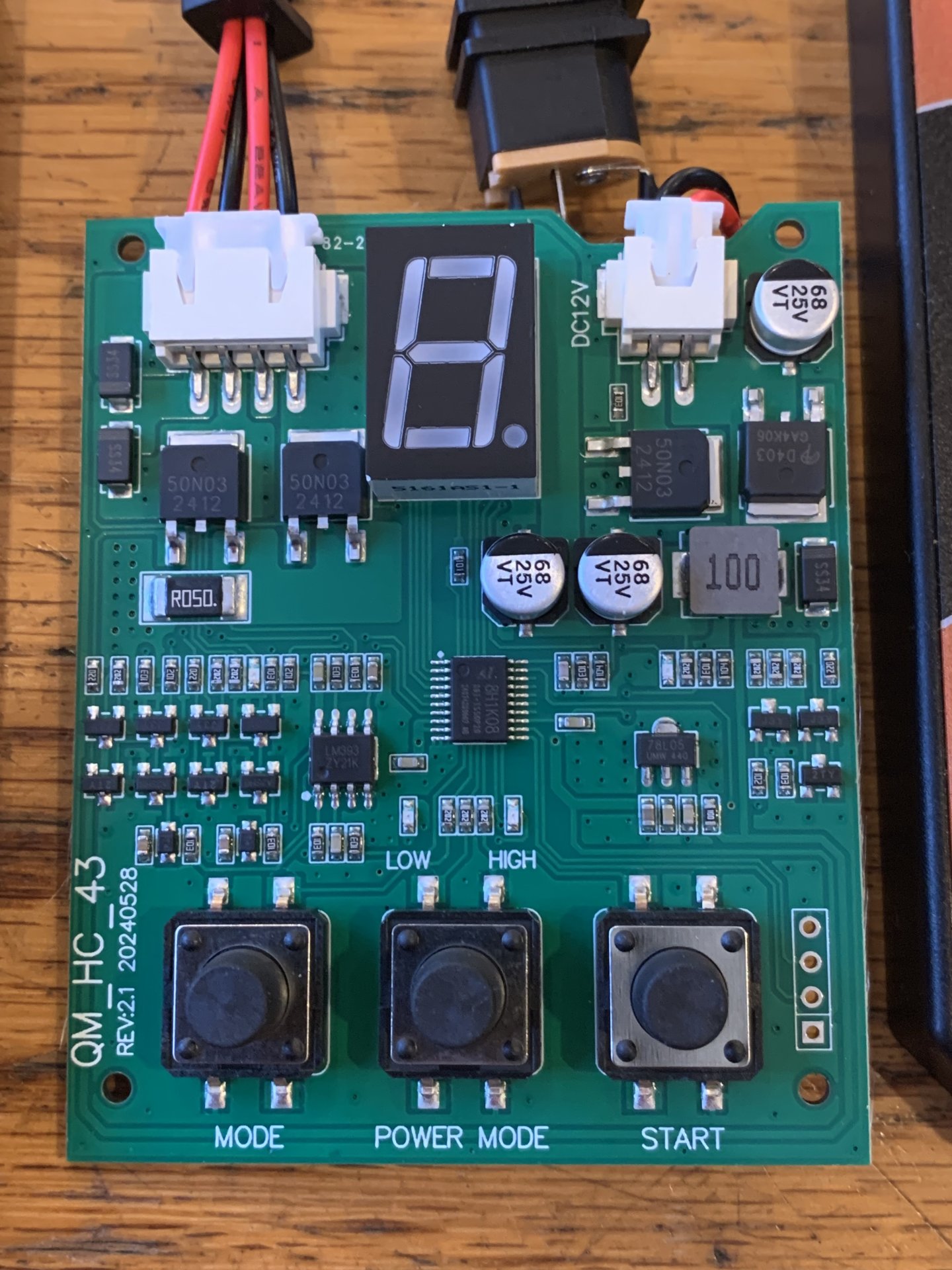

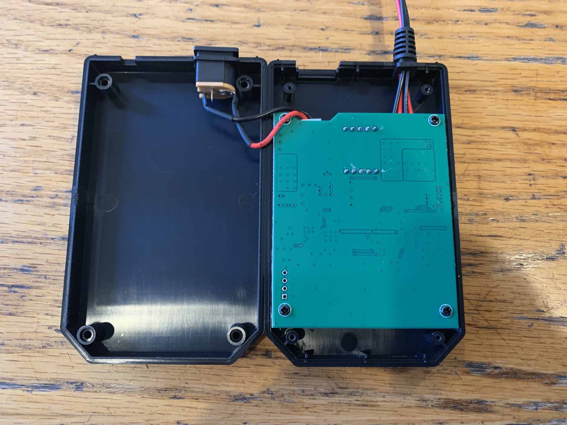

Here is the guts of the unit. Is there anyone who can help me remake this board or make another one that will accomplish these parameters?
