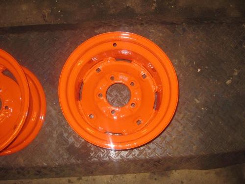

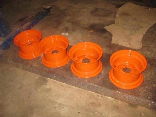

Here are a couple of photos:
As you can see they have holes to fit wheel weights, which may be a bonus at some point in time.
Two of the rim dishes are stamped from 12 gauge, while two are stamped from 11 gauge. The original rims are 11 gauge. I am planning to put the 12 gauge ones on the rear and the 11 gauge ones on the front, as the fronts will likely take more abuse.
The 12 gauge ones came from a Bolens, while the 11 gauge ones came from a Jacobsen.
I likely should have welded on valve stem protectors, but for what I am using these for, I doubt it will be a big problem. I'll just install short valve stems.
