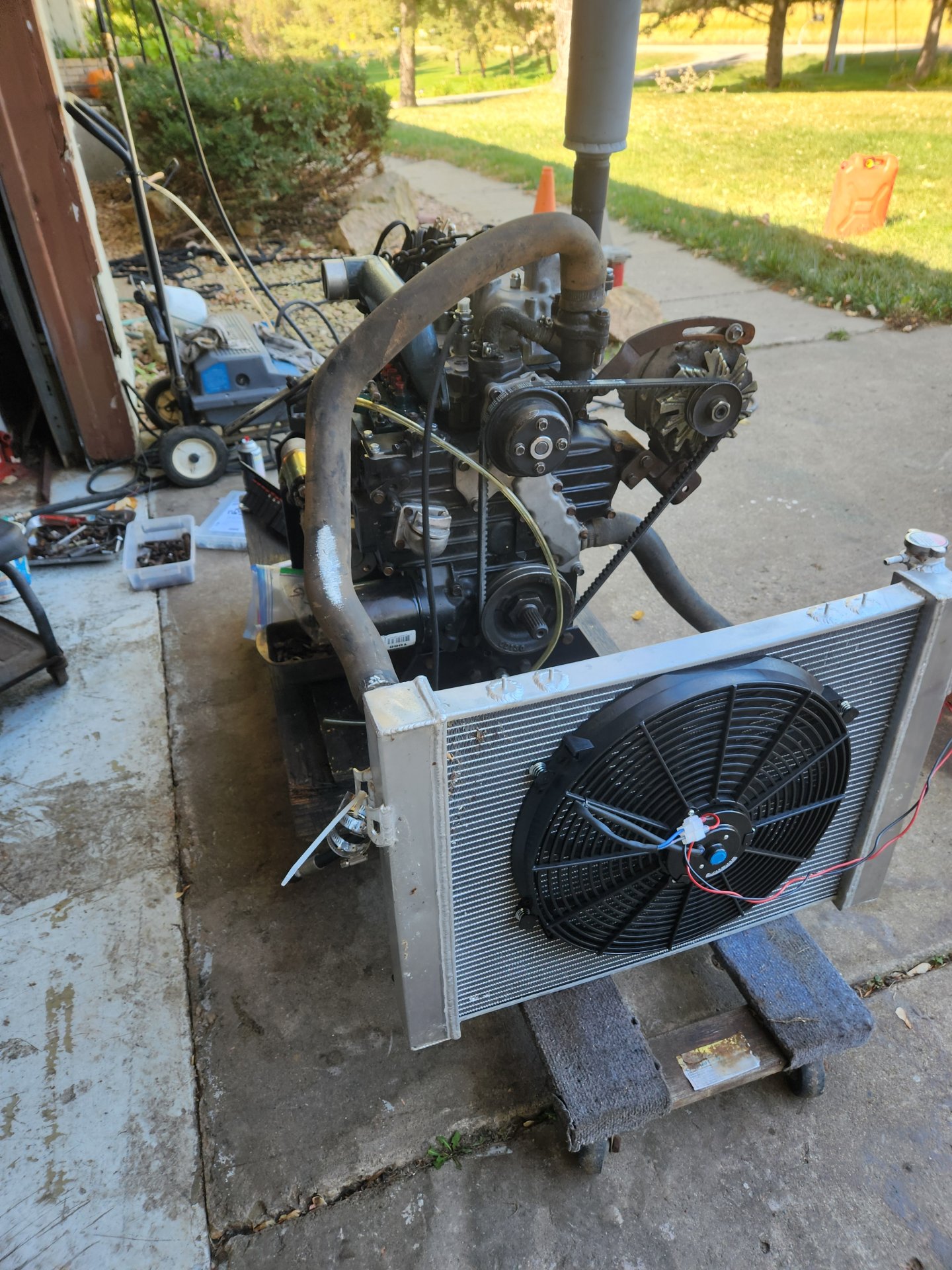

Using a test stand to run in a V1702
jp8775
Dec 24, 2021
135
  • 20241003_134225_15833477967395.mp4
    14.7 MB
Second photo is video when its running click to see. I found three water leaks (minor) and two small oil leaks. One was the rear main seal flange, just needed a retorque. This one would have required that I remove the engine. I was also able to run it for an hour and then retorque the head and reset the valves and get that out of the way. Now the engine is ready to go into the Bobcat. I have 9 more engines to rebuild this winter for 4 more 743's. All I need to do is push the bobcat intro the garage in install the rebuilt engine. I also have the motor mount required to swap V2203 into you unit. I also have the front mount to use the sheet metal pan. The 743 mount blots to the cast pan which are hard to find. Sheet metal pans are easy.
