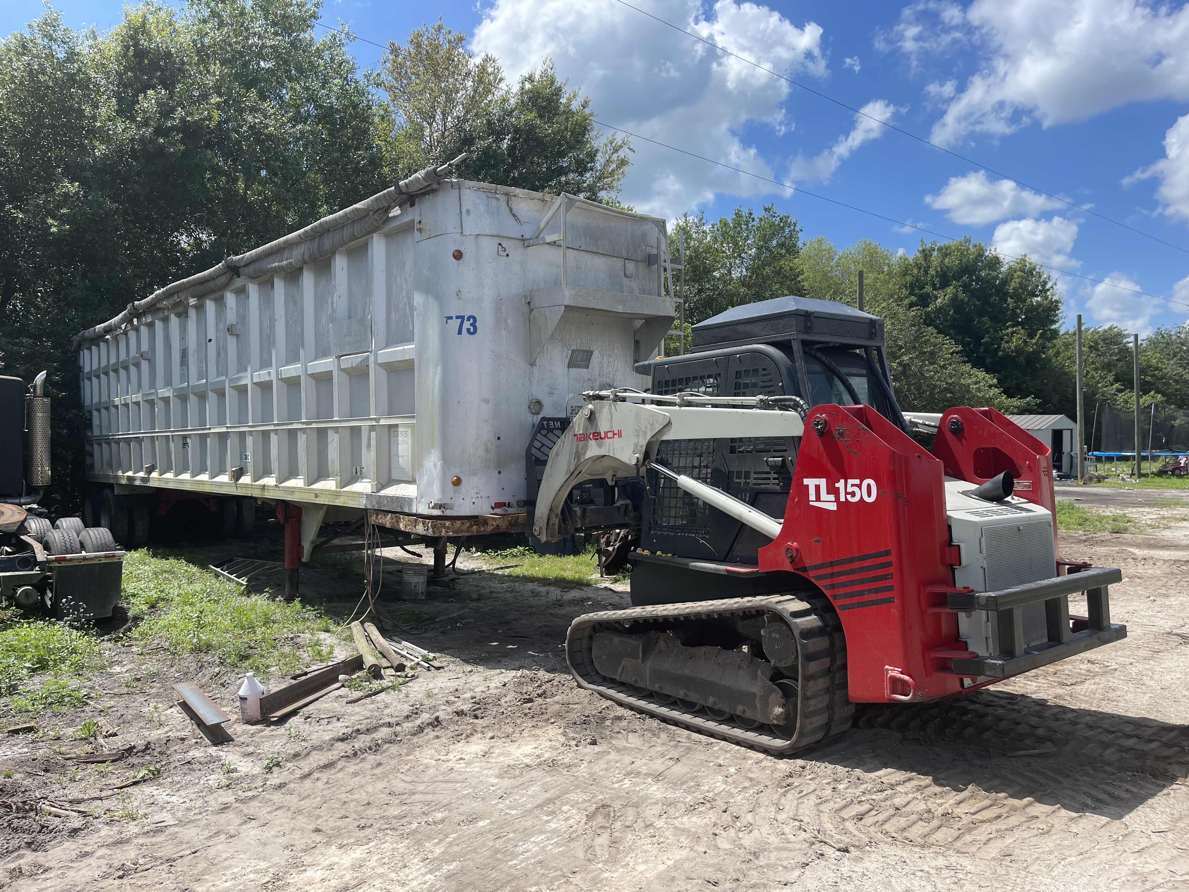

I bought one back in January , pretty stout machine , sold my asv rc85 .. big upgrade .. but was hoping a member on here has experience with one.. as I went to connect my grapple and it seems when I use the pedal or joystick buttons it pressurize my hi flow line as well as the low flow where the grapple is connected .. and I can't get my grapple to open or close another issue is when I use my bush hog I can't get the 1 way flow to work and I have to use my foot on the pedal to work it .. bother the detent light and 1way2way light works .. high flow works… I checked the solenoids and they seemed fine .. hope someone can point me to the right direction ..

I've seen that page before.. I took out my solenoids and cleaned them all. I put on the grapple again and now it opens the grapple maybe 1/4 up and down .. but no further.. but while doing this it also puts pressure on my hi flow line .. I guess I'm getting a little closer .. any ideas ?

To turn on hi flow , first you have to turn detent on , left joystick press the left top button , it will start spinning mulcher , then by key switch there's a green button you have to turn on , then that engages the hi flow ..
But I still can't figure out how to use the grapple .. like if wants to open buy it only moves a little then stops .. but it's sending oil thru the high flow line as well

There's 2 large quick connects on top of the boom which is the high flow , and there's 2 smaller quick connects which is the low flow on the inside of boom , I connect the grapple to the smaller ones .. and you can see the grapple just barely open .. is there a valve that happens to get stuck partially some where that happens to make the low flow not work so well ..? When I use my bush hog it works fine ..
