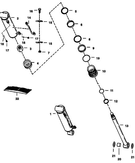

I hope this one will work again when i mount a new seal and o-ring (parts 5 and 6)
This is from a 843, dont know if my 853 has the same cylinder and part numbers. I only have the part list for a 843 and not the one for 853.
you want to change all the seals and orings not just the piston oring and seal , the whole kit should be around $25 -$40 bucks max , put locktite on the new nut they will give you in the kit even though the nut comes pre loaded with locktite in the threads

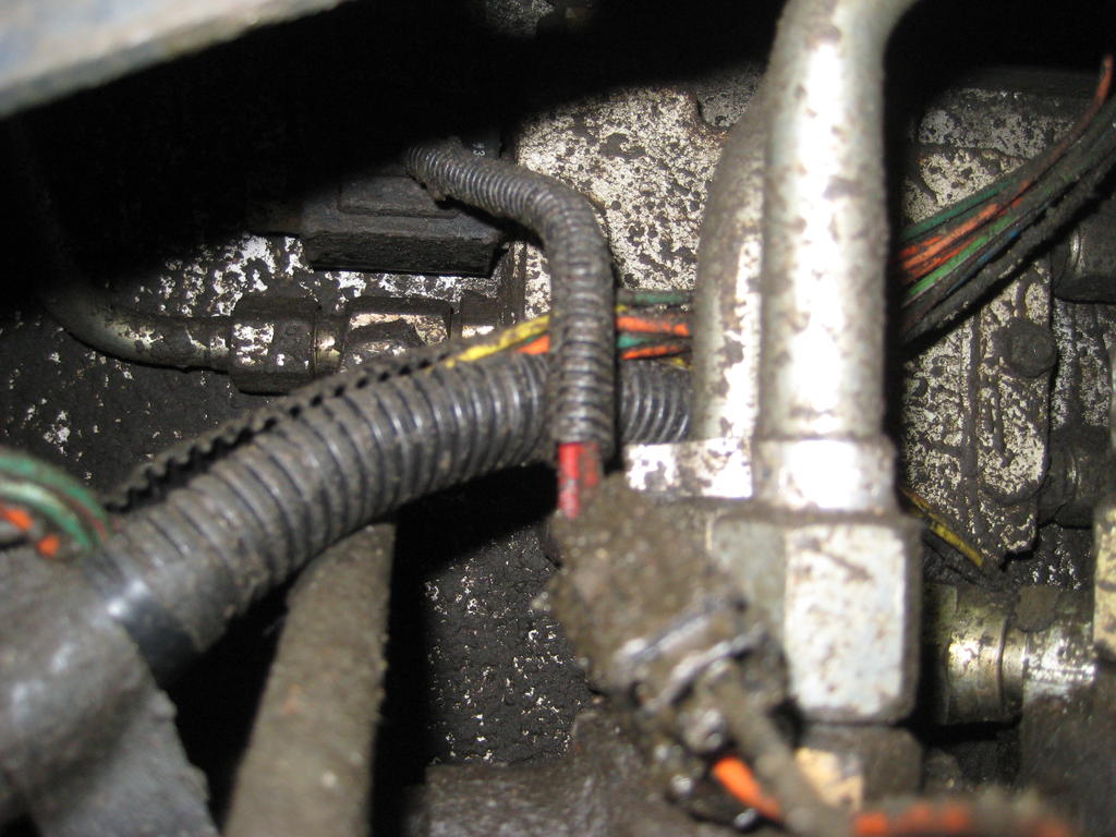

Than i found that selenoid
using the electic and hydraulic schematics i found it is the bucket position valve and has no idea what the selenoid is used for. Later i bought a parts manual and saw there is an optional on/off kit. The switch was broken and the +12V was not connected at all. The coil was ok so mounted a new switch, connected +12V and it works.

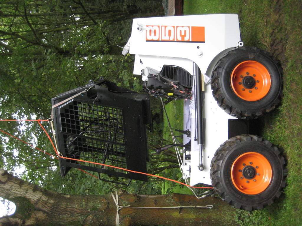

My wokshop is not high enough to mount the cab so used a tree

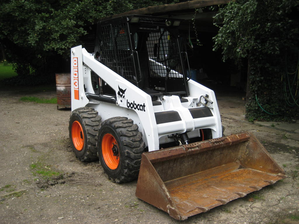

And all mounted
The loader works well, however, there are oil leaks somewhere. Today i cleaned the remaining dirt inside the loader using a power washer, will try to find the leaks next week but it seems to be i have to pull the engine. May be the hydrostatic control block or the punps connected to it.

And all mounted
